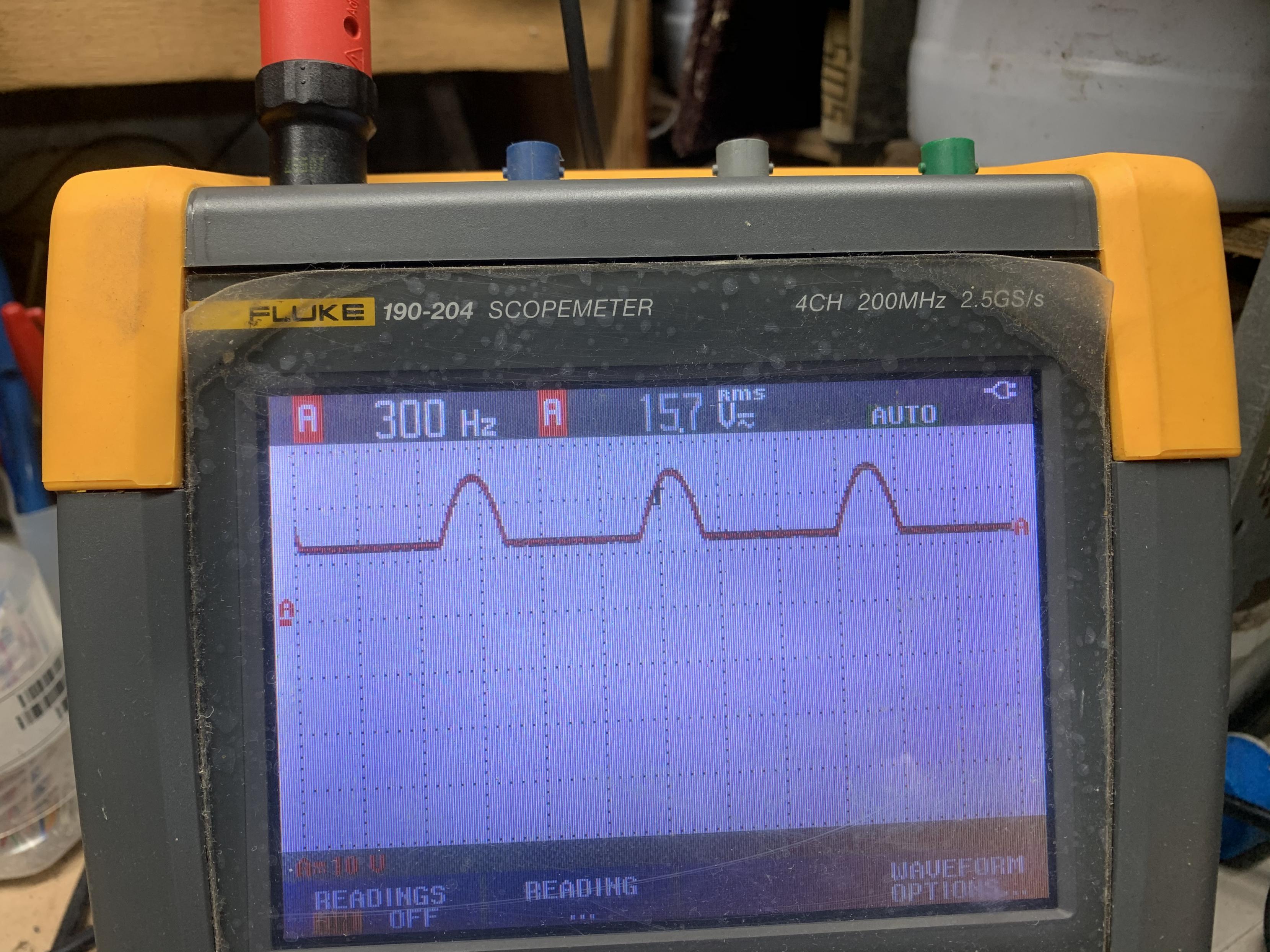

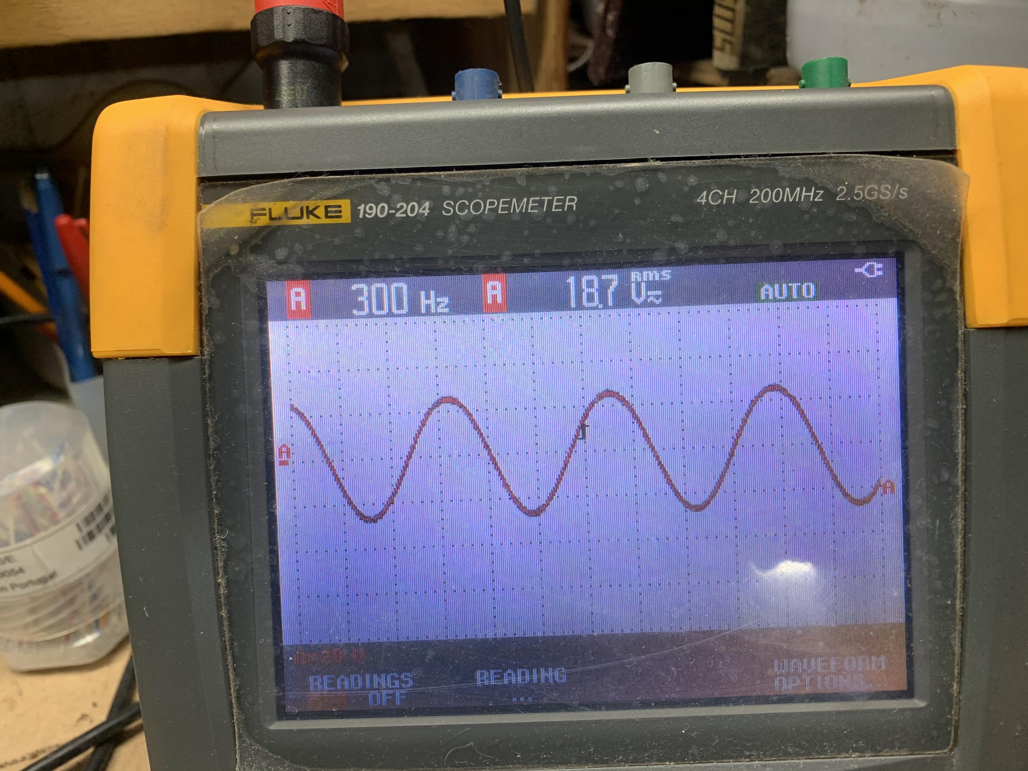

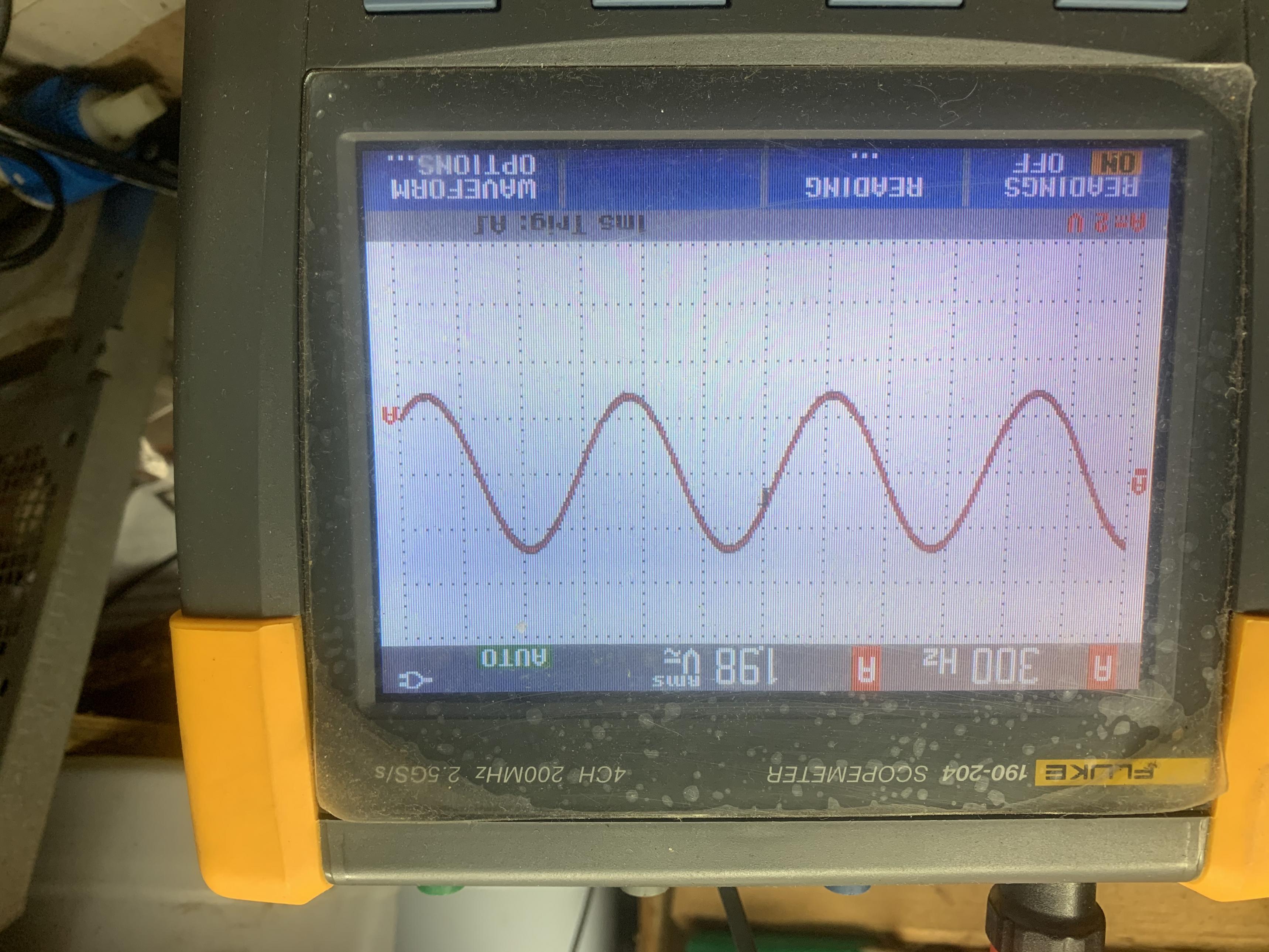

I checked the feedback components as suggested, all three are within tolerance, I replaced the cap with a new as a precaution. The amp still has a higher gain on the left channel. I checked waveforms vs the right channel and the only thing different I’m seeing are the waveforms on the emitter (first pic) collector (second pic). Seems to be a half regulated wave. I replaced Q216 But it didn’t go away. The amp passes clean wave though (pic three). I think Q216 is associated with the protection circuitry, but its being fed from the output. Any other suggestions to get the gains matched/close?

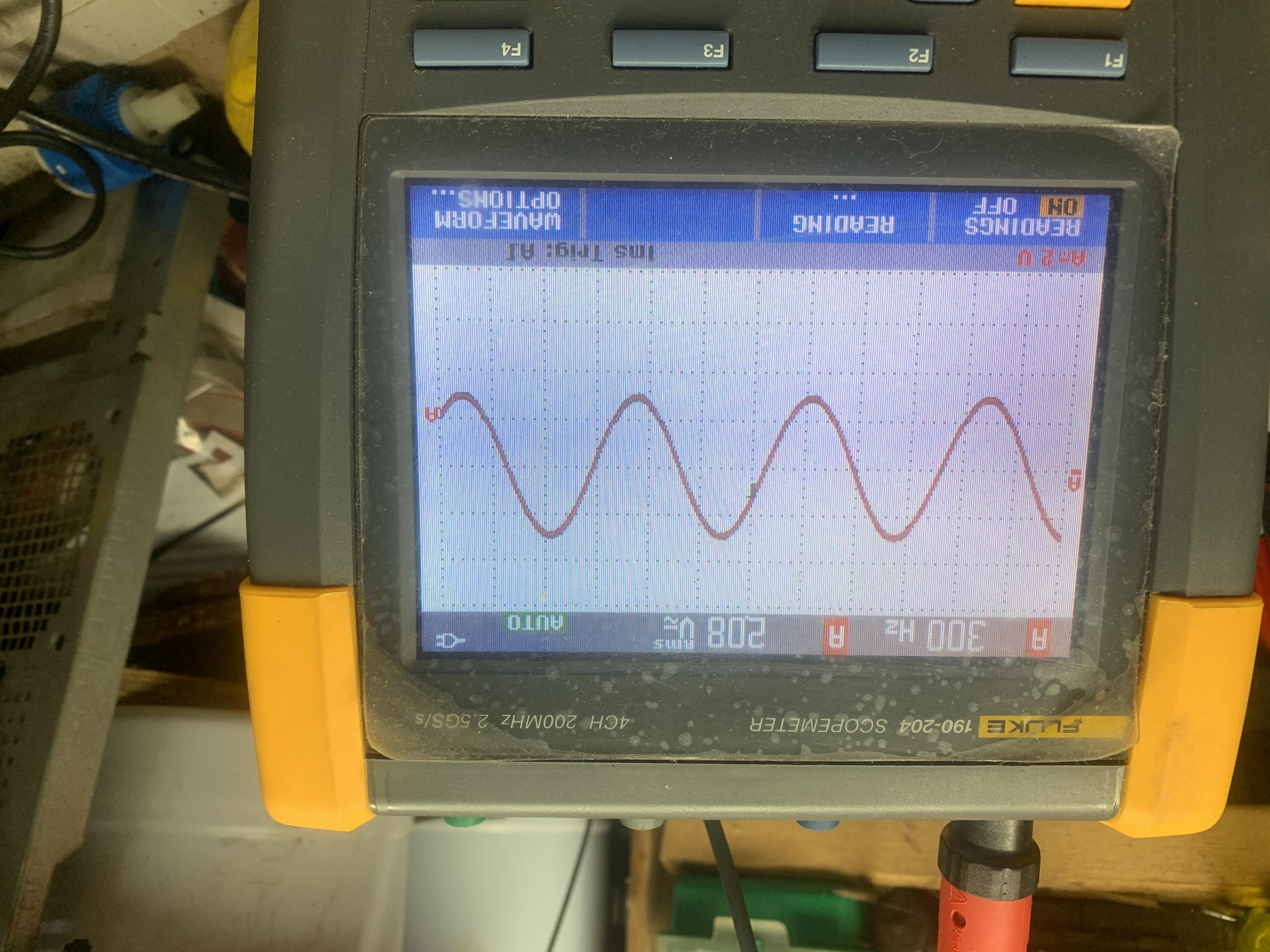

The first pic is the base of q202 and the second is the base of 204. The signals are more or less the same here.

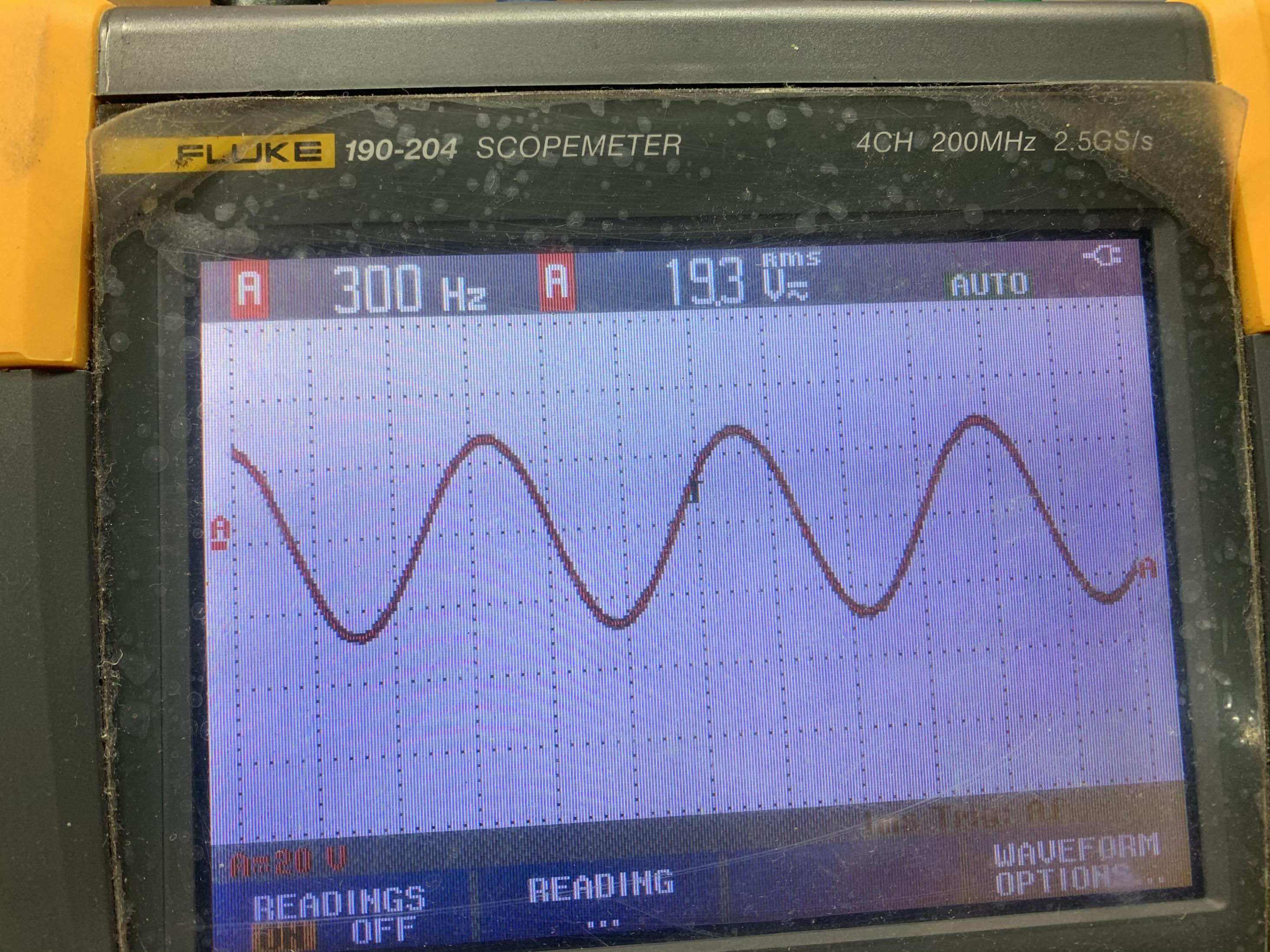

The signal moves onto q205 and 206, At the bases I get rail voltages, there are ceramic caps across the base of q205 and q208.
On the cap (side connected to base of q208) I get a signal of 19.2v rms on the other side of the cap (side connected to collector of q205) I get straight rail voltage.
The same for q206 and q209, but negative rail voltage.
This has me stumped. The pcb is mirrored I looked again at the components and the orientation and connections.
I scoped the right side and the the signals are the same but at a lower amplitude (4.26v rms) with the same 700mV signal being inputted on both channels.
