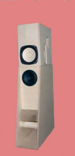

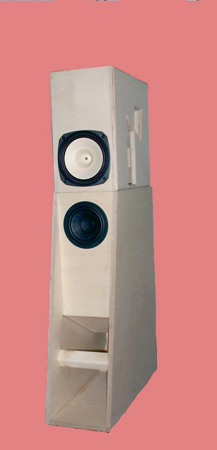

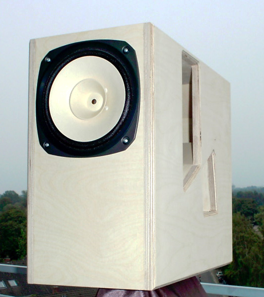

Hello my best experience with the Fostex
is my satellit Horn SCHALMEI
Schalmei-Sat
