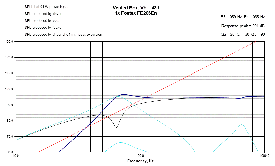

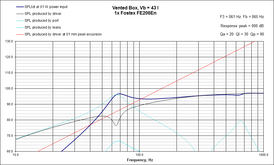

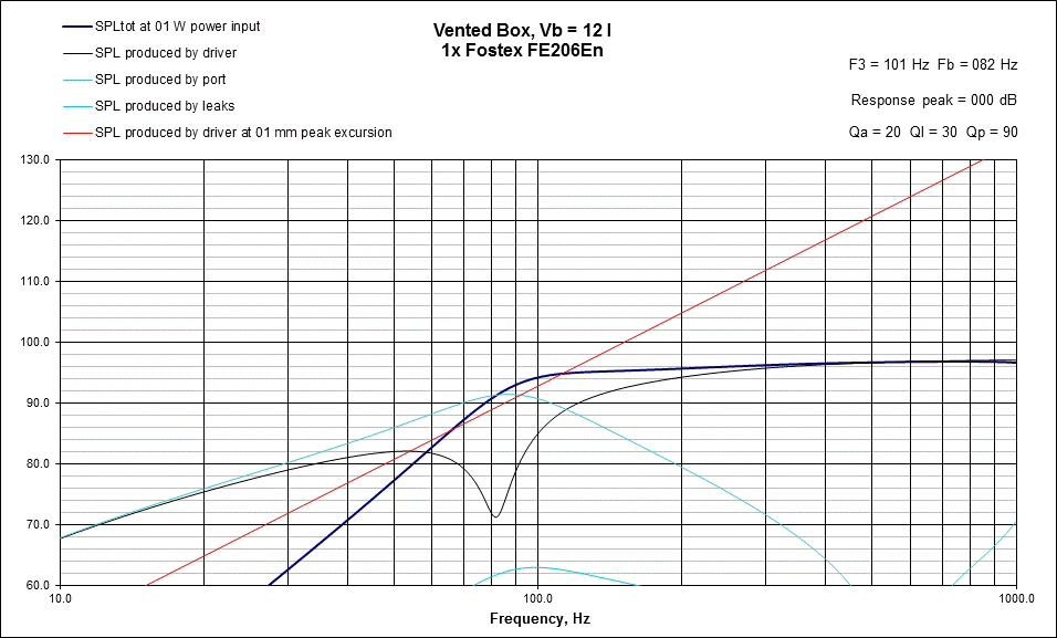

Reading all of the above said, coupled with my experience with Fostex Fe206 e in ML TL and all other speakers that I've tried, I believe that in this case the best solution is a sort of a FAST: 8" woofer (suitable wideranger) in ML TL + a 3" or eventually 4" fullranger of chioce in a small sealed box sitting on top of ML TL one. 300-400 hz 1st order crossover and voila! You can have the best of both worlds + a happy wife 🙂 just my 2 c. Vix

edit: does it have to be a mltl? could it be a ported 8" wide bander?
You mean could the woofer cabinet be a BR instead of MLTL? Definitely. If the wideband is sitting on top, personally, I'd probably just make it a BR so it doesn't get unreasonably tall. An MLTL can be potentially higher-performing (but it needs simulation to be so) but sometimes either you don't need to squeeze the last ounce of performance, and / or you want to build to a given height / width / depth (i.e. a squat cabinet that is also a speaker stand).
There are tons of awesome woofers to choose from. Having a separate top and bottom cab (i.e., you can physically align the driver's centers) may enable you to try a simple two-part series crossover which is the ultimate dummy / purist crossover. (A cheap active crossover is also tons of fun -- why not have both at some point.)

P.S. If you intend a simple first-order (one cap, one coil) series crossover, the impedance of the wideband and woofer should be really close, in my limited experience.

right now im really leaning towards the fostex 83en, 85wk or the more expensive visaton b80.
The FF85WK is an excellent candidate for what has been described in the other thread as a FAST - we've done several - and as was noted there, if you decide on specific drivers and don't need to play around with the XO, then a simple PLLXO and 2 power amps with level controls are all you need.

Not really. My best series XO FAST so far had 4 ohm nominal woofers, 8 ohm nominal mid-tweet. More important to get the sensitivities right, 4 ohm on the bottom means a coil half the size of an 8 ohm load.
