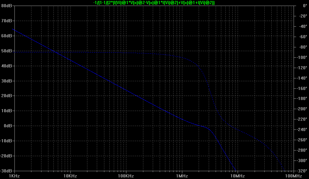

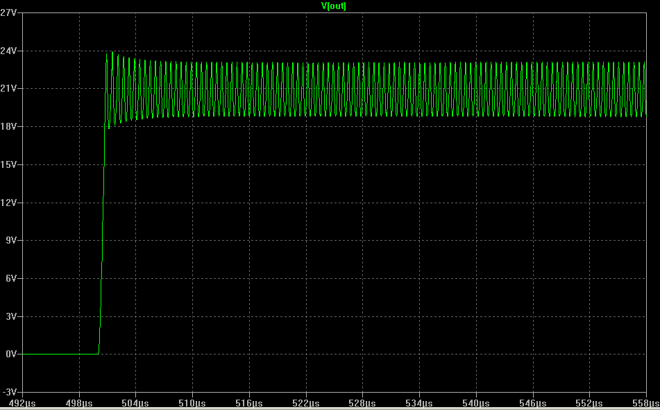

Whats wrong here? The loopgain plot shows a 60 degree phase margin but the step response oscilates. Which do you believe? (or have I done something wrong, is my cct. alright, or are the transisors I used bad?) Thanks again for your responses.
Hi
In first circuit Q8 (VBE multiplier) should be NPN, and not PNP.
Remove C1.
In the second circuit, to simulate Middlebrook Vin (Q1), must be connected directly to GND.
Remove C1.

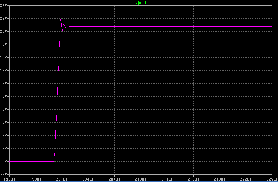

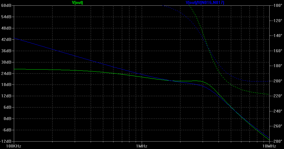

Thanks Rafael, switched npn for pnp, no diffrence, then realized I changed the LTP degeneration from 100 ohms to 33. Changed back and everythings better. Never new these Rs could effect stability so much, then remembered someone mentioning increaseing the LTP bias current affects stability, These Rs shoudnt affect the bias current but both current and these Re's affect the LTP Gm. Does this make sense? Learned alot today!

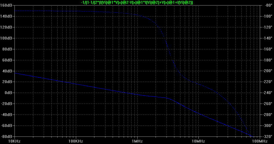

Heres the new plots.
So again the only plot that shows stability is the loopgain, now with around a 90 degree phase margin, (a huge diffrnce). Heres the step response which shows a little overshoot, presume thats alright.

Yes, reduces the gain, plus increases in frequency response in open-loop. Which can increase the feedback negative for high frequencies, look plotcbdb said:other then losing a few db of open loop gain
Put your graphics from 10Hz, are difficult to understand beginning with high frequencies
There was very little change (if any) in open loop bandwidth. The chage in LTP Re's moves the second pole to a higher F increasing phase margin, but open loop BW is dominated by the first pole caused by Cdom (the Miller cap on the VAS) which hasnt changed. (a question: I though the second pole was usually caused by the large output caps, not the input stage?)
