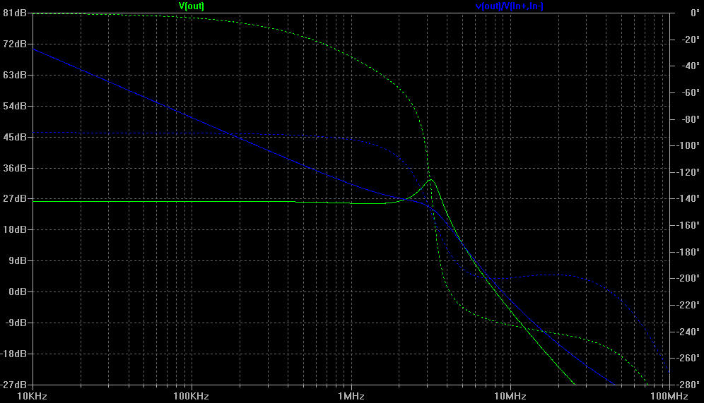

The 3 bode plot techniques are the same, phase margin at unity gain, but people use different plots. The only one that works properly is the loopgain plot. (this one takes the fedback into account). This uses the Middlebrook probe method JC has discribed in the Spice thread starting on post 864.
I have simmed these different Bode plots of a Blameless amp and got very different phase margins, has any one else tried this? I am I doing somethig wrong?

Your are essentially correct in your descriptions; the correct stability analysis method is the loop gain phase margin at unity gain.
Post a schematic of your attempt to determine the loop gain phase margin and somebody will guide you through the LTspice specific process.

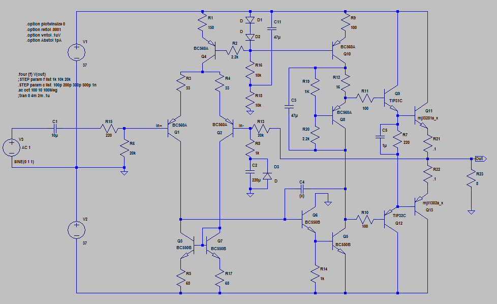

My mistake, appoligies and thanks again Andy C. I would like to post some of my LTspice circuits and bode plots but I am not sure how to do this. (If spice was running on my MAC it would already be done). Could someone please show me the easiest way to make jpegs of these?

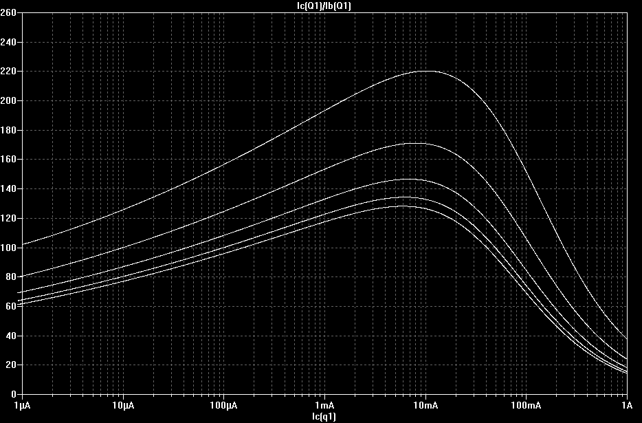

The HFE is fixed in spice
This is not correct. Spice adjusts the transistor HFE (Beta) for different collector currents and temperatures. Run a sim with a current source feeding the base of a transistor with a fixed voltage across the C-E. Then sweep the source and step the temp. and plot Ic/Iq you will see HFE curves (one for each temp step) that should look like the data sheets.
.step temp, does not work in ac analysis
Sorry your right, I was stepping Vce and getting different curves, but there is a way to change temp, but getting of topic

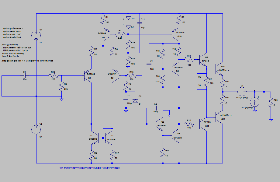

To learn this stuff I have been playing with a blameless cct. Here's what I have done with a blameless, and my limited model library. The only plot that shows its stable is the loopgain. Am I on the right track?
Heres my cct.
