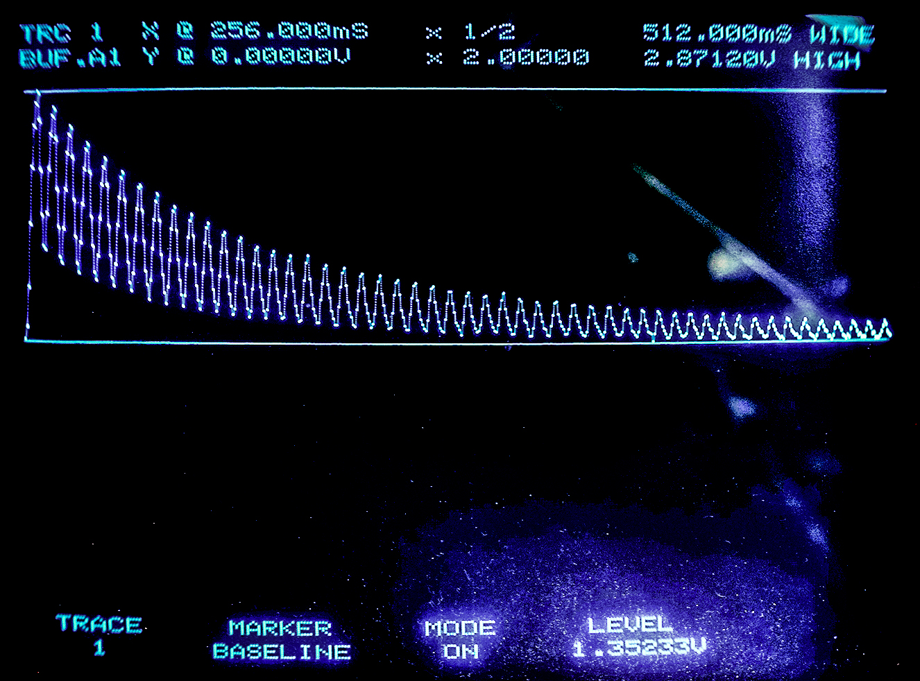

When everything is ok I try to catch the turn on spike with my scope.

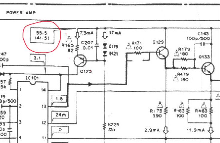

From a Pioneer manual:
22.000 µF per rail for stereo. Rail voltage 55.5V at no signal, 41.5V at rated power.
