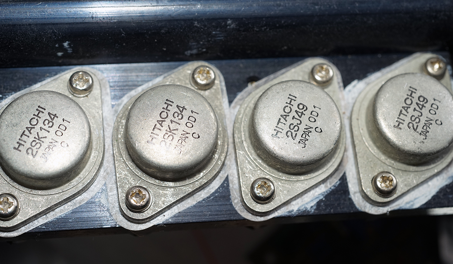

My k135 hitachi which i bought at a reputable company a few decades ago have code 3a1. But that could be another date? Code. They are individually packed in a pink plastic. Maybe my supplier got a box with the code you are looking for.

I guess the middle letters correspond with classes of gs voltages.
But the numbers, do they have any meaning ?

I feel a separate thread in the Parts section might be more appropriate to address this, but - AFAIK - those 3 numbers / letters is just the standard Hitachi date code:I guess the middle letters correspond with classes of gs voltages.
Last digit of the year | Month code | Week of the month
The month codes are: A = Jan, B = Feb, ..., H = Aug, then I is skipped, so J = Sep, ..., M = Dec.
Hence, 3a1 would be the 1st week of January 19x3.
For what it's worth, none of my vintage Hitachi data books mentions any grading / ranking for the 2SJ47-50 / 2SK132-5 parts...
There is no classification within the 2SK135 part number. Are decent nontoroidal transformers hardly available these days?

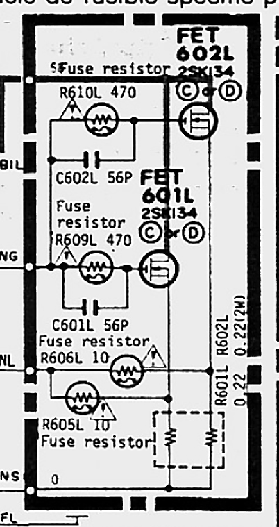

In the input stage all transistors have notes, for example there is a 2SA1015 and the note is GR, same designation: GR in a circle.
Hitachi 8500mkii service manual

Toshiba data sheets do indeed list grading codes (O, Y, GR) for 2SA1015 (and many other of their transistors).
Hitachi data sheets also list grading codes for many parts, e.g. D, E or F for 2SA872 / 2SC1775, but those are printed as extra letters on the packages - they are not part of the 3-letter date code.
I'm not disputing that graded 2SJ50 / 2SK135 existed (perhaps sold exclusively as pre-sorted replacement parts for specific products?), all I'm saying is that none of the data books I have (1978+) lists grading codes for these, and that the 3-letter code is just a date code...

Which proves my claim that the grading is not part of the date code. 😉
As to the actual characteristic denoted by the grade - you're more likely to get answers in the Parts section. I would like to help you, but like I said - none of my vintage Hitachi data books mention any grading for 2SJ47-50 / 2SK132-5...
