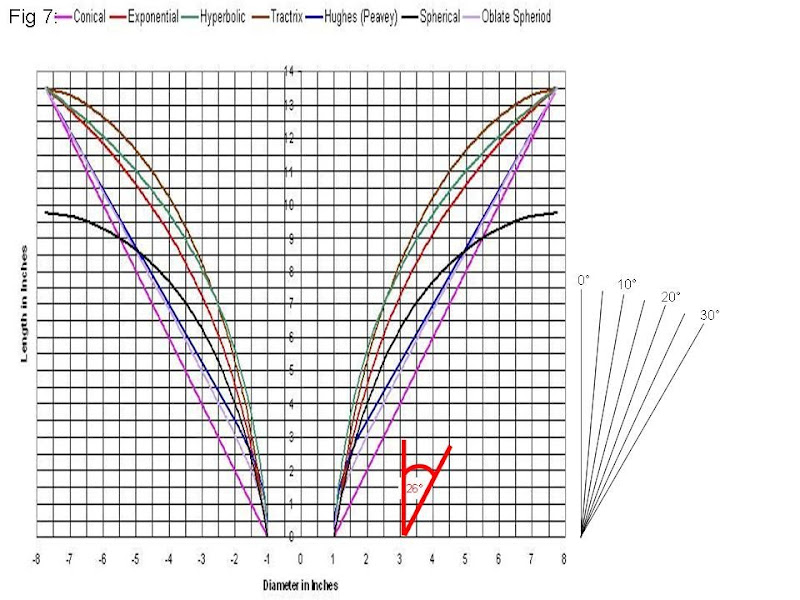

Why go to all the trouble?
In the pic above, you can see the two curves are virtually identical once you get past the throat.
To mod the SH-50, you would do the same thing I did, but just use A LOT more of it. Basically line the first three inches of the throat, smoothing out any discontinuity between the exit of the BMS compression driver and the throat of the Synergy Horn.

From my rough calculations you should get the best results if you join the conical inner section, (just after the midrange ports), to a circular arc that meets both the baffle and the inner flare at right angles.
rcw.
That would be a lot of work, unfortunately. I guess you *could* use a whole lot of clay?
I would expect that a significant reduction in HOMs would be found by smoothing the transition from the exit of the compression driver to the conical horn. If you don't do this, there's an abrupt change in directivity. Basically I would prefer to see a gradual increase in the coverage angle, from about six degrees at the compression driver's exit to 25 degrees about four inches forward of the exit.
These changes would also improve the polar response.
It's certainly not the most time-effective tweak, but it's inexpensive and measurably better. Possibly overkill for a commercial venue, but for the home, it would be worthwhile.
You could also modify the ports to some degree; the port shape affects the midrange response.

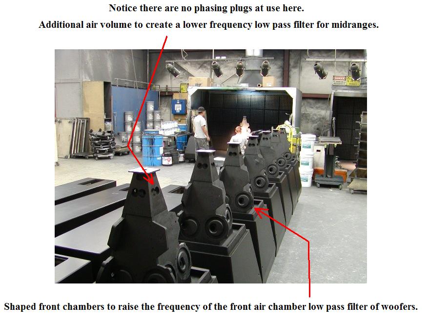

You guys are putting way too much into the midrange port diffraction effects. If you read the Synergy horn patent application you will see the way Tom eliminates that problem. One of the key features of the Synergy over that of the Unity is it specifically calls out where and how to place the midrange entry ports.
1.) The distance between the compression driver’s and midrange’s acoustic centers is between ¼ and ½ wavelength. The highest frequency played by the midranges is below that of the first acoustic null caused by the low pass function of the midrange entry port.
2.) The entry point of the midrange is such that the circumference of the horn at the midrange entry point is 1 wavelength of the crossover point between the compression driver and midranges.
What this means is by the time the output of the compression driver reaches the midrange ports, it is so attenuated by the crossover that the wavelengths in play can’t be affected by the midrange ports. It is a seamless handoff between midrange and compression driver and everything is phase coherent.
Rgs, JLH
Rgs, JLH

Everything is relative. You must look at the length of the waves we are talking about. Let’s look at an example where the midranges cover up to 1.5KHz. This is a very common crossover point for a Unity or Synergy horn.
A 1.5KHz wave is approximately 9 inches in length. To get cancellation you need a reflective surface that is 4.5 inches away from the cone. Now take a look at the shape and size of any of the midrange drivers used in a Unity or Synergy horn. The depth of the cone from the basket edge to the deepest point is well under 4.5 inches. In fact it is at most 2.5 inches. Due to the fact our distance is significantly shorter than the half wavelength cancellation distance, no phasing plug is required. The extra machining seen where the midranges mount is to contour the low pass filter of the front air chamber compliance. (SEE ATTACHED PICTURE OF SH-25)
Additionally, if the crossover is made correctly the midrange ports will not significantly contribute to HOMs. In the Synergy horn the midrange ports are located along the horn where the crossover frequency of the compression driver is equal to or shorter than the circumference of the horn at the midrange entry point. Once you get near this physical point in the horn, the compression driver’s output wavelengths are too acoustically small to be significantly affected by the midrange ports. The horn has become too acoustically large to have any loading or much effect on the compression driver’s output. Near the midrange ports the compression driver’s output does not “see” the horn anymore. The compression driver’s output is beaming out at the angle set by the throat region of the horn.
Rgs, JLH
Rgs, JLH
Thank you so much for the in-depth explanation! I find it really useful!
If I understood well, your second paragraph explains why the midrange drivers need no phase plug. The construction ensures no early reflections between the cone and the hole edges of the exit point. I found this explanation especially useful as it illuminates some of the design choices we where trying to understand a couple of posts earlier.
Your third paragraph argues that the midrange holes will not affect the HF driver output in any way. I already had an intuition about this but your argument actually makes sense of the matter.
What I still don't get is how the ex-centric placement of the midrange holes relative to the horn axis are influential to HOM and other diffraction effects. If I remember correctly I've read Dr. Geddes arguing that even the slightest misalignment between the exit of the CD and the entry of the horn will create HOM. The same is valid for any abrupt change in the horn contour (diffraction slot horns are given as example).
To conclude, what I don't get with this design is if the slots placement in the throat of the horn satisfies the diffraction free design principle I was referring above.
I apologise if I am getting to redundant with these questions 🙂.
