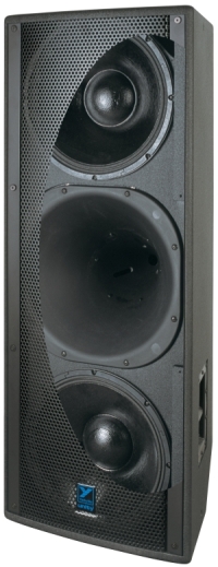

How would a second woofer above the waveguide affect the vertical polar response? D'appolito alignments are said to be beneficial in this case, but i have some doubts about this.
MaVo said:How would a second woofer above the waveguide affect the vertical polar response? D'appolito alignments are said to be beneficial in this case, but i have some doubts about this.
Something like this?
(Yorkville U215)
Yes, only that the U215 will probably have a lower crossover point, which should have some influence on the polar response. But thanks for the hint. 🙂
Edit: crossover at 300hz, which is quite different from the summa speakers.

No BMS coax, its a unity loudspeaker licensed from Tomas Danley. It uses three 5 inch midranges around the waveguide throat - which is, according to Dr Geddes, quite the HOM producer.
You're right, the MTM arrangement is done to set the null angles. Of couse, crossover frequency and the positions of the drivers are important, as they determine where the null angles will fall.
Here again, I would use a tweeter with vertical coverage approximately equal to the null angle. The nulls mark the edge of useful coverage. Beyond that, sound quality is poor. Within the null angle, summing is coherent. Outside the null angle, it isn't. Large vertical angles only increase floor and ceiling reflections. So in my opinion, there is no good reason for the tweeter horn to direct energy outside the null angle. As much as possible, radiation at large vertical angles should be reduced.

The U215 is a Unity horn. Whole different animal than a conventional horn.
MaVo said:No BMS coax, its a unity loudspeaker licensed from Tomas Danley. It uses three 5 inch midranges around the waveguide throat - which is, according to Dr Geddes, quite the HOM producer.
