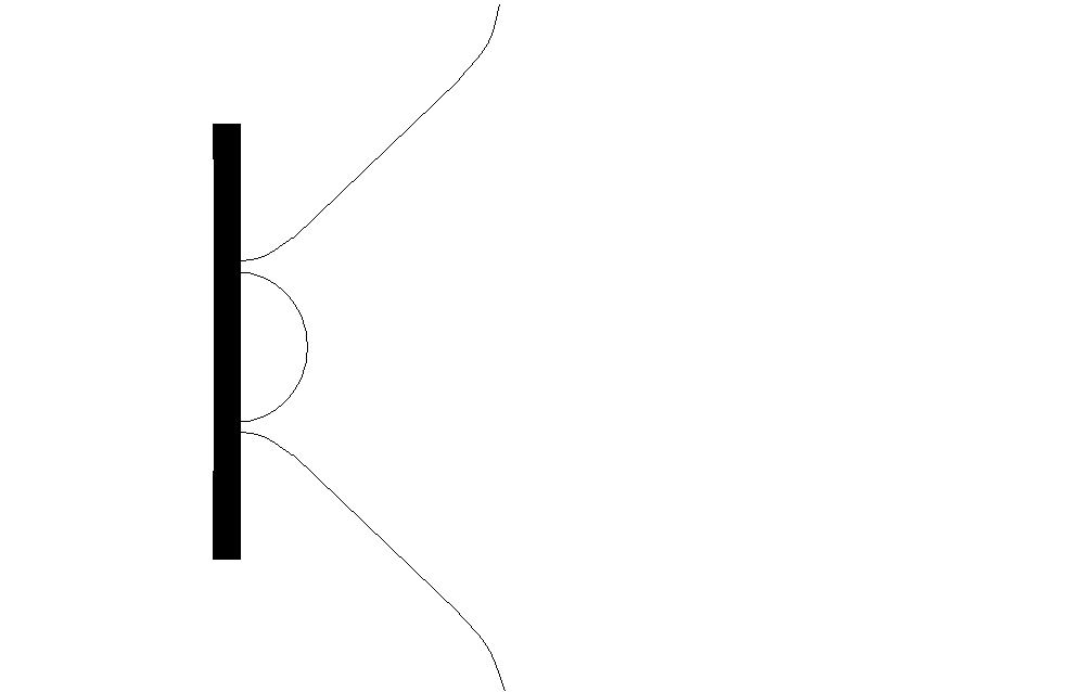

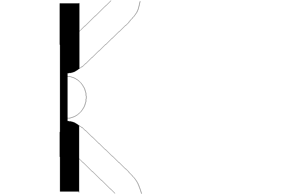

So I could play with a dome tweeter version to see how I like the results, then if I did, I'd go to a compression driver.
For me, the construction is not the hard part, so I can easily spare a few hours to mock up a viable example.
Here's a quick section view. Is this approximately correct?

gedlee said:
A rational comment - how refreshing!!
No actually the long axis is horizontal. Thats where the shorter distance comes from.
I realize that the shorter distance would come about with the long axis horizontal. What I was thinking is that the large axis would provide a more narrow polar response than the narrow axis, and therefore you'd want the long axis vertical to narrow the vertical response.
If the long axis has a wider response, is it due more to the angle of the waveguide?
A point about dome tweeters that Earl made is that various makes of them have domes of different curvatures.
Metal domes are generally too flat for 80-90 degree waveguides, and ideally a transition region to "bend" the wavefront onto a different curvature should be used.
