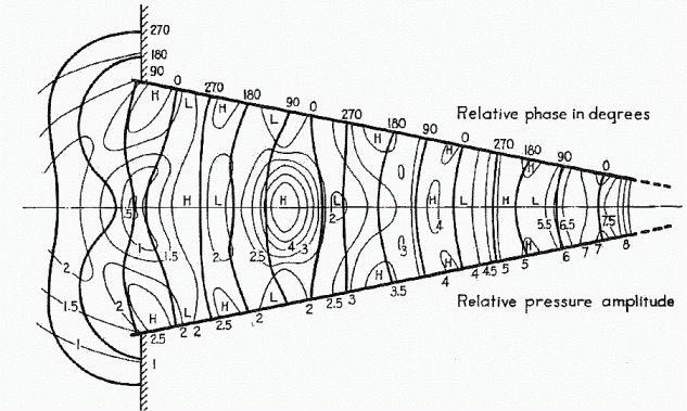

gedlee said:But he really doesn't actually do the waveguide problem since there is no source.
I think the reason for that is that Hoersch was primarily treating the problem of the horn as a receiver (acoustic recording style).
I have never seen this paper referenced before, it is quite obscure.
I've seen it referenced a couple of times, all before 1940, IIRC. After Olson published his book, it seems much of the more detailed horn reasearch from the 1920s and 1930s were forgotten, and plane wave approximations became the norm.
The standing wave patterns are very interesting in how the wavelengths change with radial value.
Yes, an interesting observation. It seems to correlate quite well with the wave patterns measured by W.M. Hall.

rcw said:Scattering is very relevant to the issue, I would refer you to Berners paper on piecewise modeling of horns, and also the work of Benade.
The point is that you cannot translate a plane wave into a spherical one withought scattering, you can look at this as there being no mapping of equal length orthogonal trajectories between a plane wave and a spherical one.
It is usual to consider diffraction as being the square of the scattering amplitude, and this leads us to the correct conclusion that if we put all our scattering at one point, say the junction between a cylinder and a cone, that although the total amount of scattering is the same as we might find in an o.s. waveguide, the amount of diffraction is considerably greater in the former case because to minimize diffraction we must ensure that over the interval in which we accomplish our plane to spherical transition, every point must have the same amount of scattering as every other point, thus the need of the relevant wall curve to have a constant second derivative for minimum diffraction becomes immediately obvious.
If you look at mappings between the wavefront produced by a dome piston and a spherical wave however you can clearly see that the set of trajectories is a lot closer to being of the same length as is true of the former case, i.e. there is a lot less scattering, and also potentially a lot less diffraction.
Thus , (as pointed out by Putland), a waveguide for our plane wave is in fact a straight sided tube because we can draw a set of trajectories that are orthogonal and all of the same length, i.e. the wavefronts are parallel and have the same area, this indicates that no scattering has occurred.
If we take a spherical wave in a cone the same thing of course happens, except that the wavefront gets larger in area as it proceeds down the waveguide.
In the case of our plane to spherical translation we are generating spherical waves that unlike plane waves have a complex impedance
that can store energy in the form of standing waves. These manifest in the form of evanescent waves or given the correct combination of frequency and geometry propagate as higher order modes.
Scattering is a more fundamental process than diffraction because it deals with discrete elastic entities, and we model air as being composed of such, when we consider very large assemblages of these particles we can then look at air as an homogeneous medium in which waves can propagate, but sometimes looking at the more fundamental process is a better aid to understanding and i think it true in this case.
rcw
I have read, and understood, all the works that you quote and none of them have any relavence to this topic. You are using hand waving arguments and big words (like evanescent) framed with a few irrelavent sources and trying to get me to accept your argument. I don't. I'd like to point out that my entire body of work on this subject has been published and peer reviewed, critiqued and criticized and has held up as completely correct in every case. Your description is however completely new, and as far as I can tell incorrect. Scattering is not a term used in any acoustics text that I know of except as usually defined as the energy "scattered" or diffracted off of an object in space. Internal scattering is not an appropriate terminology and as I said apears nowhere in the literature, and I have read virtually all of it.
Hence, either try and make your arguments using the convention terminology using concrete and defined mathematics or please don't continue to offer these handwaving dissertations as they don't make an impact on me.
To be clear: Either the dome coupled to a cone of the same subtended angle (which to my knowledge doesn't actually exist) or a OS waveguide connected to a plane wave compression driver will have HOMs. As I have said before no "real" source can be made constant directivity with some HOM. Now, of all the surfaces that can connect a circular plane wave to a sperical wavefront, the OS can be proven to genetate the least HOM of any other contour, because it is a catenoid and has a minimum 2nd derivative for a given entry angle. The question then becomes does the dome of equal subtended angle as its conical waveguide (assuming we can find one) have more or less HOM to achieve the same spherical wavefront as that obtained with the OS and the compression driver. That question is unresolved and your arguments don't prove a thing either way.
Is this correct?
