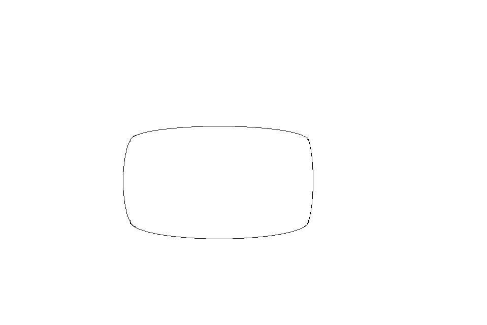

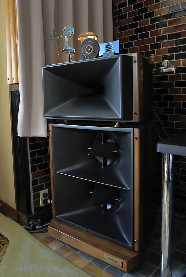

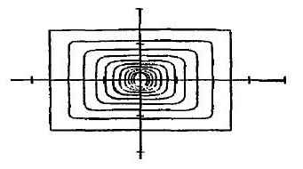

gedlee said:
In general I don't see much advantage to a changing cross-section in the waveguide, certainly not from circular to square. Circular to elliptical I could understand - if done right!!! - but not to square.
Thank You so much! :)
at last this is exactly the kind of answer I always expect from You Dr Geddes :)
the discussion can go on without the invaluable help from Mr Hansen ;)
"from circular to rectangular" (but NOT square) was as I mentioned above the Japanese guys first try (experimental, as they declared) in "Grand Scepter GS-1"

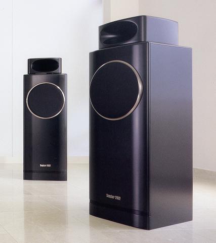

their second try – in "Scepter 2002" (image appended) – was exactly something You pointed to – "from circular to elliptical"
(Japanese comment from www.audio-heritage.jp put through "yahoo babelfish translation"):
Super hyperbolic horn with the technology which was developed the case of GS-1 development, concerning the change of the cross-sectional area adopts the super elliptic function which includes flat function and form function, hyperbolic function, concerning the change of shape by the fact that these simultaneous equations are solved, has become the horn which has the smooth extent which does not have sudden form change.
so it looks they had the right ideas or at least right intuitions?
the question is: did they actually do it right then? Or did anybody ever?
and what is most interesting – what could be the advantage of such design?
as You know the Japanese guys claim was "improved impulse response"
what can be the mechanism behind such an improvement?

I am wondering what improvement they mean? Most irregular impulse shape would probably be due to the throat and it's matching to the driver as Dr. Geddes has mentioned. Looking at the impulse in his papers and the AI site, these two look a bit different which makes me wonder if the AI site has problems with matching the throat with the driver or not. But it would be interesting to see what the Japanese impulse looks like.
