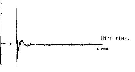

While I understand this phenomena, I have never read anything that correlates prediction and measurement results. Is your paper to ALMA a presentation for or a paper form? I could not find any title on your site that seems related to this. Having looked throught the presentation titled "Sound Quality Improvements in compresson Driver Systems", it is addressed the HOM source could be from the driver itself, but does not address which is more significant, nor is there any way to distinguish between HOMs from guide or HOMs form driver. The frequency plots do indicate that it acts like a filter. This same filter also cuts out detail transients. Whether eq will linearize the effects caused by the foam, there is not data showing that.
Analysis on diaphragm vibration mode indicate that the diaphragm modes are very similare in nature to drum modes. When these modes interact with the compresson driver phase plug, we should be able to see the so called HOMs that coorelate with certain Axial modes of the diaphragm. I have not used compression drivers because this part of the design does not seem mature, but it's under investigation. Improve the diaphragm modes, and you reduce HOMs. I might just consider treating them like direct ratiating diaphragm to reduce the modes.
The paper that you mention is the one that I was talking about. It shows impulse responses with and without foam.
HOMs are different than diaphragm modes. They can be related, but these modes in compression drivers are generally above 10 kHz. The HOMs that I worry about are usually below 10 kHz.
The statement " This same filter also cuts out detail transients. " is not very scientific and exactly the kind of comment that was being discussed. What is a "detail transient". Any transient is the same thing as frequency response - correct one and you correct the other.

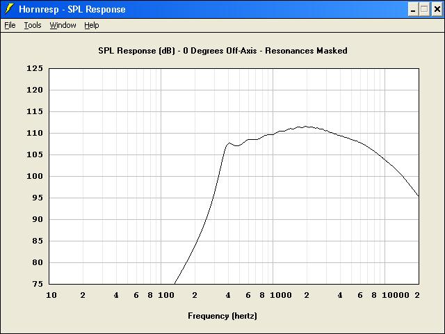

Jmmlc said:
But when using Hornresp and my TD2001 modelisation in which I am very confident, the power response is flat but the on axis response (0°) shows a slowly rising slope followed by a more rapid decreasing slope. I could never reproduce that behavior.
This doesn't sound like very good correlation between real and simulated responses.
Hi Jean-Michel,
Many thanks for the information. I would have thought that the attached on-axis response prediction was reasonably close to the measured response as shown in your Post #922, assuming that the “hole” at 1600 hertz is disregarded.
Am I missing something in the interpretation of your measured results, perhaps?
Kind regards,
David
Ah, on page 38. I did not notice two impulses overlapped. I will try to elaborate on reading the impulse. The part before the main impulse and after will be explained individually.
If we look at the part prior to the main peak, without the foam there are little wriggles, im my measurement experience, the closer these wriggles resemble the reference impulse, the more detail the driver can deliver. I do not know whether there is a mathematical explanation for this, but this is what I find. Notice that with the foam, the little wriggles are not evident anymore if I read the picture correctly. To me, this means reduction in detail.
If we look at the part after the main peak, we can see that the foam has successfully filtered out the high frequency modes. I see these high frequency modes on direct radiating drivers with metal diaphrams as well, and make drivers very unbareable under certain music conditions. The foam does a good job filtering these out. But I'm quite sure these are originating from the compression driver diaphragm.
Now for HOMs below 10KHz, I kind of wonder whether they are induced structurally be radial and bell modes. These modes are similar to cones of drivers. I can see the more shallow the guide/horn is, the more easier they are excited unless the horn/guide is contructed with a well dampped material. Didn't you use some composite material for this purpose?

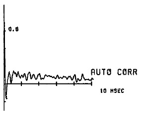

Patrick Bateman said:
Any kind of low-pass filter, be it acoustic or electronic, would be expected to remove the subjective "detail" of a loudspeaker. In other words, if there's no top octave, it won't sound "detailed." Some loudspeakers accentuate the top octave to make the presentation sound unnaturally detailed.
The key is that the foam is a low pass filter, but it's compensated by the crossover. Do you understand that it's a two step process? The two work in hand-in-hand. You can't just stuff a foam plug into any ol' speaker; you have to redesign the xover.
This is one of the reasons that you can't just cram a bunch of polyfill into the waveguide and expect reliable results. The foam is manufactured to exacting specifications, and the consistency of the foam PPI is a must for predictable results.
I think I fully understand this part, but the part that most people don't understand is that acoustic filters distort low lwvel signals differently from electronic signals. Send a 40db 10KHz sine wave through the foam and record before and after the foam to see how they differ in shape.
Auto-correlation would tell you the time arrivals of various parts of the wave, except that it would also be mixed in with the frequency response and any noise in the measurement.
Better would be to use the cross-correaltion of the input with the output as this would then normalize out the frequency response component and ignore the noise, yielding just the time of arrival data. This later techniques is exactly what I do. This result is also called the impulse response.
Hence, its impossible to say much from your data, other than the previous one is more likely to be the better sounding device as the second one rings on in time quite a bit. But the second one could also have a lot of noise in the measurement as this would also show up as an extended time aspect.
I see
here is impulse response measurement of the horn of the "better looking" auto-correlation measurement
what can be said about it? is it good/bad/mediocre?
is it significantly worse than in case of Summa?
best,
graaf
