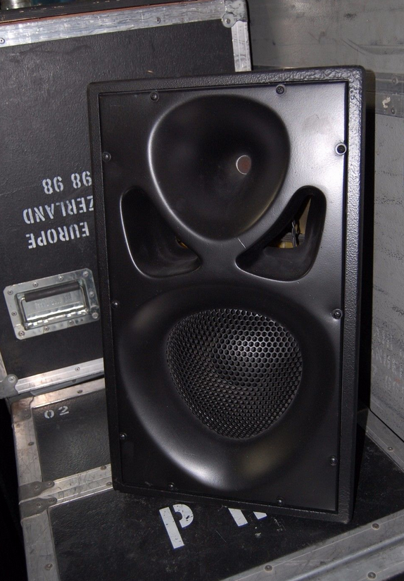

I was looking at some gear on eBay today and noticed that Clair Brothers has a monitor that looks a lot like a Summa now.
Here's a Summa. It's a two way with a B&C compression driver and a 15" woofer.
Here's the Clair P110. It's a two way with a BMS compression driver and a 10" woofer.
Passing resemblance, but the P110 semi-triangular horn does not follow the oblate spheroid expansion pattern, it appears to be continually expanding, which would result in a narrowing HF pattern.I was looking at some gear on eBay today and noticed that Clair Brothers has a monitor that looks a lot like a Summa now.
The HF dispersion pattern probably is consistent with the narrow cabinet wall angles.

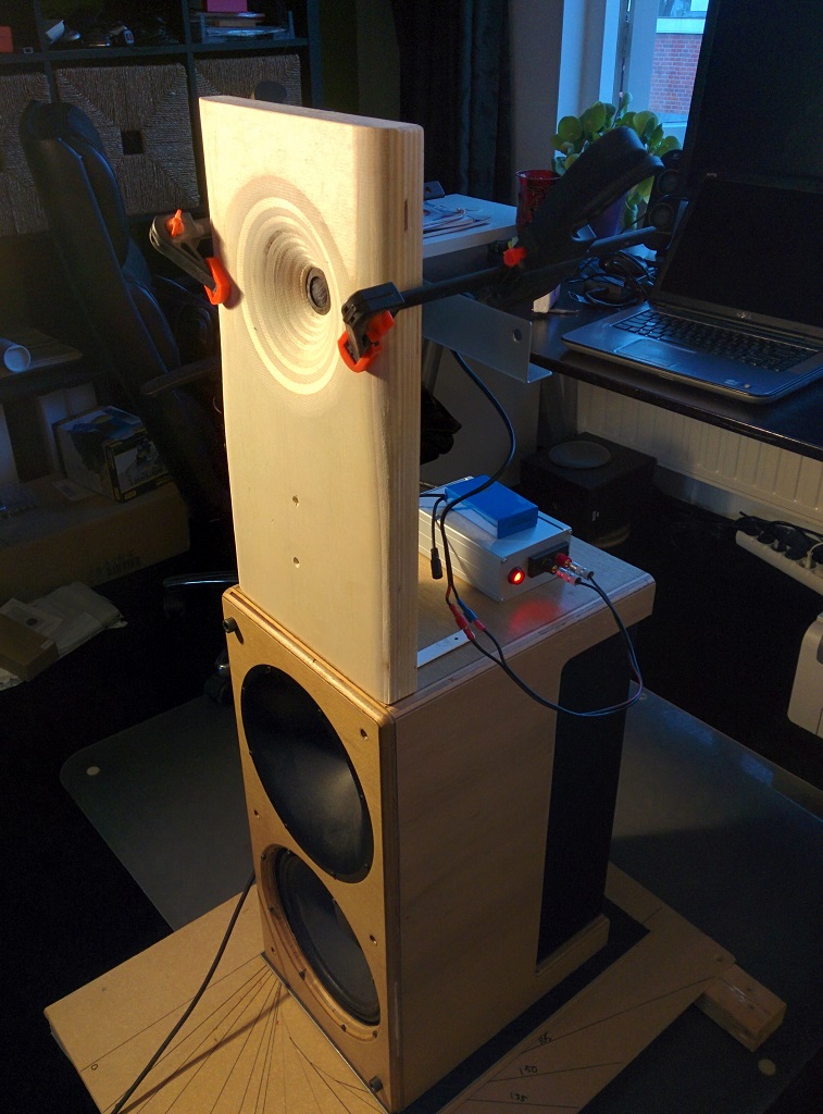

Im looking to build an oblate spheriodal waveguide from plaster. Im trying to make the throat to match the 6degree exit angle of my B&C de250 compression driver. Josh K mentions that he adapted his spreadsheet to include the cd exit angle. Only i can't find this version of the spreadsheet. Would someone be willing to send it to me / post it here?

Thanks for the replies. Im feeling a bit dumb when i look at those lists of equations. Im starting to remember why i quit electrical engineering 😀

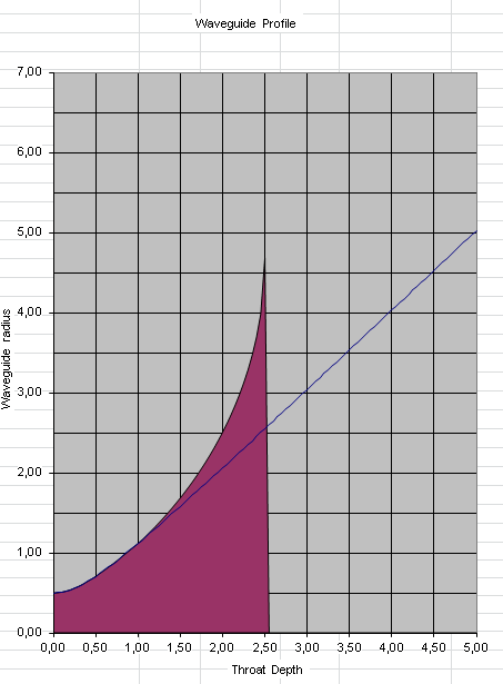

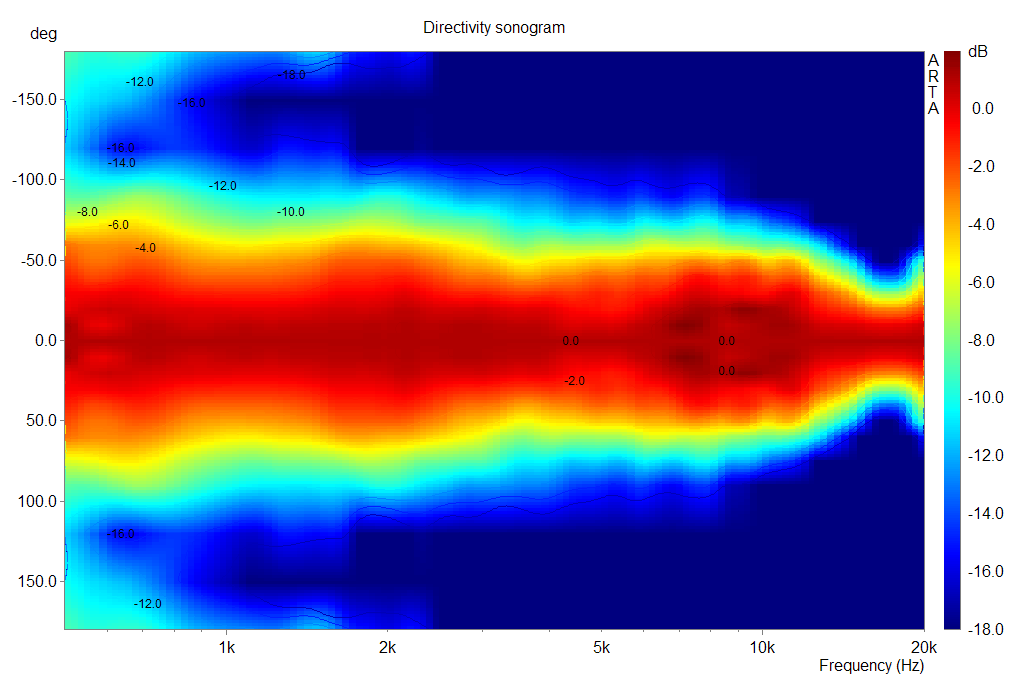

I used the spreadsheet provided by Josh K to make the attached waveguide profile (the enormous exit radius is on purpose). Im trying to mimic a waveguide from a test baffle i did some tests with, which works quite well apart from some diffraction at 10KHz and narrowing above 12KHz. At least the diffraction at 10KHz is probably caused by non-optimal matching between waveguide exit and horn throat, as each iteration of adapter for providing a smooth transition improved the 10KHz behaviour (see attached polar).
So now im looking to improve the accuracy of the throat. The aforementioned spreadsheet by Josh K is perfect in drawing the profile in the right dimensions, only i can't change the cd exit angle. I have one version in which you can enter the exit angle, only it doesn't seem to work. Is there a working version around 🙂 ?

May this can help for calculating OS-WG horn profile:
Ro =driver throat radius
To = driver mouth exit angle
Te =coverage angle (form axis)
Then
ro = Ro*sqrt( 1 - [tan(To)/tan(Te)]^2)
Xo = Ro/tan(Te)*tan(To)/tan(Te)
y(x) = ro*sqrt( 1+ {[(x+Xo)/ro]*tan(Te)}^2), x={0……}
Regards
Ivica

When you set the parameters of the 1st derivative and set the coverage angle as well, the horn profile dimensions will change to meet this criteria.
Alternatively you must design a transition segment that continues the flare of compression driver until a some distant diameter a tangent point is reached with an existing horn profile. Ideally, use a compression driver designed to exit into the apex (at 0°) of the hyperbola that forms an OS horn profile.
Unfortunately - to my knowledge - none of these exist.
Better would be to have the OS flare continue through the phase plug right down to the diaphragm. I had a patent on this at one time - interchangeable phase plugs for different waveguide configurations.

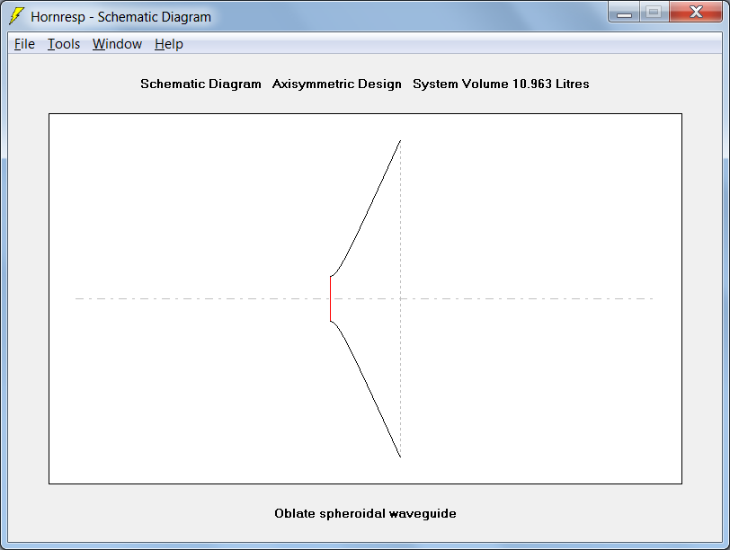

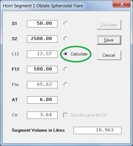

The Hornresp Horn Segment Wizard tool will give you what you want - just select the Calculate option that best suits your needs.
For example...
In Attachment 1:
Specified:
Throat area S1 = 50 cm2
Mouth Area S2 = 2500 cm2
Cutoff frequency F12 = 500 Hz
Throat entry half-angle AT = 6 degrees *
* Change AT to 3 degrees if the "6 degree exit angle" referred to is the total included angle, not the half-angle.
Calculated:
Waveguide axial length L12 = 12.57 cm
Mouth flare tangent angle Fta = 65.62 degrees
Attachment 2 shows the schematic diagram for the specified waveguide. Dimensional data can be exported for construction purposes.

Mouth flare is never part of any horn/waveguide theory, they all deal with devices of infinite extent. The role of the mouth flare is covered in my book. Basically the larger the radius the better, but beyond a certain point it becomes impractical and less effective.
