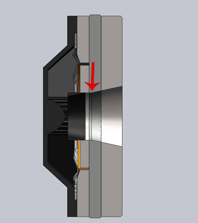

Following your comment on the horn throat and the section in the compression driver from the phase plug that is a reason that I say that the flat pancake drivers are advantageous over the traditional Alnico types of drivers with long throats sections. I agree that the shortest section possible between the end of the driver and the conic section of the horn is important and if the C-bezier curvature can create the shortest section and remain tangent at both ends of the curvature then I'll agree with your position. At the same time the variations of the actual curvature between the different bezier curves is really minor from the paper that you presented earlier.
What about machining the throat of the driver to begin the curve right at the phase plug exit? I'm looking at building new waveguides next year so I thought I'd do more study and modeling over the winter. Looking at my BMS 4552nd they have a fairly short throat with a wide angle: iirc it's about .5" deep with a 24deg angle and the dia at the phase plug exit is about .75". There's enough material there to machine the start of the os curve with a 45deg wall angle.
My only concern is loading on the low end with a shorter length and a more rapid flare at the throat. If it didn't work out I could always bore that section out and have a plug 3d printed to restore the original shape....

Nathan,
One thing you do have to consider is that the throat section is part of the magnetic path and depending on the thickness of that section you could cause a real problem with magnetic saturation in the throat section if it becomes thinner. I don't think many consider that it is part of the return path for the magnetic circuit. I would be more comfortable taking the entire phase plug and throat section out and changing the section with a new metallic part but that is not a simple thing to do. Alignment and assembly is critical and working with charged magnets is not a simple thing to do.
KHman - that's something I've thought about as well but tbh I don't know enough about motor design to have a clue what the effect is. Thanks for pointing that out. I do know that on these BMS cds the phase plug/diaphragm/back chamber is one integral piece so modification of that is out.

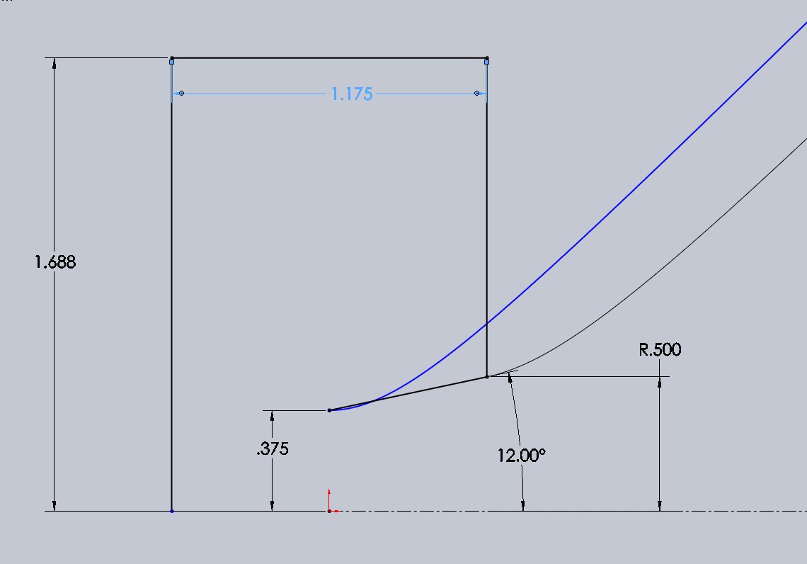

Yeah I would do something to seal the gap before machining. Maybe a flat disc that's glued to the gap side with silicone. Here's a quick sketch of what I was thinking: the blue curve is the OS profile starting at the phase plug exit, and the black curve is my current OS profile starting at the 12° cd exit. My drawing isn't perfect as there's actually a short flat section extending about .150" beyond the phase plug exit so the os profile would fit nicely.

HI natehansen66,
I think that lower frequency loading (under 2kHz) would be bad.

Nathan,
It just seems you would have a major diffraction area where this curvature meets the exit of the phase plug?
As Earl mentioned it would be really difficult to get any metallic dust out of the throat unless you had a magnet that was even more powerful to pull those particles out. I don't know the drivers your talking about but I would look at how they are assembled and consider removing the throat section if possible.

That's kind of what I'm thinking as it opens up pretty fast. I'll run some sims in AxiDriver and see how it looks there.

My drawing is probably pretty poor, but I would think there would be less diffraction with the os starting here rather than an abrupt conical section.
Probably more trouble than it's worth but it'll be something to think about when there's two feet of snow on the ground

The amount of diffraction depends on the 2nd derivative of the bounding slope. For example a straight sided cone has no internal diffraction (which is why, incidentally, it is also a solution under Webster's equation.) The problem is that there is no source for a spherical wave front to drive such a device. So while you may not get HOMs from internal diffraction you will certainly get them from the mismatch of the wave fronts at the entrance to the cone. This calculation is shown in my book as an appendix.
So if in your matching you minimize the second derivative then you will have minimum diffraction. I don't see where there would be any diffraction in the drawing that you showed, but I don't see the two curves as being all that different either. Just different coverage angles that's all.

Yeah, I have some time to think while I'm at work some days. Hopefully these drawings are clear as mud. Basically the 4552nd has 2 conical sections in the throat, and my red arrow is showing a "kink" which is where I would machine the os profile to rather than starting it at the waveguide. The drawings I showed before both had the same coverage angle...maybe that wasn't clear. As it is these are neo cds and have a short throat......the whole assembly is about 1.3" deep. My comment about loading was referring to the cd if it was modified with a very rapidly flaring throat vs as it is stock. I'm currently crossing them at 950hz no problem.

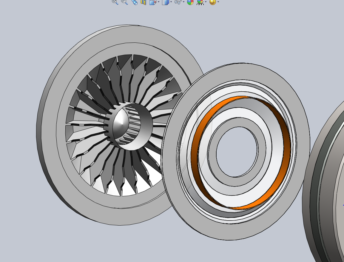

Since the diaphragm and back chamber are a single piece I had to take a bit of artistic license with the phase plug inside the back chamber, but you can clearly see the "vanes" under the diaphragm. The second drawing is an exploded view of the diaphragm and the phase plug/back chamber. Kinda a fun project drawing this thing.

Nate,
In reality I would say the entrance to the phase plug is setting the real load on the diaphragms. If they have followed normal standards the ratio is 10 to 1 diaphragm to slot opening areas. I don't think you will affect the basic loading on the diaphragm as long as you leave the entrance area alone.
