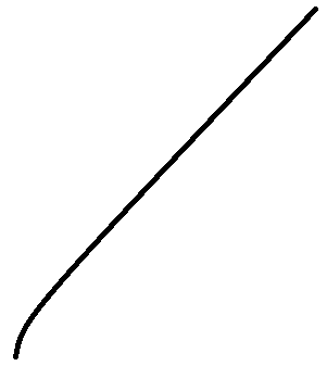

I don't see it that way if the point of the excercise was to get to a cone. Unless the cone fits the room something has to give somewhere. It's been suggested that a LeCleach profile is the epitome of a practical mouth beginning at the throat, but there are other compromises. Put a large enough radius on a cone and the two begin to bear similarities anyway. Pick your poison?Earls shape gives the most smooth response that he could come up with and still it needed the radius at the mouth to function without the diffraction that every other horn has with a sharp termination.
C-Bezier Curve Applied to Horn Design ...
... nothing more!
I discovered the C-Bezier curve while researching a design issue having nothing to do with acoustics. However, it became apparent to me while reading the paper, that it would also be useful in the layout of typical horn profiles where discontinuities in curvature were to be avoided. All I wanted to do is share that information here. Apparently, in this thread, any thing that is different is unwelcome. If someone wants to discuss usage of this curve in horn design, I will be more than happy to respond, otherwise ....
WHG
... nothing more!
WHG
WHG,
Earl did nothing different than I was doing in 1975, sorry but we came to very similar conclusions ...
Steve, you keep saying this, but without any support. I can show a consistent paper trail leading to my designs, but you don't seem to have anything to show except your claim. What were you doing in 1975 that was involved with horns?

C-Bezier Curve
Earl,
Apparently this curve was formally introduced in the attached paper.
Bill
Earl,
Bill
I do know that in my drafting package I can exactly match an OS contour with a three point Bezier. Doesn't get much simpler than that.
CAD Packege?
Name? Version?
WHG

WHG,
I still think your blowing the curvature of this short section way out of proportion to the final results. If you have played with something like a typical hyperbolic curvature in a horn and looked at how that changes the final result you will see that slight changes in curvature don't change anything more than slightly. You are trying to make a smooth transition from one angle to another with tangent angles at both ends and the shortest transition zone as possible if you are after the most constant directivity possible, if that is your end goal.
The C-bezier curve is interesting for other transitions such as between multiple intermediate curves but I don't see it being as important in the transition zone between two purely conic sections. There is more diffraction inside the compression driver at the joints of the phasing plug and the throat section than anywhere else in the rest of the horn section. This is where the real improvements could be made but since nobody is building diy compression drivers I think you are making a mountain out of a mole hill here.
