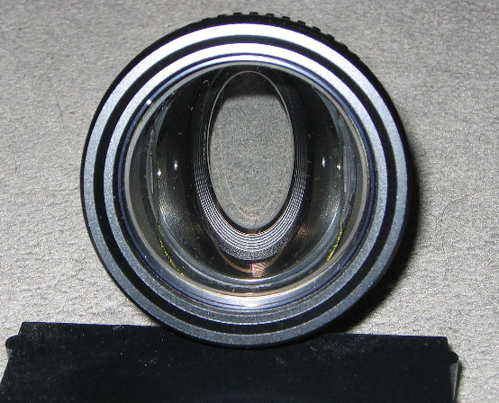

I found this image of an anamorphic lens designed to project a widescreen image from a distorted version recorded on a standard narrow format film. It would seem that things are different though maybe because it is many thousands of wavelengths across and where acoustic waveguides are comparable to a single wavelength.
