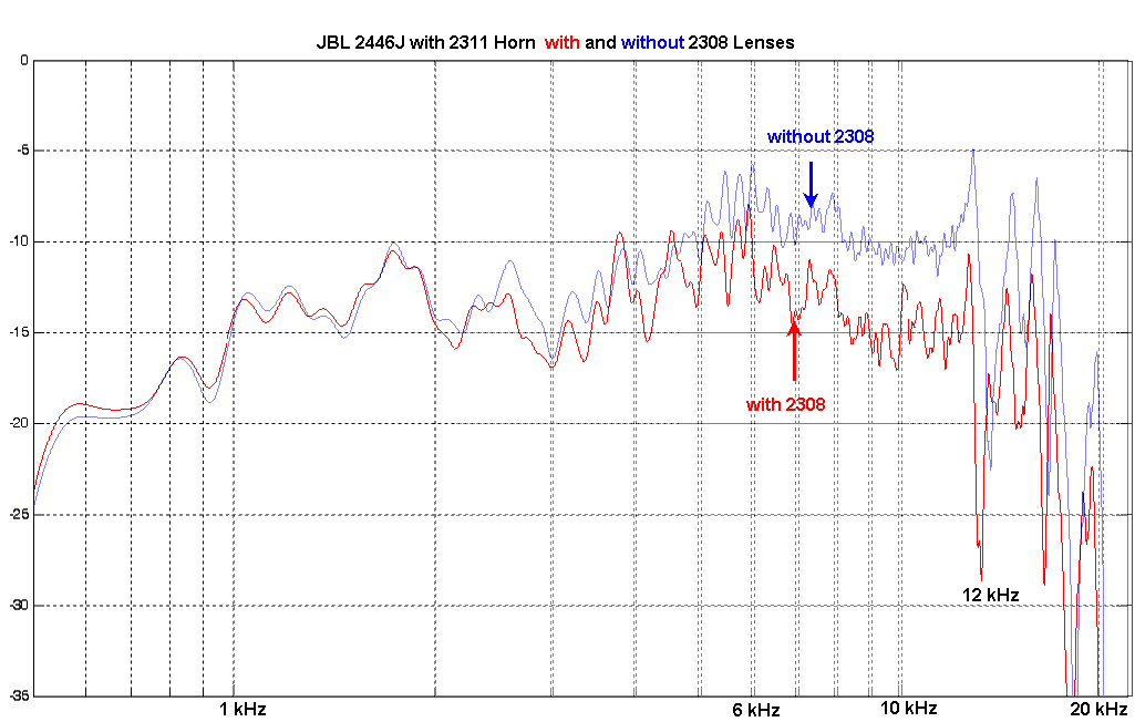

Some measurements 2446 with 2311 with and without 2308 lenses
Hi POS,
It would be , for me , more interesting if measurements can be done with PT-H95HF horn, but.....
I would expect that LF loading (under 2kHz) for D2430K would be better, but have no idea about HF response, may be a kind of HF cancellation can be get, and so no so good HF response would be.
regards
ivica

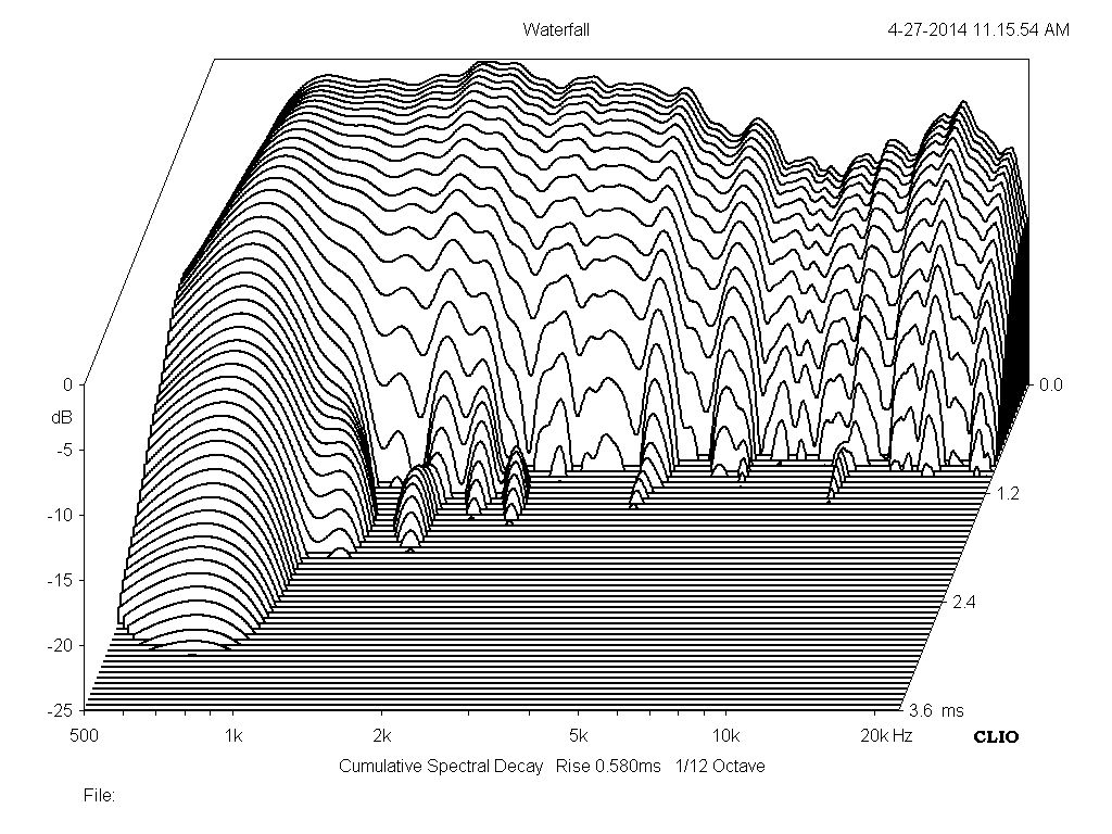

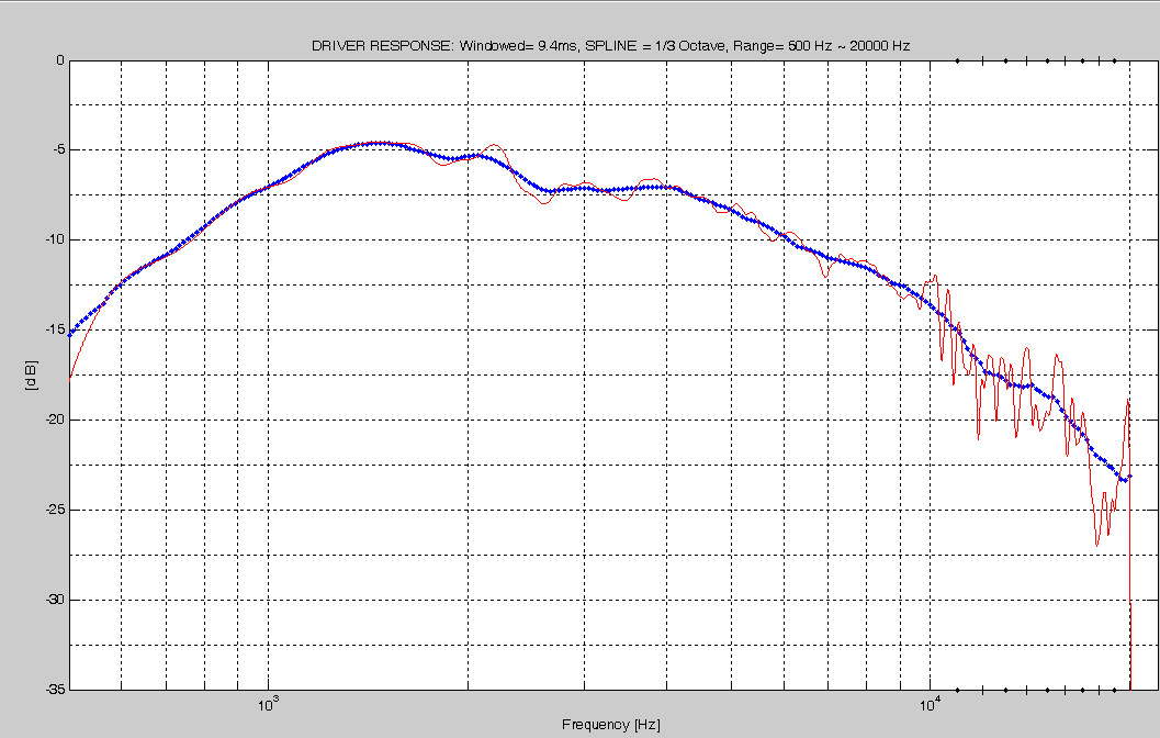

some measurements 2450SL driver with PT-H95HF horn

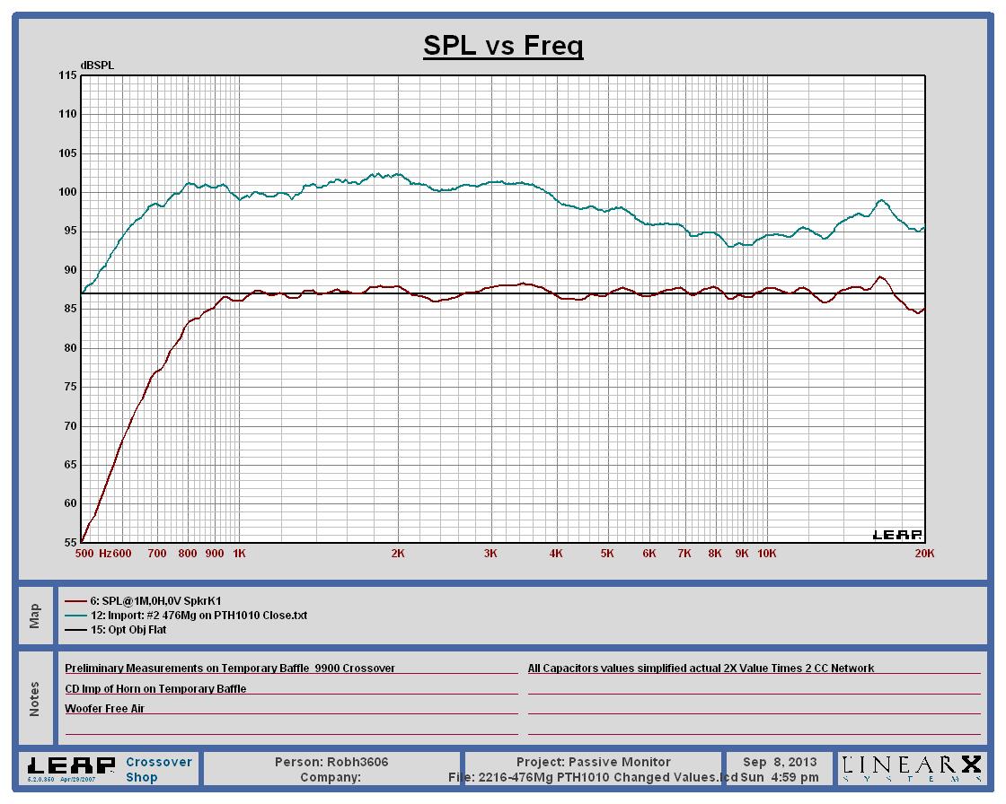

Hello Kindhornman
Take a look at this, it's a JBL 476Mg on a 100x100 waveguide raw and with a simulated network. Looks real promissing can't wait to actually hear what it sounds like.
Rob🙂
It would be nice to see a compression driver with extended high frequency response and a smooth frequency response across the entire useable response range. I know some don't think it worth the effort to get a compression driver to have response above 16Khz but I am not in that camp. Most drivers start rolling down at about 13Khz and are done by 16Khz with plenty of perturbations. You will see efforts on compression drivers for years to come.
