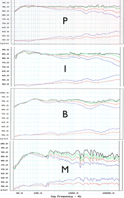

@David
Sean Olive seems to often mention the power respons as one of the most important factor of speakers. I assume he isn't taking that out of anything, but that it correlates with Harman's blindtests. Let's also remember that those tests are done in a room with a lot of treatment. I have heard however that they remove some of the sidewall treatment in their testings, in order to differentiate the off-axis response more clearly.
Source: Audio Musings by Sean Olive: Part 3 - Relationship between Loudspeaker Measurements and Listener PreferencesBoth trained and untrained listeners clearly preferred the loudspeakers with the flattest, smoothest and most extended frequency response curves, as exhibited in the measurements of loudspeakers P and I. Loudspeaker B was rated lower due to its less extended, bumpy bass, and a large hole centered at 3 kHz in its sound power curve. The measurements of Loudspeaker M indicate it has a lack of low bass, and has a non-smooth frequency response in all of its measured curves. Both the direct and reflected sounds produced by this loudspeaker will contribute serious colorations to the timbre of reproduced sounds.

Who said it was more than "secondary"? Did you not read what I said? I clearly said that it was a "secondary" aspect, but it is not irrelevant. That has never been shown. Even in the Lipshitz, Vanderkooy study they do not conclude that it is irrelevant.
We went through all this already. I don't see the point in mis-stating what I said to try and recreate the argument. Dave, that is beneath you.

What Dave is saying that the smoothness of the off-axis response, especially near the listening axis, is important. But any particular shape of the power response is not shown to be preferred. The Olive quote and results agree with this. Smoothness is important, but constant directivity does not correlate with preference.
Out of the 4 speakers Olive is showing, the top two both have rising directivities.

@David
The unit B that he refers to doesn't really illustrate that point. It has an axial response hole at 3kHz that persists off axis, so yes there is a power response hole but only in conjunction with poorer on axis response (and lumpy bass).
In fact the directivity index curve (blue curve below) is no better or worse than the d.i. of the better ranked L above it. Axial response alone would have predicted the rank order of the 4 speakers.
While we are looking at them, look at how good the directivity index curves of the worst ranked speaker M is. The red hemispheric curve is dead flat: constant directivity. why is it 4th ranked?
