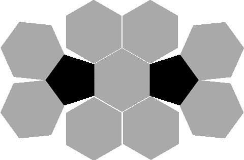

At one time I had begun building a honeycomb multi-cell horn. Actually it was more of a soccer ball face than pure honeycomb. (see below) Still, many of the sections had parallel walls. It would have made a nice section of a sphere, and that was the point. I was saved from the tedium by a good price on some used Altec horns. 🙂
I think that an oval or round mouth multi-cell would be interesting, but what does one do with the spaces between the mouths where they don't touch?
