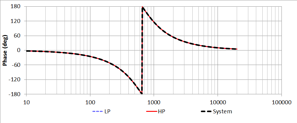

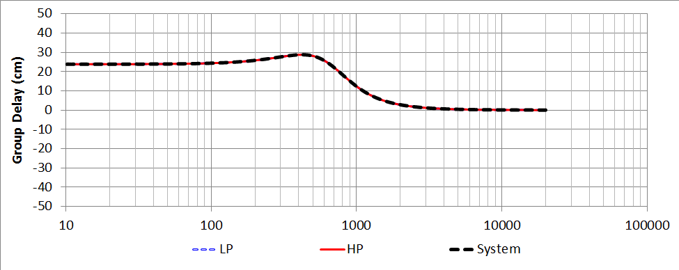

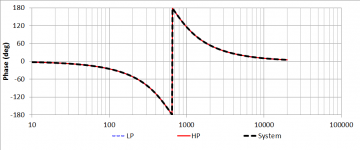

Phase coherent (as in: woofer's phase closely tracking tweeter's phase), yes.
Time coherent (as in: low frequencies arriving at the same time as high frequencies), no.
Marco

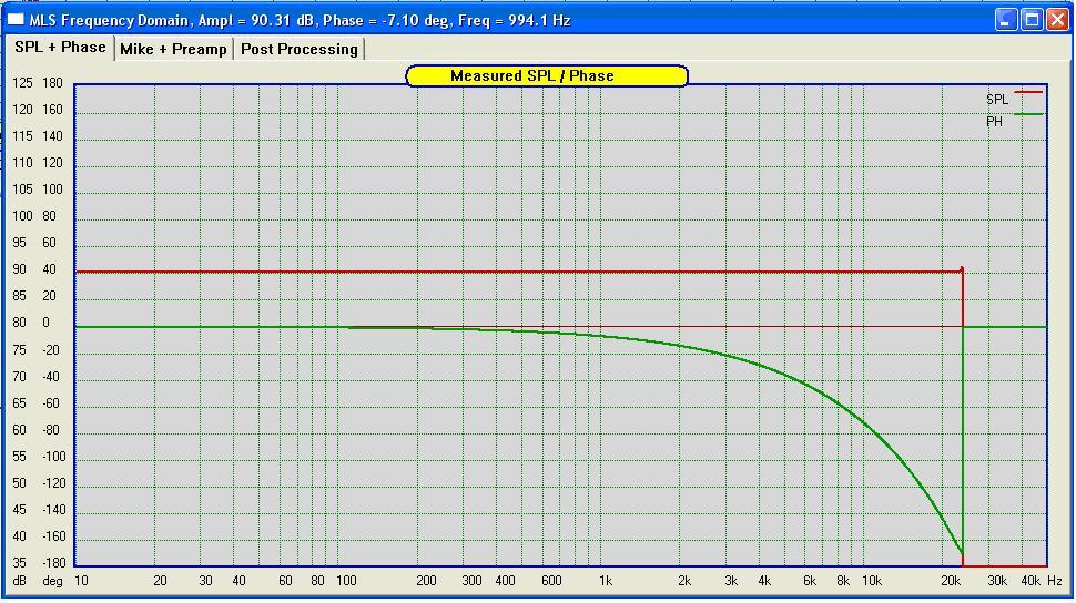

Hi Guys,
"....Tom Holman reports [10] that in his laboratory environment at the University of Southern California that is dominated by direct sound, a channel-to-channel time offset equal to one sample period at 48 kHz is audible. This equates to 20 μsec of inter-channel phase distortion across the entire audio band. Holman [10] also mentions, “one just noticeable difference in image shift between left and right ear inputs is 10 μsec....”.
But let’s relax this tight requirement to 20usec for the sake of an exercise below.
The 20us time difference translates into the phase across the audio bandwidth as shown on the attached figure. The green line is the maximum phase difference allowed between stereo loudspeakers.
So, for instance, at 1000Hz, the allowable phase difference is only 8deg. I do not know of any audio standard that enforces this tolerance, and this is the same issue that Watkinson was lamenting about – lack of decent stereo standard. The BAS people are also on the right track.
Anyway, the overall picture emerging from this short review of papers, is the importance of phase response in multi-channel loudspeaker system design. But not only this. The phase seems to plays vital role in maintaining transient response of a loudspeaker, for the purpose of providing undistorted waveform for correct, two-stage analysis by the ear – localization is one of them.
As a solution, I sign with both hands under the post #5795.
So what means of phase control are implemented in today’s loudspeaker?.
Best Regards,
Bohdan

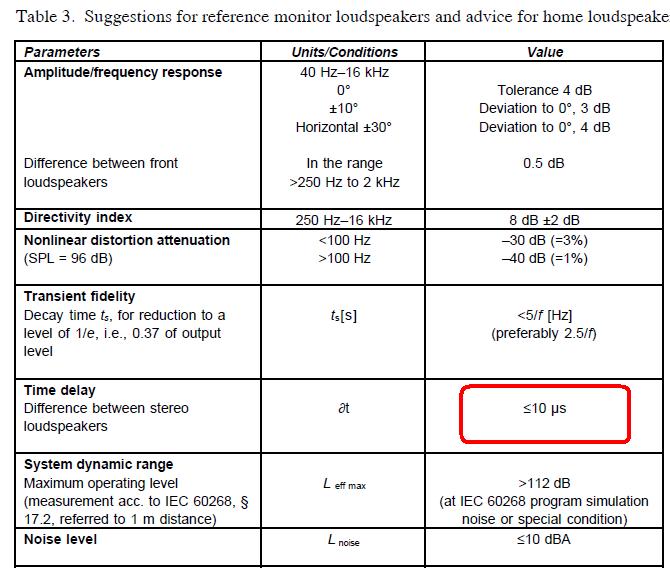

Hi Guys,
I am sorry for misleading you in my previous post. There is an AES document recommending <=10us time delay between stereo loudspeakers.
"AES TECHNICAL COUNCIL - Multichannel surround sound systems and operations.
This document was written by a subcommittee (writing group) of the AES Technical
Committee on Multichannel and Binaural Audio Technology. Contributions and comments were also made by members of the full committee and other international organizations.
Writing Group: Francis Rumsey (Chair); David Griesinger; Tomlinson Holman; Mick
Sawaguchi; Gerhard Steinke; Günther Theile; Toshio Wakatuki.
TECHNICALDOCUMENT
Document AESTD1001.1.01-10
http://www.aes.org/technical/documents/AESTD1001.pdf
Best Regards,
Bohdan
