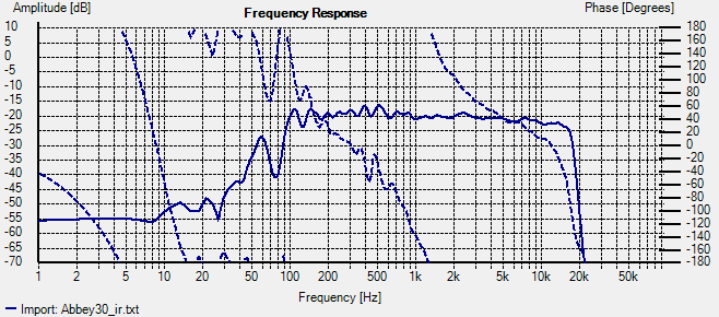

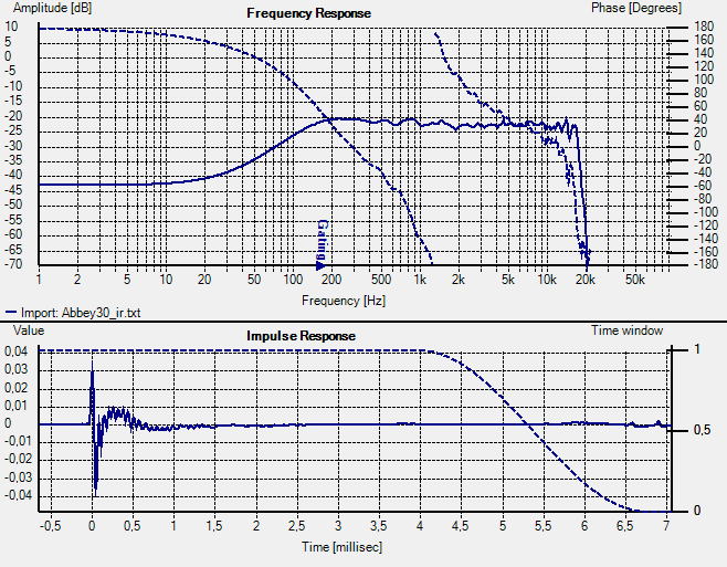

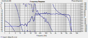

And here is the impulse and frequency response, with phase inversion and manual offset adjustment
(assuming 44.1khz sampling here)
With gating just before what appear to be the first reflection
And smoothed without gating, just to see/guess what is going on down low

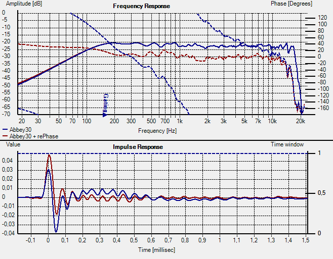

and now just for the fun the same impulse corrected using rePhase:
phase linearizion of an LR24 at 1200Hz, and a closed box at 100Hz with bessel Q
(no other phase EQ used)
That fits quite well with the theory, which tends to indicate this speaker is very well behaved and filtered (as expected)

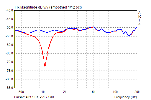

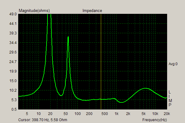

For comparison here is my Mummy (OS 12”, DE500, 12B100R) with Jean-Michel’s 3rd order crossover, 30 deg.
Why don't you send me a complete set of data so that I can post it on my web site along with all the others?
Little patience Earl 🙂 This measurement I did yesterday and for you I need put on turntable and learn how to use Holm 🙂
Hello Jack.
Is there a foam plug or not?
Best regards from Paris, France
Jean-Michel Le Cléac'h
