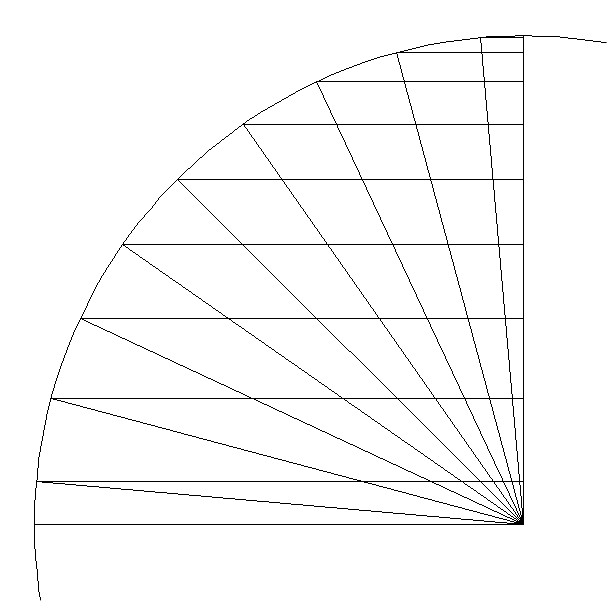

The second example shows the surface area of a ring of the sphere = 2 pi x r x h. h is the vertical height of each ring (vertical dimension only). If the speaker were laying on its back you might slice the sphere into 8 equal height rings (4 above and 4 below). That would include a top and bottom circular cap and 6 rings. All would have equal area and could be represented with a single response curve.
I decided to work through a way to weight measurements as I wanted to verify my weighting, and just thought I'd post it.
This image is a cross section of a sphere with radii splayed over it which are dividers between regions that are represented by a measurement centred between them, at 10 degree intervals.
The formula for the surface area of the portion of a sphere between two parallel planes is: 2 x pi x (radius of the sphere) x (height, ie: distance between the planes).
The 2 x pi x r is common to all so the ratio between weighting regions should be simply the heights, where of course the 90 degree one needs to be counted twice.

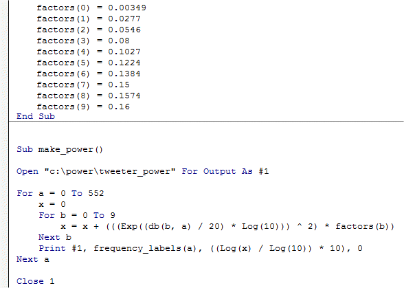

You do know that if you do equal height slices they will all have the same area, thus simplifying the weighting calcs.?
David S.
Yes I noticed that when you wrote it earlier (and considered it). I think what drew me to the other way is that I was set up for the other way, and I guessed it weights the precision toward the more likely listening axes. On the other hand your way weights the precision evenly.
Is there a preferred way? Since writing this, it's fairly quick to do.
I forgot what you are measuring and what its orrientation is, but also remember that a slice of sphere can only be considered representative if the response varies minimally over the extent of that ring. You might need to split each ring into 2, 3, or 4 lateral segments. They can still be equal height and equal area to simplify your calculations.
David S.
David S.
Is there a preferred way? Since writing this (snippet shown) it's fairly quick to do.
At a glance your math looks good, and you've already figured out the area weighting, so go with it.
Looks like you unlog, square the pressure, multiply times the area weight, sum the result, right?
The only "prefered" leaning is to remember with spatial sampling that you want good sample point density where response is strong and varying. It turns out that the power result tends towards the true curve with a surprisingly small number of samples.

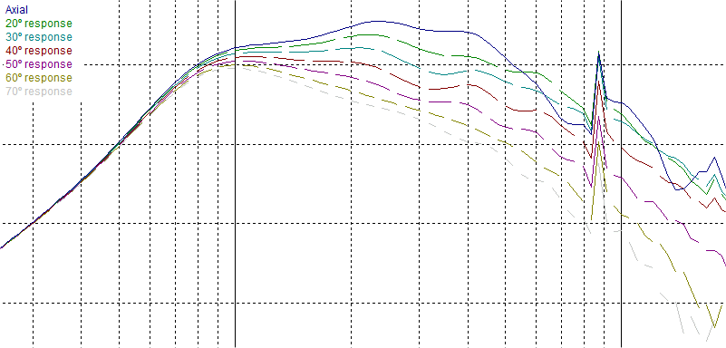

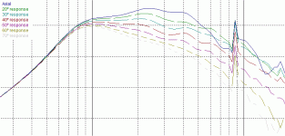

Earl, I have a question about speak.
I'm trying to control mid/bass reflections and have been looking at mid/bass front horns. I've been considering a plain conical waveguide with the driver in a 1:1 compression ratio. Although with a horn I could drop back to a 10" driver for example, I'd like to stay with the current 15" for now.
Is it possible to create a waveguide in Speak which has a throat area of 856cm^2? I considered scaling the driver parameters to work around this but I'm not certain how.
Secondly, is it possible to alter the baffles so I can investigate free space performance and termination methods?
I don't know of any reason why an arbitrary area throat could not be used. You can vary the radius of the termination, but beyond that the baffle is assumed to be infinite.
If you still have trouble then send me the project file.
Thank you. It may not be of significant concern by and large. As it will still behave this way if I begin with a fresh project, here is some specific information about how it behaves on my system (hoping it helps). I've noticed any waveguides I create are persistent between projects so I may have failed to create one as expected.I don't know of any reason why an arbitrary area throat could not be used. You can vary the radius of the termination, but beyond that the baffle is assumed to be infinite.
Up to 500cm^2 works as expected. Any more and the throat will be reduced by a factor of 10. This can be seen instantly in the graphic by using 'update', or in the text box if you save and re-enter. It seems to be irrespective of length and angle, and of default or derived examples.
Now it occurs to me that maybe I should have used complex addition??
I know that the drawing will change and replot at a different scale if it gets too large, but it should not change the actual measurements. If it does then thats a bug. I have not modified SPEAK in years and I am not sure that I can anymore. VB6 is obsolete - I use VB.net now. VB.net cannot use VB6 code without a complete rewrite.
