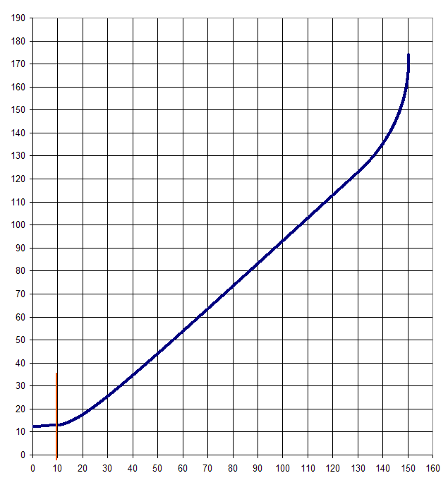

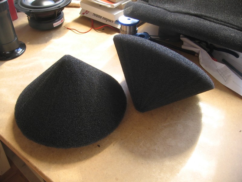

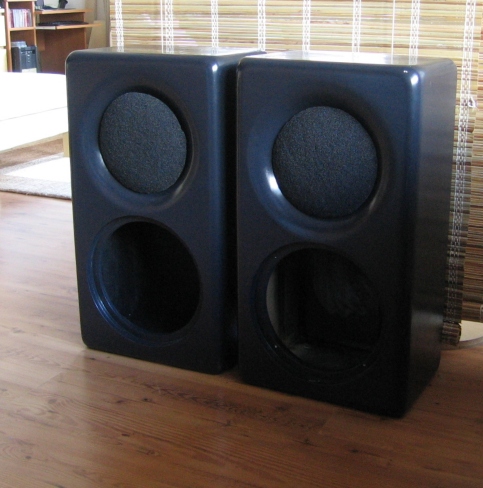

I used 12" WG - it's the one Autotech.pl is selling, only with somewhat refined throat by myself 🙂drool🙂. Actually these were the very first pieces that were made and which I've specified shape for. The foam is Bulpren S 28190 (see the link) that I cut with hot wire and scissors 🙂drool::drool:) - maybe it's a bit denser than the original. You can see some more photos on my web. It was a lot of work, but I would do it again anytime as the result is simply fabulous, whatever the foam does and despite I'm sure I've still made some errors. It was measured with the woofer in place, BTW.
