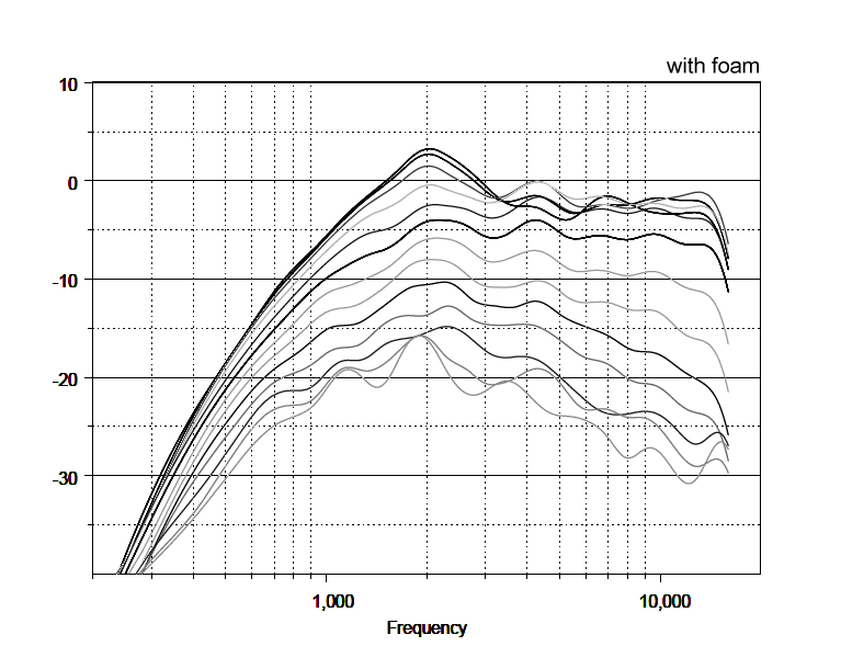

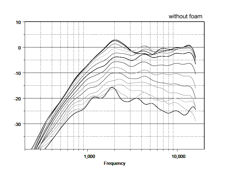

Could somebody point me to a curve comparison of a horn with and without the internal damping foam? I think I've seen it somewhere in the past (maybe here a couple hundred pages back 🙄)
I would think a good set of curves would settle the argument, at least for those that value measurements.
David
Hello,
Yes, I remember that discussion.
You'll find the same graphics but after some processing in order to see the difference more clearly in the attached files there after.
Best regards from Paris, France
Jean-Michel Le Cléac'h
Thanks Jean-Michel.
I was looking for simple before and after response curves showing the effect of the foam insert.
David S.
