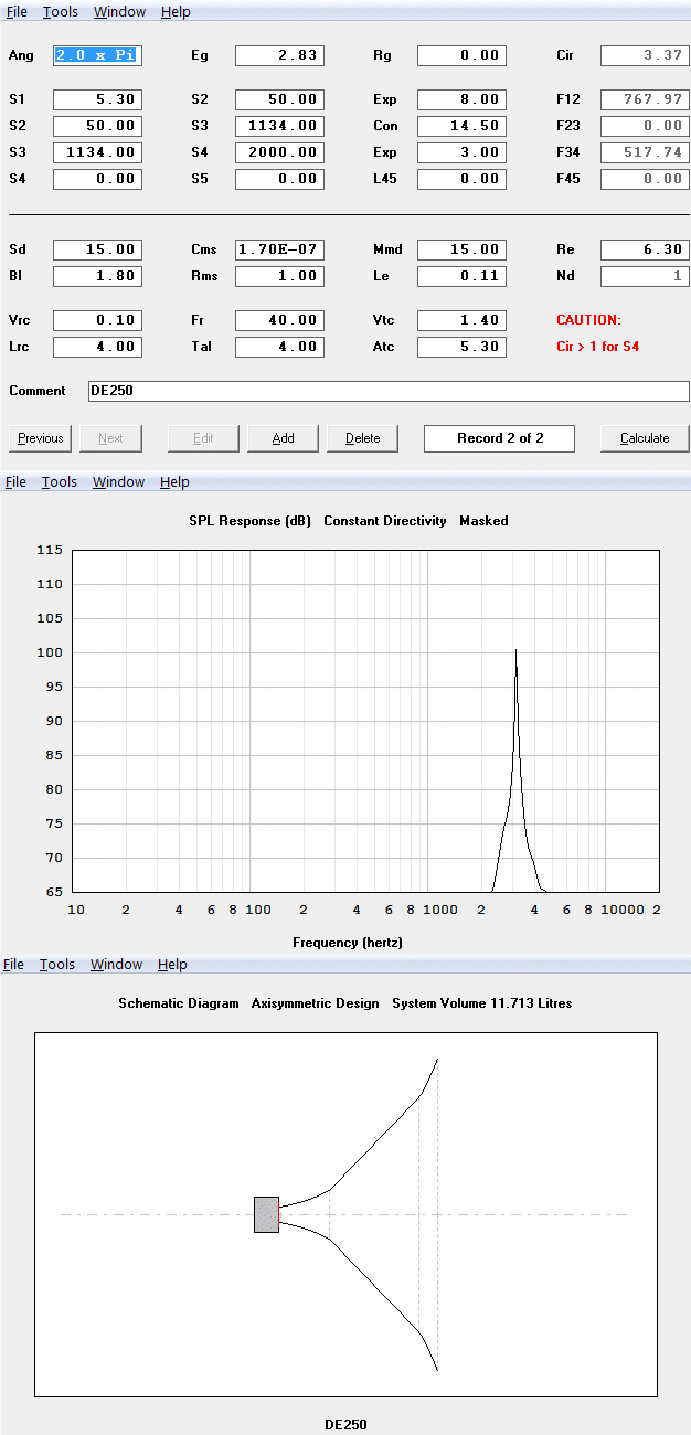

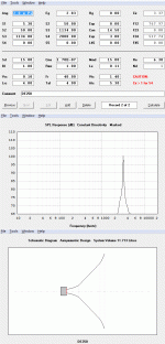

Is it this bad or have I done something wrong?
Hi AllenB,
While Hornresp is not perfect, it is definitely not as bad as your result would indicate 🙂.
Using Dr Geddes' suggested alternative driver parameter values BL = 18.00, Cms = 2.00E-05 and Mmd = 1.20 the Hornresp predicted SPL response will be as shown below.
Kind regards,
David
Thanks David, I can certainly see my oversight.
I have used Hornresp in the past to build various bass horns and it has proved invaluable.
I notice in my above example that changing the length of the second (conical) section (and whilst also keeping the angle), the response changes little. I realise that there is more to a waveguide's response than an just an on axis shot. I recall reading that waveguide mouth size has less to do with the cutoff frequency than would seem obvious. Would you consider your simulation to be within cooee of the correct response?
BTW, your wavefront animations are enlightening.
Hi AllenB,
Kind regards,
David

Hi AllenB,
Provided that the driver and front and rear chamber parameter values are reasonably accurate, then the SPL power response predicted by Hornresp should be reasonably close to the measured results. Note that this is not just confined to bass horns.
Kind regards,
David

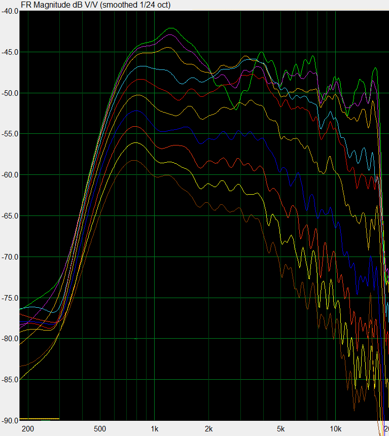

Would someone with more experience than me critique my waveguide based on this plot? It shows 10 degree increments from 0 to 90. No crossover.
The baffle appears the same top, left and right, so I will therefore assume that this plot is a representative sample, and calculate a power response from it. I plan to feed that power response into my crossover simulator. Does this seem reasonable?
