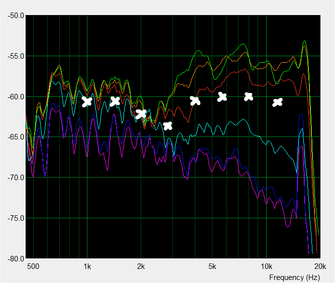

I used the six horizontal plots I had, and added some power response points using your suggestion. This is a system that is crossed and working for me at around 25 degrees off axis.
I gave equal weight to each plot but half to the on axis (green) one as I counted each other twice for left and right.
This is enlightening as it doesn't seem that my horn is in fact CD.

Okay, so I take it that your crosses are 1/2 Octave calculated powers from the collection of curves.
Actually that looks pretty plasuible to me. The only way to prove out something like this is to calculate for a known case, but your points are in the midst of the off axis curves and seem to have a likely shape.
You appear to be fairly close to CD. CD would mean that the power response curve and the on axis curve are parallel, i.e. have a constant dB difference. The difference in dB is the directivity index which also equals 10 x log of Q.
Subtract the two curves (axial curve minus "power" curve) and, congratulations, you've calculated d.i.! Do you have an advertised d.i. for the horn?
David S.
Hmmm, now that I look at it it doesn't look like enough directivity (2-3dB at the low end 4-5 at top). Are you weighting in enough for the off axis curves? At the very least a single backside curve which had 50% of the weighting would be required. Better would be using one of the geometric equal area approaches.

Most horns have a directivity index (d.i.) around 8 to 10 dB. that means your calculated power curve would be 8 to 10 lower than the on-axis curve. Since your calculated curve was only 2 to 5 dB lower I am guessing you haven't done your area weighting correctly yet.
Comparing to a manufacturers spec on d.i. was just a way of checking on your results.
