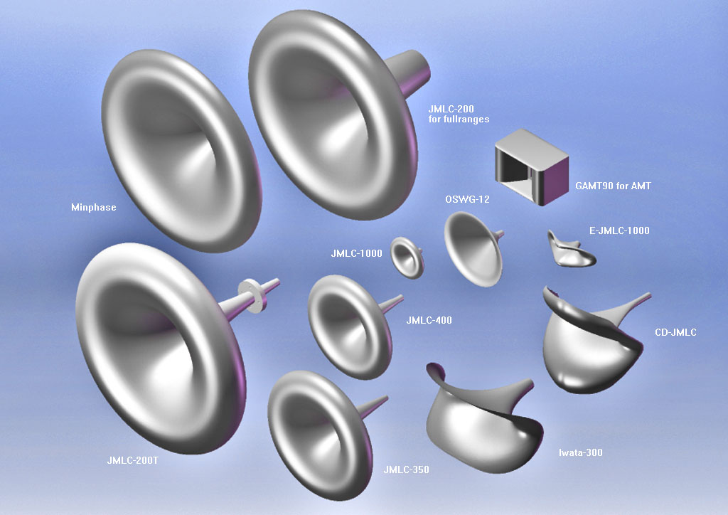

After having some experience with with OS and JMLC (CD vs. non-CD) I pay more attention to cover midrange from 200Hz to 5KHz in one horn using compression driver. Good candidate for both worlds - CD-JMLC "midrange" plus GAMT90.

Zilch those are all great points. OF course, Its the 12" OS WG that I have been discussing so I really do not see how the 14" wide 152i yields anything more practical.
Posting jzagaja's 12" OS waveguide design just had little acceptance and I really wonder why that is.
