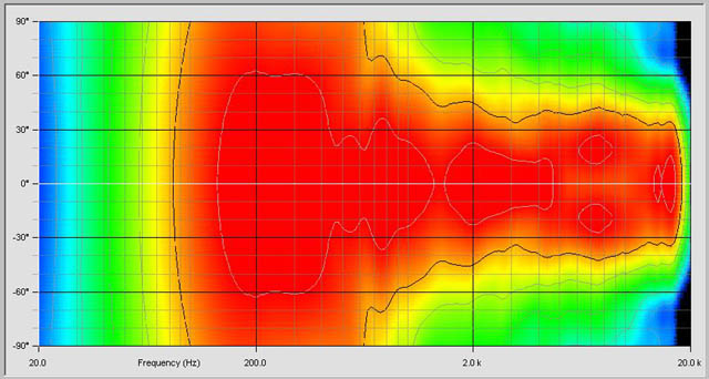

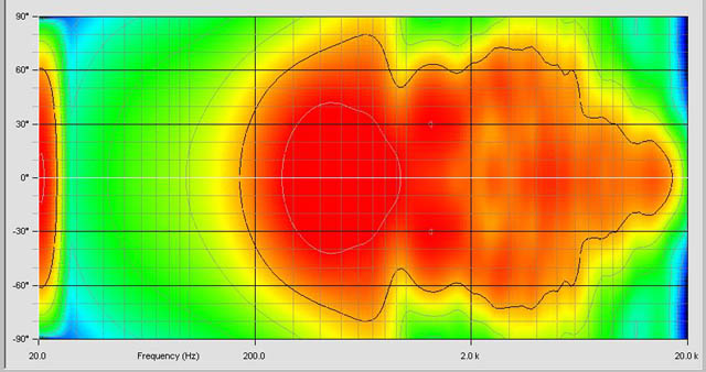

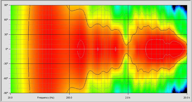

I submit "Defined Directivity."
JBL (Keele) used it to describe horns which varied with angle according to a prescribed pattern for a specific purpose and application, but despite "constant" being unattainable in the strictest sense, whether it is or not, or to what degree, "control" is clearly implicit. In his original paper describing constant directivity, Keele illustrated horn designs having varying beamwidths; beamwidth per se is not definitive, and must be independently specified.
We get into considerable difficulty when we conceptually expand application of these terms to systems as opposed to elements thereof. A system having varying wide dispersion at low frequencies and quasi-constant directivity of narrower beamwidth at high frequencies is a controlled directivity system only with respect a portion of its total bandwidth. By the same token, a dipole system having directivity control at low and mid frequencies but collapsing directivity above 10 kHz is not a constant directivity system either.
Both incorporate defined directivity, however, in the larger view, there is far more to be accomplished in exploring the merits of differing specific definitions with respect to application and performance than in haggling over the terminology used to describe them.... 😉

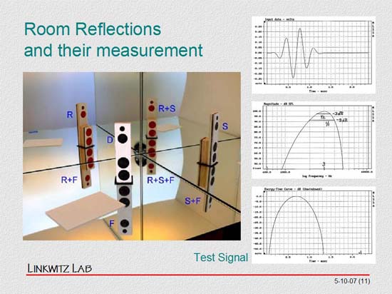

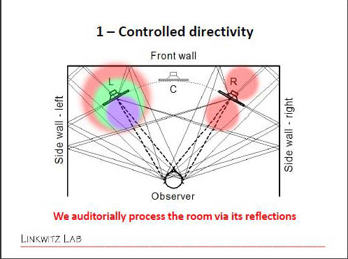

Look at the angles involved, according to Linkwitz; the near-wall reflection comes from almost 90° off-axis:

Toole's book, as I understand it, says first reflections from the near wall are bad (correlated and too soon behind the the direct sound) but first reflections from the far wall are good (delayed enough and uncorrelated with the direct sound to the opposite ear.)
Yes Zilch, I think we're in vigorous agreement here. 🙂 A dipole set up like Linkwitz's diagram wouldn't need an absorber because of the 90 degree null. But if you had a speaker closer to the wall and maybe not at that angle, you'd probably want to absorb the near wall reflection but not the far wall reflection (small absorber).
The far wall is just that, far. The SPL drops with the square of the distance.
Yes, but that reflection is also generated more on-axis. According to Toole Fig. 8.5, discounting directivity, -2 dB for the ipsilateral reflection, and -6.3 dB for the contralateral. It's the delays that most matter with respect to their relative detrimental influence, 2.7 ms and 12.3 ms, respectively.
With on-axis toe-in, the ipsilateral comes from -73° (Fig. 16.6) in Toole's standard room and setup. From Earl's measurements, the dipole does not appear to be as effective as the waveguide in suppressing the ipsilateral reflection at that angle in the frequency range of primary interest:
