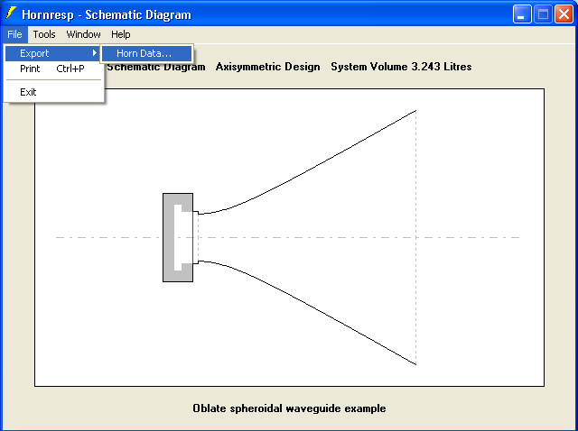

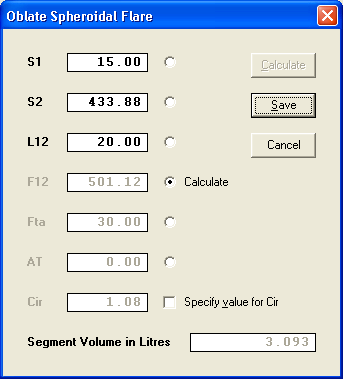

Hi doug20,
If you are familiar with Hornresp, simply use the Horn Segment Wizard tool to design any OS waveguide you wish, and then export the Schematic Diagram horn data. Note that the throat entry half-angle AT does not necessarily have to be 0 degrees.
