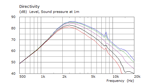

This is an overlapped sim/measurement posted last year.

I think the intention of the OSWG is to have a uniform SPL over a range of angles. If you want flat on axis and strong off axis low frequency response, then it would be a different shape where the beam will narrow with frequency.
The problem seen on-axis for the OS waveguides that I make are not the result of the contour, but of the mouth. Changing the contour will not fix the problem, but changing the mouth will.
This is an OS with a narrower profile, curves are with simple equalization. An OS profile was also used to make it blend with a baffle, but the baffle was not put on there during this measurement.

And overlapped with sim without equalization

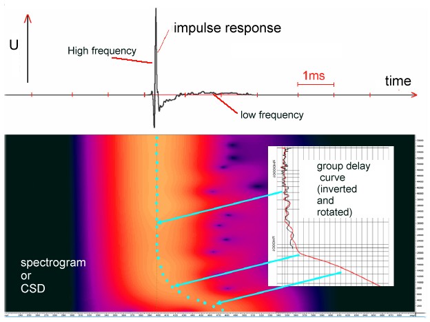

Hello Soongsc
You'll find here attached a graph swowing in its upper part a screen copy of a measured impulse response , in the lower part of the graph you can see a spectrogram (this is equivalent to a CSD graph) using the same time scale and in the small window on right you can see a group delay curve obtained by derivation of the phase response of that impulse response.
As evryone can see, in a small interval of frequency the group delay as calculated is equivalent to the delay after which the wave group inside this interval of frequencies arrives.
So imagine a horn having 1 meter group delay at 600Hz and a group delay of 10 centimeter at 1200Hz and 1centimeter at 1800Hz and 1 millimeter at 2400Hz. Then take a signal with a fundamental at 600Hz and its harmonics H2, H3, H4.
The upper harmonics will arrive before the lower harmonics and before the fundamental. The shape of the signal will then be distorted. Many audiophile are sensible to that kind of distortion.
Best regards from Paris, France
Jean-Michel Le Cléac'h
