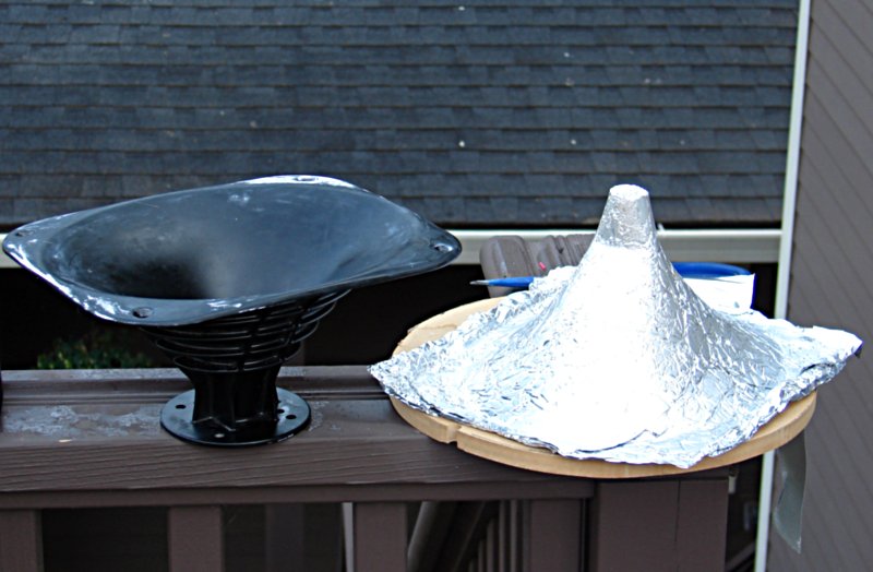

Patrick Bateman said:
The strange thing is that the XT1086 changes coverage angles slower than the OS curve. The coverage angle in an OS waveguide changes from six degrees to ninety degrees in the span of 1/2". The XT1086 changes it's coverage angle very VERY slowly.
I would think that this wouldn't be a bad thing, but the polars are inferior.
Having said that, the data is a bit suspect, due to where it was measured.
I'll take a picture of an elliptical OS waveguide and the XT1086 and post it, it will make more sense then.
I'll state the obvious - if the shape (expansion) is different then no matter how it looks, it is not an OS waveguide.
Since you are doing a mold, you might modify the molded part to meet the OS expansion specs more closely?
_-_-bear
Absolutely. The thing that's a bummer is that I'll bet a number of people have bought the XT1086 and assumed it's a substitute for an OS waveguide, based on how the mouth looks. But the throat diverges from OS by quite a bit.
This is my elliptical OS waveguide mold. Sorry I don't have a better pic - this is before I applied glass and bondo. It looks a lot better than this now.
Here's a mold made from an XT1086. Note that the throat is muuuuuch longer than the OS waveguide, even though their coverage angles are comparable. The OS is 108x72, the XT1086 is 80x60.
