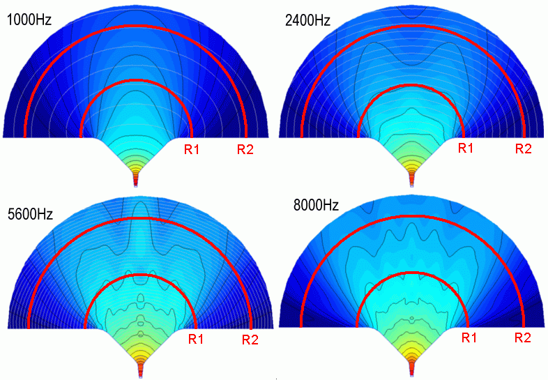

Hello Earl,
I cannot believe one second that you could have problems in deriving polars from soundfields maps. ().
For Noah and the others:
consider a set of 4 pressure fields maps like on:
http://www.diyaudio.com/forums/attachment.php?s=&postid=1762155&stamp=1236070764
(eventually you may want to CD equalize in the HF)
we can draw on those pressure maps circles at radius from the mouth for which we would want to have polars.
Angles ticks may be drawn on those circles symetrically to the axis.By example 5°, 10°, 15°, 20°, etc. (and their negative symetrical)
For those angles and for those 4 frequency, 1000Hz, 2400Hz, 5600Hz and 8000Hz we can retrieve the acoustic SPL.
Then we are able to derive a polar (SPL for coordinates frequency/angle) for a given radius.
Here we have only 4 frequencies but we can have more.
I don't have myself pressure fields covering large area around the OS waveguide mouth, so I used the previous graphs and traced 2 circles with radius R1 an R2 (I know this doesn't cover large radius but it is just for the purpose of the explanation why 2 polars may differ if taken at 2 different distances).
See attached file.
The variation of SPL along those circles differ a lot between R1 and R2. We can see that at 2400Hz and 5600 Hz the variations of SPL are very large for the radius R2 and smaller for radius R1.
This means that the polars at R1 and at R2 will differ a lot too in their smoothness / roughness.
As you can see as radius enlarges, the number of lobes reduces but the SPL variation for each one is larger. I don't know how it will be at 3 meters. I doubt that the roughness will be totally supressed.

gedlee said:And for what its worth I have no idea what you were talking about in your polar field response answer to Noah. Maybe he understood, but I don't.
Jean-Michel
Again, you don't listen very well. Those are all nearfield responses and completely irrelavent as no one sits that close to the sources. I made this point the first time that you showed them. The further point that was made was that as one gets into the far field, and 3 meters is certainly in the far field, then there will no longer be any variation on the polar response with distance. You seemed to disagree with that and I could never figure out what it was that you were saying. Now you are once again back to the same pointless nearfield plots and stating again the same misrepresentation that you stated before.
