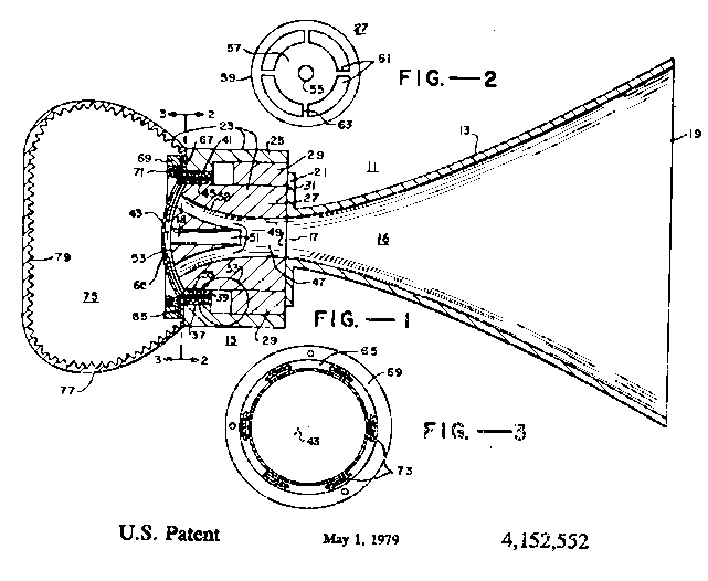

Hello Paul W.
Seems to me that JBL get their inspiration from a patent in date of 1979 from Meyer .
See attached file:
Best regards from Paris, France
Jean-Michel Le Cléac'h

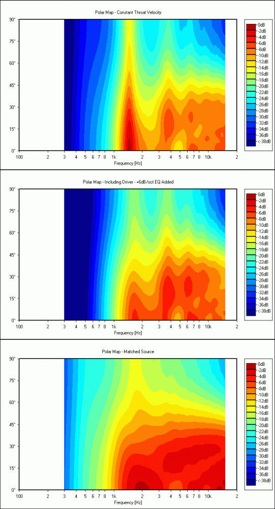

I've implemented various method of presenting a polar map now. Here are 3 different versions for the small OS waveguide I simulated some time ago, including the driver internal flare.
The top plot shows the waveguide with constant throat velocity. The middle one shows the waveguide with a driver model added, including a +6dB/oct EQ, as suggested by Earl. The bottom plot shows the waveguide with a "Matched source", as described by Keele in the AES preprint "What's so sacred about exponential horns?". In short, the waveguide is driven by an acoustical source with a source impedance equal to rho*c/Sth, where Sth is the throat area of the horn/waveguide. In a way, this source is a driver without mass or compliance.
Earl, if these plots look sensible, I'll post data for the Le Cléac'h horn too. I just want to make sure I do it right first 🙂
Bjørn
Bjørn
Bjorn
Yes those look quite reasonable. The third plot is the one that shows the performance of the waveguide since the aberations from the driver have been removed. This is the one which should be used to compare the waveguide/horn, not the other two.

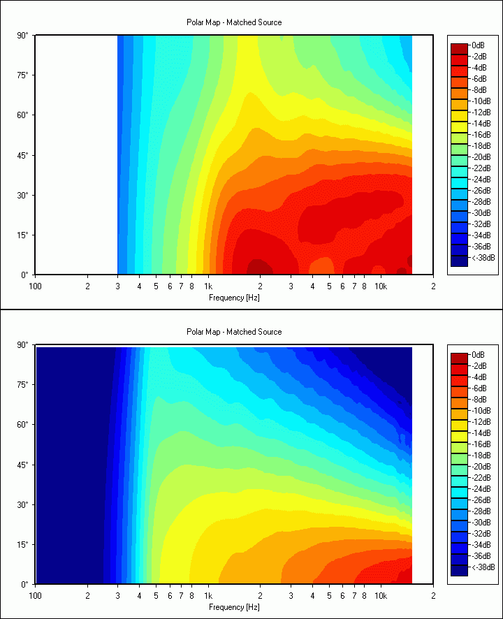

Great. Then here is the 'Matched Source' polar maps for the OS waveguide (once again, but in full resolution) and the AH-425 Le Cléac'h horn (lower plot).
I will leave comments to others. I'm just providing the data for your amusement, and then I'll take a long easter break 🙂
Bjørn
Bjørn
