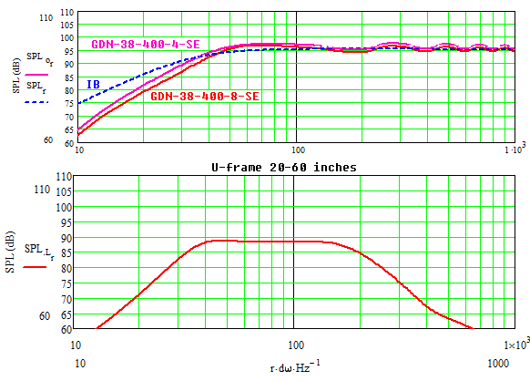

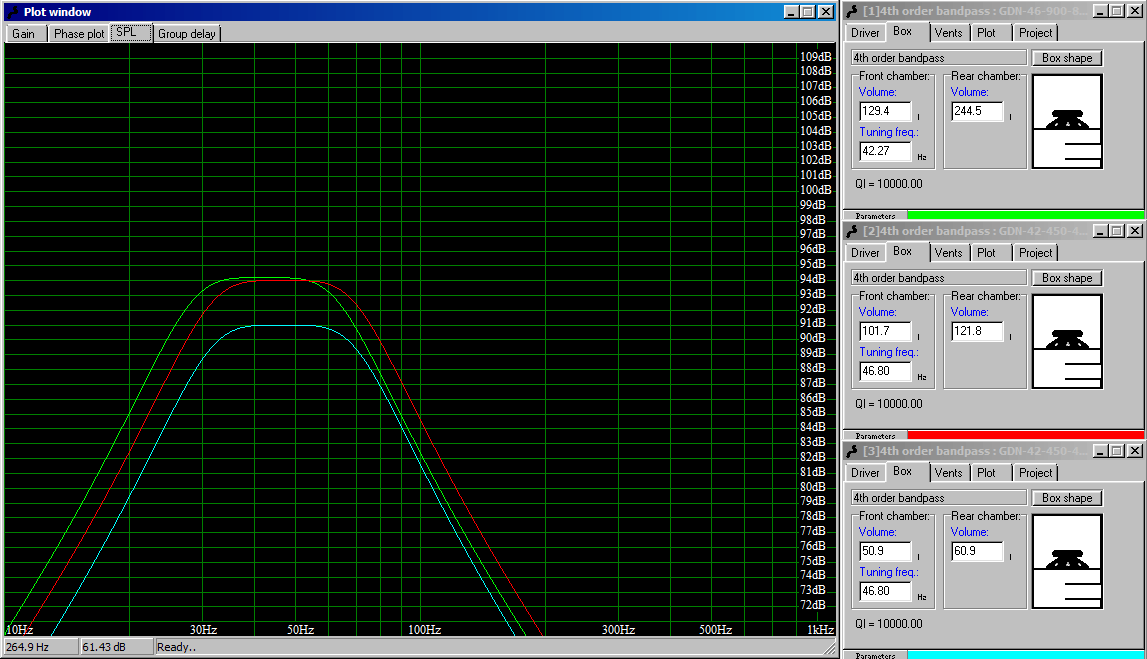

Sealed vs. ported vs. PR vs. bandpass
Hello. I am also interested in trying out a multisub approach. If I remember correctly, Dr. Geddes recommended using multiple subwoofers for 40-80Hz and one or two bigger subs for frequencies below 40Hz.
I wonder, what will I lose if I simply build three or four small subs and hope that they will cover the range from 20Hz to 80Hz? I think one reason to use separate subs for 20-40Hz is to ease the placement of the many subs that cover 40-80Hz, because that way they can be smaller. But if I build all my subs small, then this is not a problem.
I simply need to settle on a driver and a type of enclosure. There is a continuum from 1) dipole, 2) sealed, 3) ported, 4) passive radiator, 5) bandpass with one ported and one sealed chamber to 6) bandpass with both chambers ported. These are in the assumed order from "tight, clean and articulate" bass to less "clean and articulate" bass.
I need to know, if people rated these in a blind listening test, would dipole always come on top and would dual ported bandpass always end up last? Or are one or two of these always different from the rest? Do I gain or lose perceived quality if I go from ported to passive radiator or from ported to bandpass?
My second stated goal is to go as low as possible. Do any of these enclosure types allow that without eq? I know that the sealed box often matches the room gain. But I also know that many would rather tune a "house curve" than listen to a sealed box plus room gain resulting in a flat 20-80Hz response. Instead, a flat 20-80Hz anechoic response plus room gain often results in a kind of "house curve".
I also assume that driver harmonic distortion is not a problem per se, but power compression is. And to get less of that, I should rather use pro drivers than anything offered by Seas? To state my problem another way is, if it is possible to get good bass from multiple 1 cf cubes with any enclosure type at all? If my starting point is four Seas L26ROY with one passive radiator for each, where would you go and what would you do if you were me?

I would elliminate the dipole as its efficiency is not sufficient in the frequency range you are talking about. Then, as far as I am concerned, the rest are all about the same. I don't buy your "ranking" of subjective appeal. I use only bandpass subs and I find that they work just fine. Dual ported is a tough enclosure to get right. Easiest is closed box, but requires a big box to get down to 20-30 Hz. Passive radiators are great, if you can get a good radiator at a "reasonable" price (not what I have seen).
I would say that 1 cf cubes is not going to work very well as that is just too small. Bass takes power and size and nothing that I know of can get arround this simple fact.
My subs go much higher than 80 Hz. One goes all the way up to about 130 Hz. The big ULF only goes to about 80 Hz.
100 liters seems enough for push-pull to get decent 30Hz at 91dB. 200-300 liters for higher sensitivity like ULF-18. There's another small solution - tapered transmission line - for example 1:10. Usually there's more subjective bass extension than simulated response suggest (room gain).
