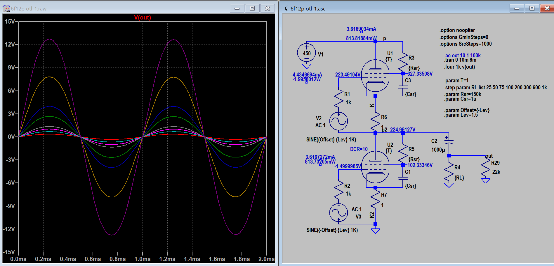

You need a phase spilter or anti-phase driver, for SEPP both tubes are driven in anti-phase, unless SRPP. LTP (Long Tail Pairs) is commonly used, the top drive is boostrapped so to achieve equal drive level for each top and bottom tube and about 20 db negative feedback provides about overall unity gain. If you need more gain you can design LTP stage around pentode tube or add another gain stage. The constant current source (CCS) can be provided by three leg LM337, and resistor limiting current to 2mA, 1mA for each 12AX7.

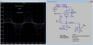

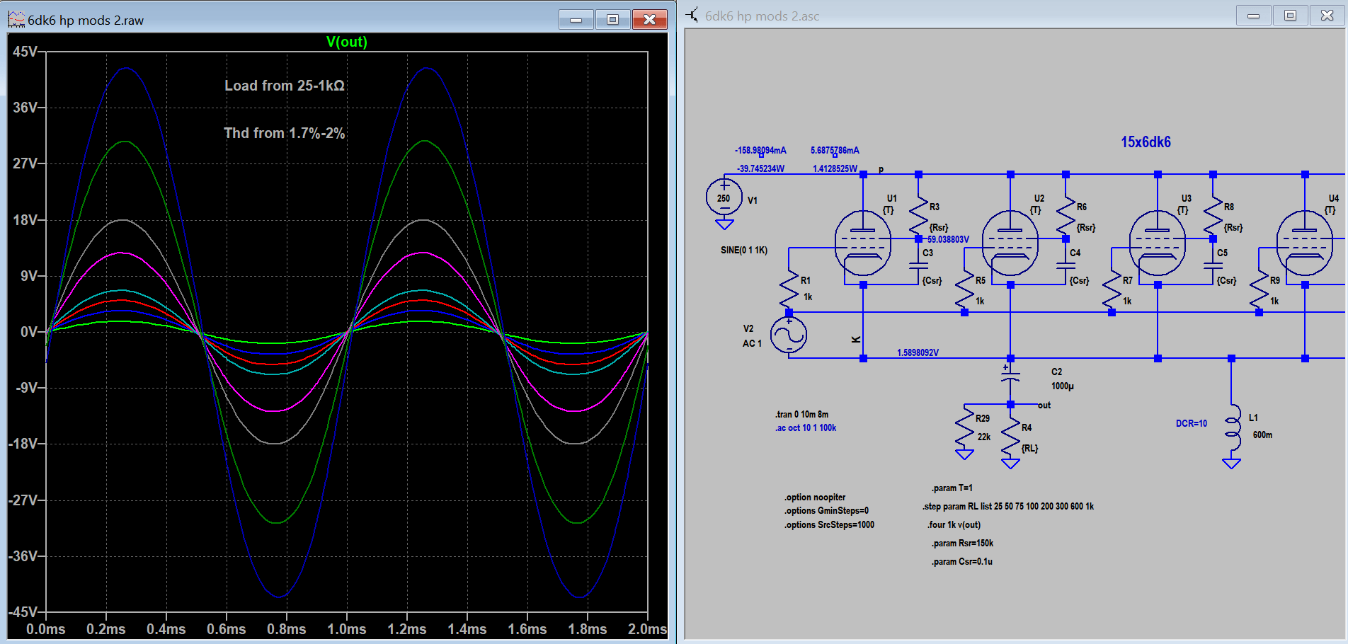

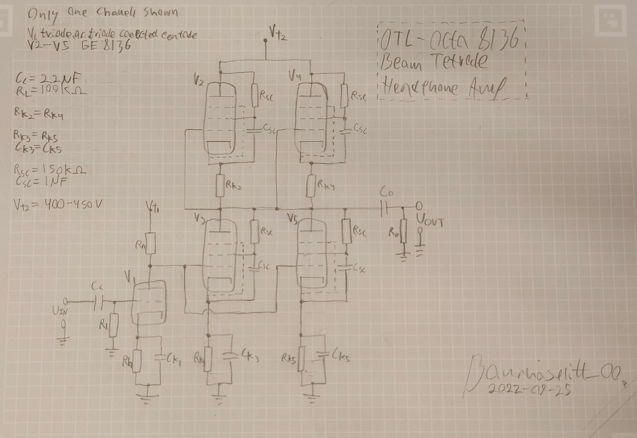

Oh I must have read SEPP as SRPP as that's what I drew on my paper. It was getting kind of late 🙂
SRPP would make the PSU easier if I used something like a 6AU6 for the input stage as I would only need one 450V rail rather than a 450V and a 200V but would this be much worse performance wise?
Is the same, how you derived V+1? Are u going to direct couple to SRPP output stage? Maybe cap coupled is easier.
For SEPP driver, current drawn is 2ma, just use resistor drop voltage 450V-250V=200V/2ma=100k, with filter cap of 10-22u can do. There is not need for another xformer tap as current demand is low so no performance degrade is expected. If you're worry use zeners regulation (say 100Vx2+50Vx1).
In my SEPP sch, the gain can be higher if NFB is relaxed a bit say Rnfb reduces from 100k to 1000k. It's much harder to design SEPP than SRPP as you see from sch, of course you can pick whichever one works best for you. There are many SRPP sch you can refer.

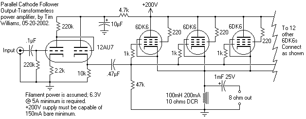

Btw Mullard call your sketch sch SEPP : https://frank.pocnet.net/sheets/129/e/EL86.pdf
https://audioxpress.com/article/The-SPP-Amplifier
Got V1+ from looking at some load lines and bias points I found around the Web for the 6au6. Was thinking direct couple but capacitor coupled is probably easier.
Nice to know about the PSUs for the SEPP, that makes that a viable idea. Would probably reduce the NFB to get more gain if I do. Would end up being a lot less silly with only three tubes per chanel too instead of the five I was thinking(though my design could probably be fine with just three tubes if the input stage has some gain).
Also wondering about LTP vs Concertina phase splitters, the Concertina is really simple and only needs a single triode where as the LTP design needs a double triode. This doesn't really make much of a difference to me as the difference is using one or two 12ax7s which is no big deal to me but I would think there are more differences I'm not seeing at a glance 🙂

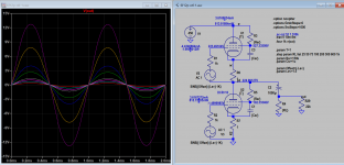

Here I sim the concertina ps version, ps stage is direct couples, and NFB is feed into grid so a larger resistor can be used to avoid loading of the output. 20db NFB is not quite practical with feedback into cathode without causing an arm and leg.

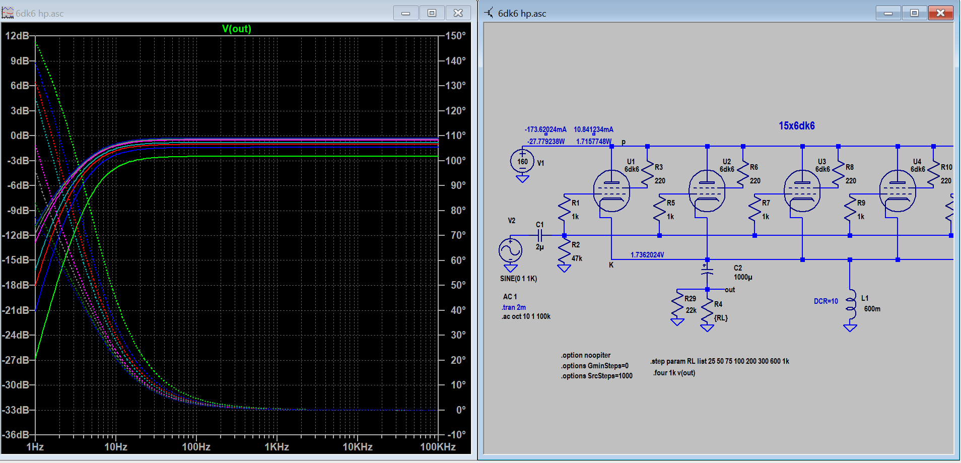

Hi, I must confess 50 ohms is a difficult load for 2w tubes as OTL, it better suit to transformer type. The 15x tubes is just sim of schmatic of another person, not mine. The later LTP and concertina are my design, of course I still not sure it meets your requirement. If you need more suggestion there are other forum members and me here to help out, even your resouce appeared limited.
Hi, I must confess 50 ohms is a difficult load for 2w tubes as OTL, it better suit to transformer type. The 15x tubes is just sim of schmatic of another person, not mine. The later LTP andconcertina are my design, of course I still not sure it meets your requirement. If you need more suggestion there are other forum members and me here to help out.
The LTP design seems to produce slightly over unity gain with a 50 ohm load in your sim, if the feedback is slightly reduced it would do the job I would think 🙂

Took a look at what I've got around for the PSU and have decided that it's much much easier to build a 350v V+ supply, that would end up as about 175V over each tube instead of, slightly lower but I belive that should be fine.
Still have yet to decide if I'd rather build SRPP with an input gain stage or SEPP with LTP.

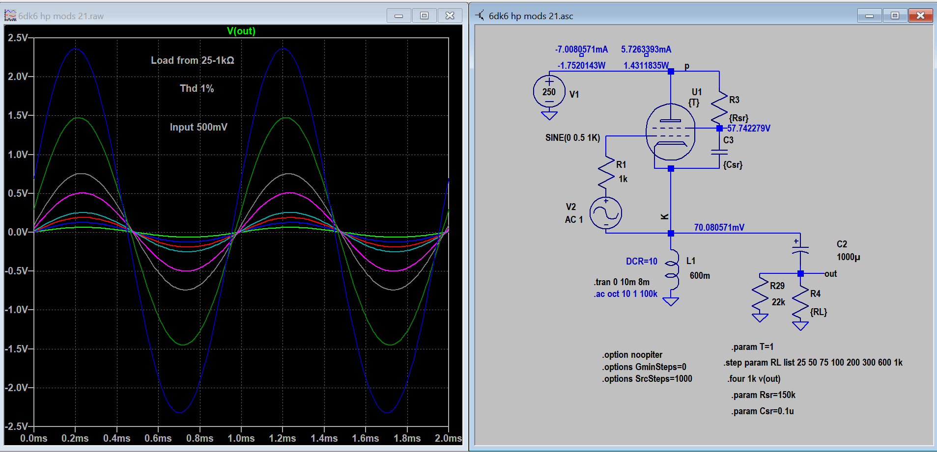

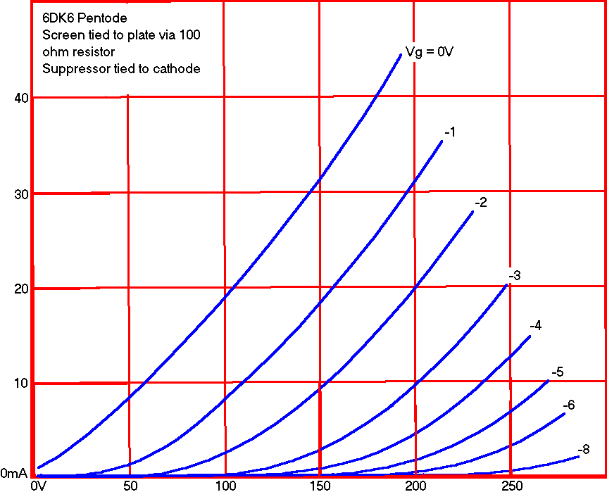

How come you have the bias of the tubes at - 4V in this schematic? I was thinking more like - 1.5V to get more power out of the tubes? Is it to reduce the quiescent current? At - 4V is be afraid to bottom the tube from looking at the datasheet 🙂
Because it's class AB amp, only needs the minimal current to overcome cross-over distortion. By increasing the grid swing it gives more power output.
Ah right but still wouldn't class A and a - 1.5V bias give more power? Of course it would also use a LOT more power but when the output is already struggling I would belive that tradeoff would be worth it? (even if this design in AB seems to work well already! 🙂 )

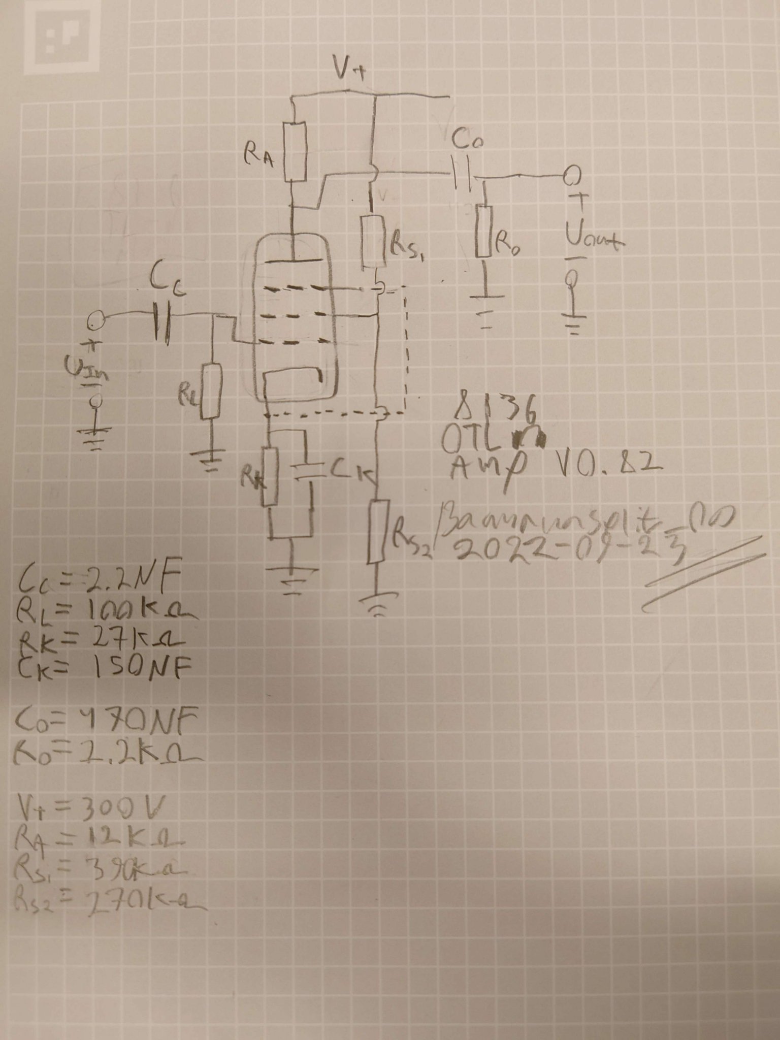

Well stuff got in the way of posting for a bit but here is where I am at now. Didn't draw in the negative feedback because I am not entirely sure how to do that right. I think I want to have it be adjustable too. I did drawn in a switch to swap between the LED class AB bias and a resistor class A bias because I want to experiment a bit. Might remove that feature later, don't know.
Haven't simulated the circuit, just done hand calculations for estimating loads and the filters but I belive this should work alright 🙂

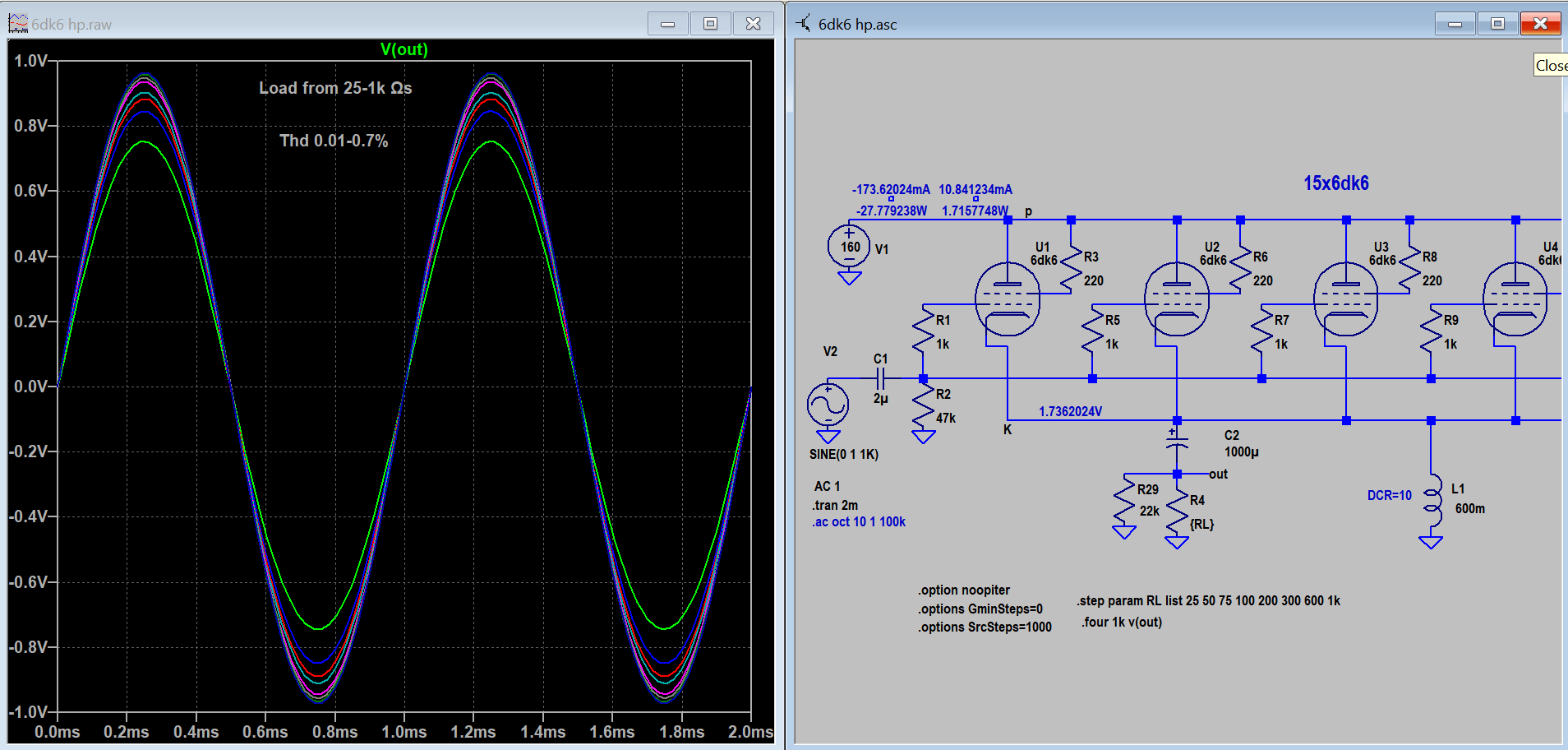

Was finaly able to put away some time to simulate everything in LTSpice, played around a small amount with some values untill i ended up with whats in the picture which i am fairly happy with! About 2dB gain for the audible spectrum with a 50ohm load, could go for more by making R12 bigger but i found this to be a fairly nice balance between gain and flattness of the gain curve 🙂
