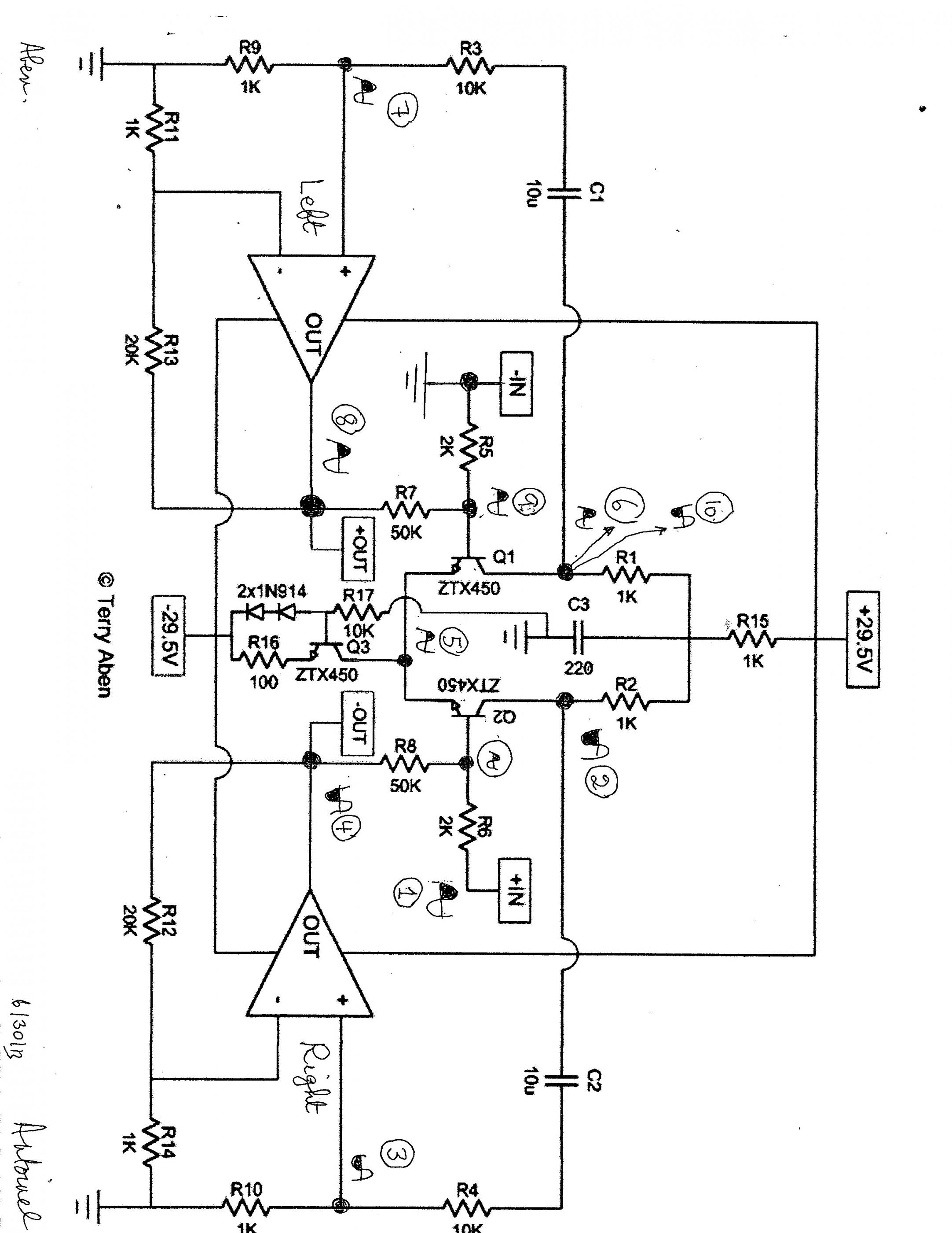

The following schematic is by metalman [T. Aben]. I superimposed on it the half shaded sinewave caricatures in order to visually [a la Pass] show the effect of driving one input alone [e.g. Right amp]. Follow the numerical sequence [1-10] on the caricatures with particular focus on their phase. I hope it'll help your work. Note that I grounded the negative Input.
- Signal 9 must be of opposite phase than written.
- It is amplified by Q1 and shows up as signal 10.
- Signal 6 and 10 cancel fully or partially; because they are out of phase.
- The left chip now receives at best a low level signal [7] to give a low level output signal at +Out [8].
- The phase of the Out signals are correct; but the magnitude of the signal at negative Out [4] is much higher than that at positive Out; which may be zero in value; if signals 6 and 10 fully cancel each other.
- Thus the Left amp works as a current sink [virtual ground] to the Right amp.
- The net amp is not balanced or one is operating the right amp only with its intrinsic distortion.
The resultant amp complies with "the resulting amp will not deliver very low distortion."

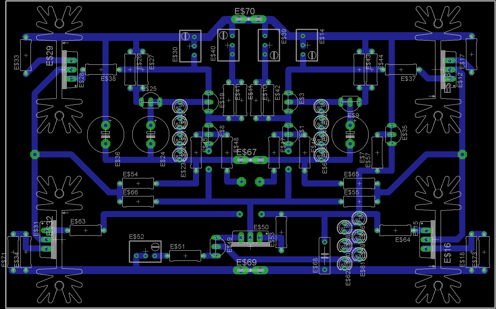

I'll decipher your pcb. Best regards

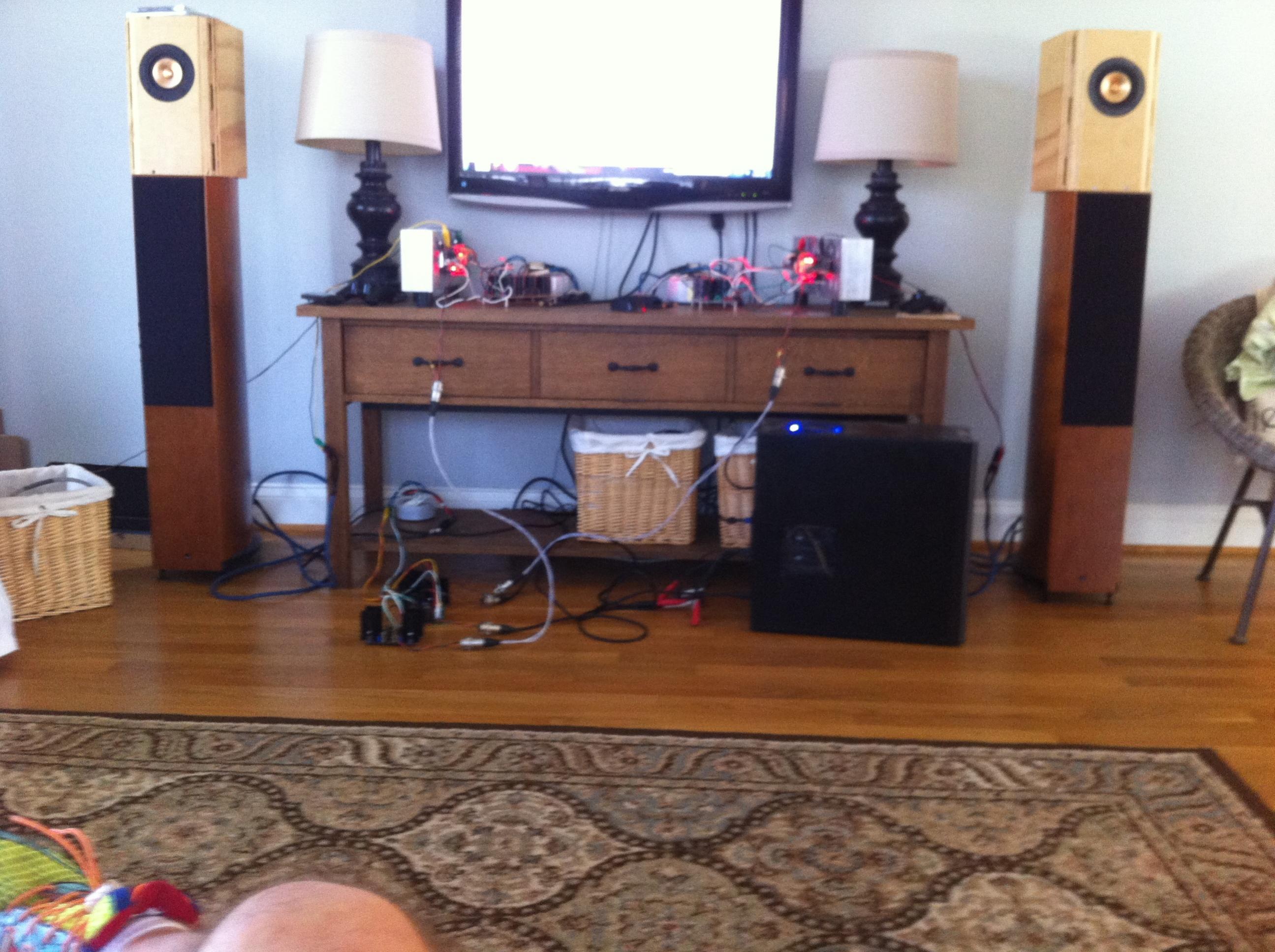

It is a balanced THRESHOLD S/150 power amp using the SuperSymmetry lessons in this thread. Is there an amp which tops the performance of this combination? Schematic to follow.For those who didn't find "Monolithic SuperSymmetry" interesting

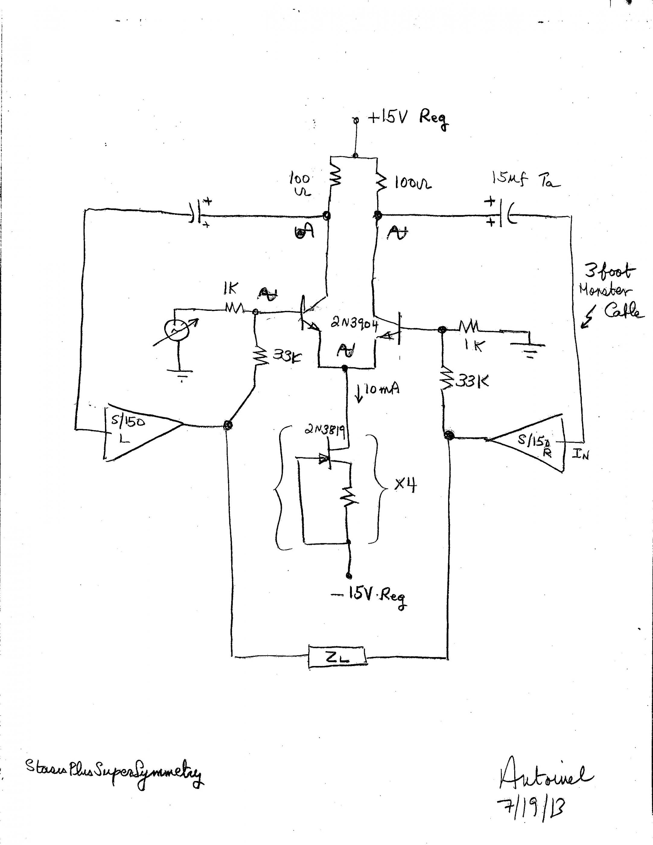

The schematic is attached. The diff amp was assembled on a Protoboard. The following are the setup rules to establish stable operation.
The above protocol was also practiced on the chip amp LM386 [100 milliWatt], a Realistic STA2000D [75W/Ch into 8Ohm] with equal success. I'll post performance details.
Best regards
- No load to the power amps.
- Start with 100 Ohm load resistors to the diff amp
- Turn on the power amp
- Check for a high frequency oscillation at both power amp outputs
- If no oscillation, turn off power amp and increase the value of the diff amp load resistors to 120 Ohm.
- Repeat this sequence with increasing valued resistors; e.g. 150, 180, 220, 270 Ohm until the amp breaks into oscillation.
- Back off to the lower valued resistor where no oscillation was observed.
- Connect a dummy resistive load, and power up the amp. The amp
will not oscillate.
[*]Disconnect the resistive load and connect a loudspeaker. The R and L ampwill not oscillate.
[*]Enjoy music.
