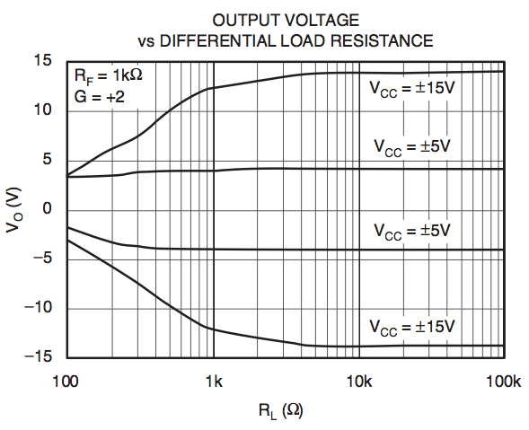

I have boards for two F4 amps and was wandering if it possible to drive them with just opa1632. From datasheet it appears that its output voltage will swing to within 4-5V of the rails, so 15V rails should yield 20V swing, correct.
According to it's datasheet specification OPA1632 swings to within (V-)+1.9V and (V+)-1.9V, respectively, when loaded by 2kOhm. Into 600Ohm this drops to 4.5V within the supply voltage levels.
For a +/-15V supply this would yeld +/-13.1V into 2kOhm and +/-10.5V into 600Ohm. That's 21Vpp into 600Ohm already. 😉
I've attached the diagram showing output voltage vs. load resistance from the datasheet in order to better explain what I mean.
