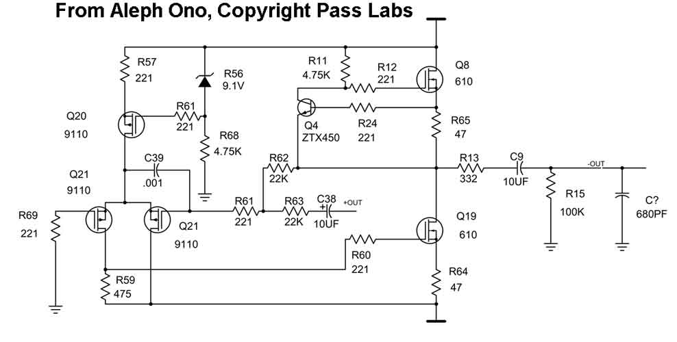

To have the benefit of the supersymmetric effect, the circuit requires a balanced source. However, my previous statement that the circuit was not stable with a single-ended input was based on my experiences from an earlier stage of development, and the most recent posted schematic builds an amp that is more stable, so it may be possible that it will work with a single ended input now. I can't say for certain, cause once I got my BZLS up and running I just kept using the balanced connection. If I get a chance I'll switch it over to a SE input and see what happens.
If the lastest version is stable with a SE input, then you will still get the higher power output into higher impedances, and the better bass control, just not the supersymmetric noise distortion cancellation.
On an aside, although I am very proud of my CC-CCS-X-BZLS design and think very highly of it, there are other options for converting balanced to SE if you don't want to go to all the trouble of building a complete preamp. The first that comes to mind is the converter from the Aleph ONO (schematic attached).
Cheers, Terry
