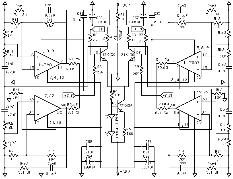

Since some of the speaker projects I am pondering may run rather low impedances as they are I figured I'd take a whack at a SUSY treatment on 4780's paralleled.
I don't have anywhere near the hobbies knowledge of many of the other folks messing with this, let alone the EE's, so anyone trying to use this schematic for anything does so at their own risk. 🙂
I think that most of the component values metalman arrived at will work here, though there are some that may need to change - in particular the cap on input and the R from + input to ground. Using AN1192 as reference, they go from 47K on either the bridged or parallel up to 47.5K. They also halve the input cap (1uF to .47uF) on the BPA vs either B or P. I'm not sure whether either matter (and it's certainly simple enough to try some different values).
This could just as easily be a quad of single channel chips.
Holler with mistakes or feedback. And dangit, I just saw one! Arrgh. The caps from V+/V- to ground should, of course, be in parallel and not in series! And of course, it also appears that I have forgotten to get any signal to the input on the chips! How did I miss that?! bah. Embarassing.
I'll fix it this evening and update the pic.
C
Nothing I haven't done a few times over. Don't sweat it! Feel good that you are jumping in and trying something different.Originally posted by cjd
Had a quick look at your schematic, and you're off to a decent start. It'll definitely need a little refinement, but then they always do, it's just part of the process. Give me some time to look at it in some detail and I'll get back with some thoughts.
Cheers, Terry
I've gone and updated the pic, so what's posted should now have the two mistakes I noticed corrected. I'll have to see if I can re-arrange things to clean it up any. A bit of a rats nest I'm afraid.
Aside from the paralleling circuits and the mute resistors, the circuit is (I think) no different. 🙂
I won't be able to order parts immediately, but when I do I expect I'll try to grab a range of components to have stuff on hand to swap in if I find it needs it. If it fails, I can always just do some boring standard versions (assuming I don't go blowing things up).
Anyhow, any feedback prior to that will of course be most helpful and very much appreciated!
C

Eh. Cleaned up a little and with some component values thrown in. Still makes me dizzy making sure I have the right connections in the right place through the middle. All those stupid overlapping lines.
I also discovered I had neglected to mark a handful of ground connections... ahh, will it never end?!
C

Amazing how this stuff runs through your head when you're nowhere near it. 🙂
I'm now unsure whether the caps I have labeled Cin should be one per amp as I have drawn, or one per side and split to the amps after the cap. I am similarly still very unsure on the value that should be used here. I'm thinking that if it's a single cap instead of the two, it should be the 4.7uF listed but if it's two as pictured it should be the 10uF metalman used. I'm not entirely sure in this circuit what to base the value of this cap off anyhow... it's significantly bigger than a "normal" chip-amp would use here. I think it's what I've labeled Rin.
I've also been pondering whether or not to parallel the chips on each side, or to run half of each chip on either side of the bridge - mostly because 4780's are reported to have the two on-chip circuits well matched and balance is less critical (I think?) on the parallel circuits.
I may end up trying this with a "snubber" style PS vs. regulated, since Pedja's circuit would require a pair of regs per chip.
Looks like I may end up putting together buffers up front. I assume this circuit just takes two? Though I do think I have an amp with a pre-out. No dedicated pre at this point. Could just build one. 😉 So many projects, so little time (and patience on the part of my wife). While I'm at it, might as well do an unbalanced>balanced signal bit. And a . . . uh oh. 🙄

After the regulation stage, I have a 1500uF PanaFC cap at each of these locations on each chip: between V+ pin and ground; and between the V- pin and ground. According to the guys over in the chipamp forum I should use smaller decoupling caps after the regulation stage, but I wasn't initially planning on regulating the supply, and after I regulated I had more challenging problems to attend to than changing the decoupling caps, so I left the 1500uF caps in.
Much later on I did try replacing the 1500uF caps with 100uF caps, but I didn't notice any real change in the sound and I had other needs for the 100uF caps, so I put the 1500uF back in. One of these days I'm going to try Carlos' snubber arrangement and see if it makes any difference. My initial impression from these experiences is that the supersymmetry is greatly reducing the effects of PS induced distortions in the chips, but I'll reserve final judgement on that point until after I try the snubbers in the ciruit first.
Cheers, Terry

cjd, sorry it took so long to get you some feedback. Let me make a few comments.
Cheer, Terry
For the Cin caps, go one per side and split the signal to the chips after the cap. As to the cap value, the bigger the cap, the lower the roll-off frequency on the bass response. That being said, I don't see a problem with using 4.7uF there, you should still get linear response down to below 20Hz.I'm now unsure whether the caps I have labeled Cin should be one per amp as I have drawn, or one per side and split to the amps after the cap. I am similarly still very unsure on the value that should be used here. I'm thinking that if it's a single cap instead of the two, it should be the 4.7uF listed but if it's two as pictured it should be the 10uF metalman used. I'm not entirely sure in this circuit what to base the value of this cap off anyhow... it's significantly bigger than a "normal" chip-amp would use here. I think it's what I've labeled Rin.
I don't think this choice will have too much effect one way or the other, but my initial thought is keep both halves of each chip on the same side of the bridge. My rationale is that the two on-chip circuits should be relatively well matched, and this matching will reduce the degree of preferential current hogging that might occur on each side, and reduce the dependance on your Rout resistors to keep the output current evenly distributed. My instinct is that you will need to increase the value for your Rout resistors, but try what you have posted first, and see how it performs.I've also been pondering whether or not to parallel the chips on each side, or to run half of each chip on either side of the bridge - mostly because 4780's are reported to have the two on-chip circuits well matched and balance is less critical (I think?) on the parallel circuits.
I'm absolutely loving the BZLS variation I recently completed, and it can drive any amps input, eliminating the need for any input buffers on your XGC. The main reason I've been taking so long to respond is that I've been spending a lot more time listening to music of late, mainly because my BZLS and XGC make quite a complementary pair.Though I do think I have an amp with a pre-out. No dedicated pre at this point. Could just build one. So many projects, so little time (and patience on the part of my wife). While I'm at it, might as well do an unbalanced>balanced signal bit.
Cheer, Terry
