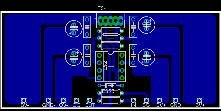

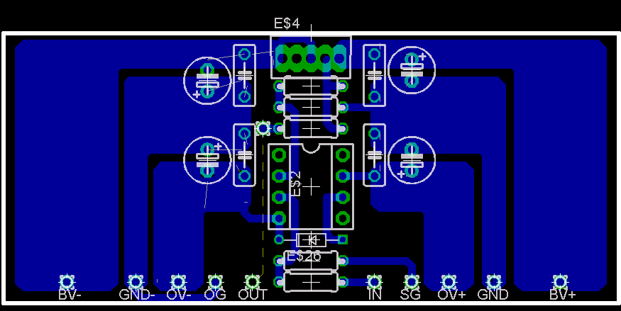

Ok here is my new and improved Brian GT inspired, single channel preamp section.
I have made this version a single layer for testing, but im still working on my double sided version. Im finding it a bit tricky as I have designed very little single sided boards never mind double sided ones.
Being single sided I was unable route one trace (the dashed yellow line) I will just jumper this with some wire.
Well, heres the image let me know what you guys think.
Cheers
Craig.

Nice!
Why dont you route the trace from E$2 pin 2 on the outside of the chip and up to the resistor? then you can take the output down the center underneath E$2 and you get rid of the jumper.
Just an idea..........
All electronic industry use connectors for easy mounting and repairing. Why amateurs doesn't ? BTW, why you have on PCB so many grounds ? You need only two, signal and filtration. 😉

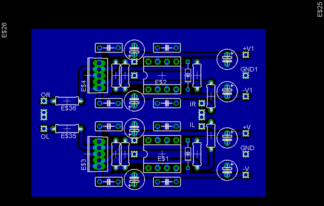

n00beR said:Finally i have finished my own design and only one jumper w00t 😀.
I think every thing is present and correct, let me know what you guys think.
Thanks in advance
Craig.
Noober,
This design looks better to me.
Upupa Epops said:All electronic industry use connectors for easy mounting and repairing. Why amateurs doesn't ? BTW, why you have on PCB so many grounds ? You need only two, signal and filtration. 😉
It was just to make decoupling the chip supplies easier, because of the single sided layout.

Ground Loop
Hi Upopa,
I heard you said once that the grounding on PCB should not be routed as a close loop as it pick up noise. Jleaman PCB did just that. Pls comment.
Thanks.
Hi Upopa,
Thanks.
