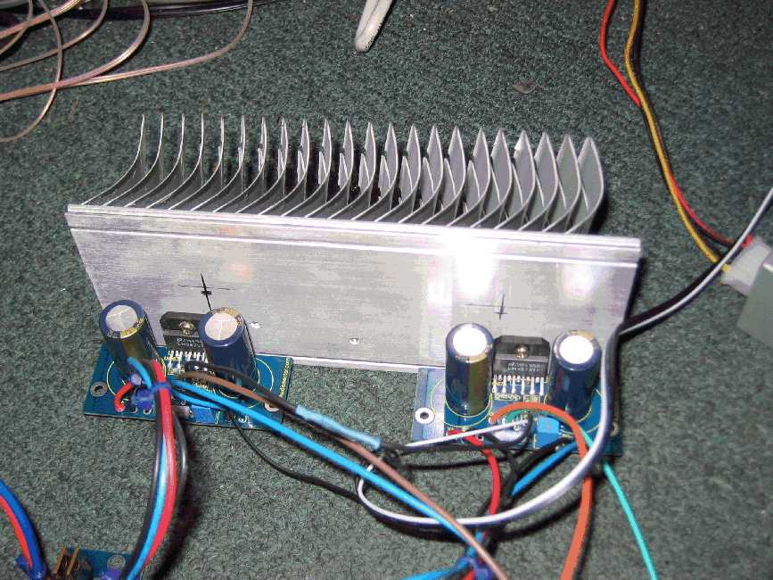

I am running my 3875 gainclone with a 4ohm load and i have a big heat sink made out of aluminium that measures about 7.5" x 3" x 1/8" full of fins on one side and they are about 2 inches long. My two chips are on the same heatsink and when the volume is at maximum it gets pretty hot. i don't know if it's normal...it's my first gainclone 🙂
should i buy another heatsink??? or its completly normal.... i searched the forums and they say that running the gainclone at 20v shoudn't dissipate any heat (mines runs at 20volt AC before rectifier and 28.5V DC after )

At full volume it's normal if it runs warm/hot but take care of some points:
- are the chips isolated? If not are they isolated mounted?
- check inputs and outputs: may the gc oscillate (capacitors with wrong values)?
Some pics would help...

The sound is very good and loud
the chips are 3875TF (isolated)
and for the oscillation .... i bought a kit from Peter Daniel and installed everything that came in the kit so i guess they are the right values
But at low volume everything's alright i guess the heat is normal. and when i put a 8ohm load the temperature is even lower. i tought the 3875 couldn't handle 4ohm impedance
