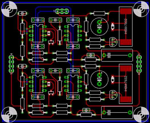

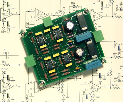

THrough a month of work , just finish a board (single-sided PCB replace with through hole 8-pin OPAMP sockets) use same components like an original introduced. However, my result is out of my thinking that is not work properly. So here seek your comment about this circuit whether anyone can succeed on building that with a good performance result ?
I finally got this finished but haven't the time yet to test it yet. I pretty much followed the posted schematic and parts.
Hi Sklimek,
It's very wonderful thing but if it had passed your test will be fantastic.
Can you share the PCB layout with me ?
Or, if you have a more, how about sell one for me.
I have a pair of lager meter from Japan , not sure who have interest ?
CK
Hi CK, I did a quick hook up to the output of a of a CD player and and watched very small meter movement, the output was only .5 volt though. I need to wire it up correctly to see if it works correctly, I also need to figure out what my meters are and how to calibrate it as well. I'll try to get to it this later this week.

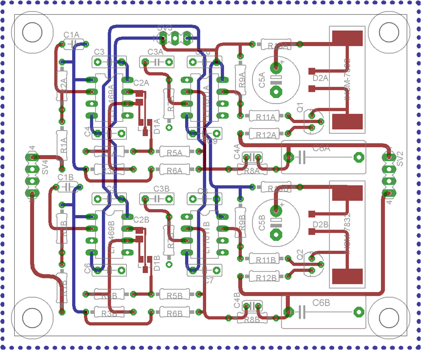

I made the circuit w/ Eagle, here is a revised .sch and board layout, keep us posted, thanks - Stan
The passage claimed the first stage gain factors is 6. In general speaking CD player can deliver 0.5-1v rms output for this circuit. So that it can be operated in a larger scale.

Here's the Eagle .brd file.

I recently reworked the board and had the same problem of no gain at the outputs. It would be great to have your eyes and brain on this to see where my problem is if you are interested.
Best - Stan

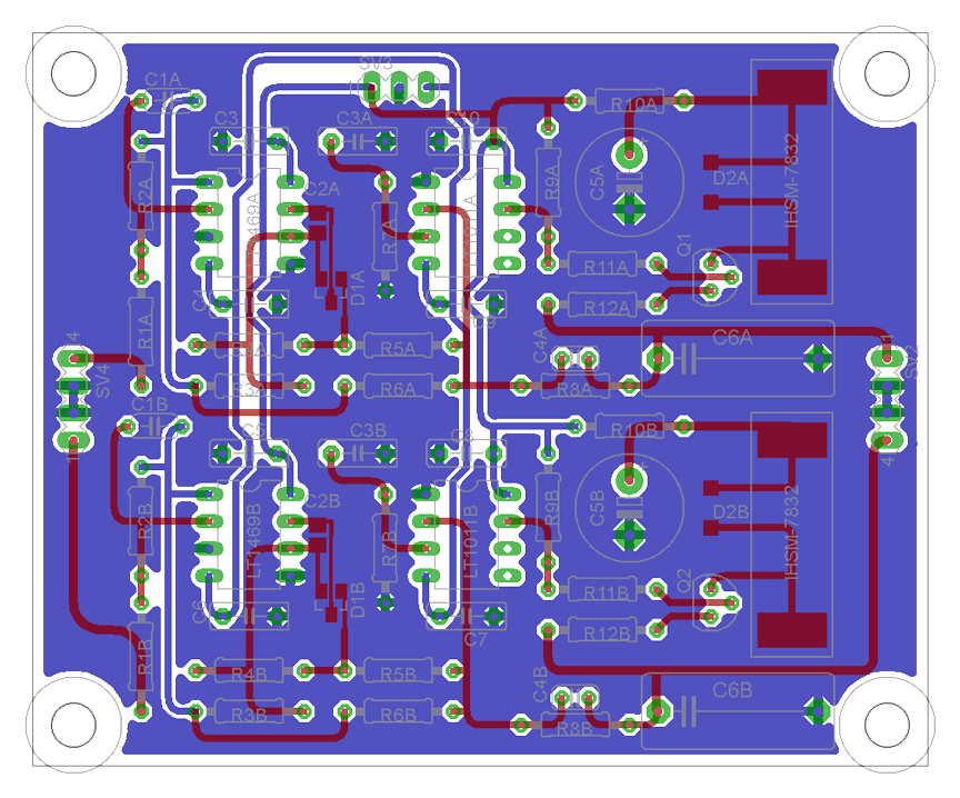

OK, here is the latest version of the board. I attached the BOM, Eagle files and pics of the board.
This schematic was created from the original EDN article Volume-Unit meter spans 60-dB dynamic range scroll down.
As mentioned before I had gain problems on output.
Hope this helps…
