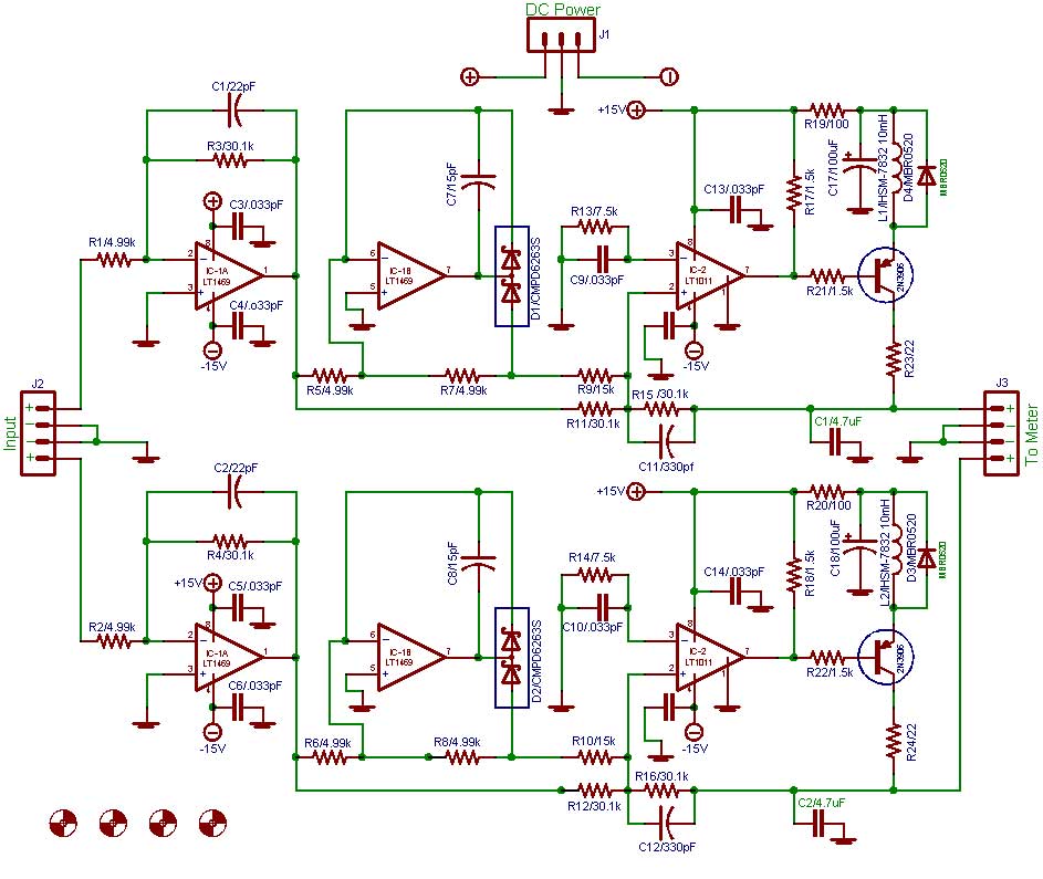

In submitted article, it is mentioned that this volume meter is meant to be used with typical 100 W amp. What if amp is much bigger? Do we need to add some voltage divider or that could be done through the circuit, or meter should be changed for higher voltage.
Does anyone knows what replacement diodes to use instead of ones in schematics:
D1 MBR0520 and D2 CMPD6263S? These are surface mount and I would like to substitute them for through hole for point to point wiring.

I completed this circuit by doing point to point wireing on small proto board. I got small 10V AC Voltmeter just for testing purpose. The circuit works well, but I am not sure that meter is the right choice. I still have to calibrate meter for the max and min movement as explained earlier by Jacinnj. The movement is what I am not too happy about. Niedle moves rapidly, and is very sensitive (easily reaches max) but has a lot of inertion. That results in the niedle rocking left and rigt with no signal until it setles. I do not know if the problem is that voltmeters are not made to have a fast movenmet and maybe I would need VU meter to test.
If anyone else made a test please post your experience, partcularly on meter movement.

AR2 said:Niedle moves rapidly, and is very sensitive (easily reaches max) but has a lot of inertion. That results in the niedle rocking left and rigt with no signal until it setles. AR2
Are you using the value of inductor specified.

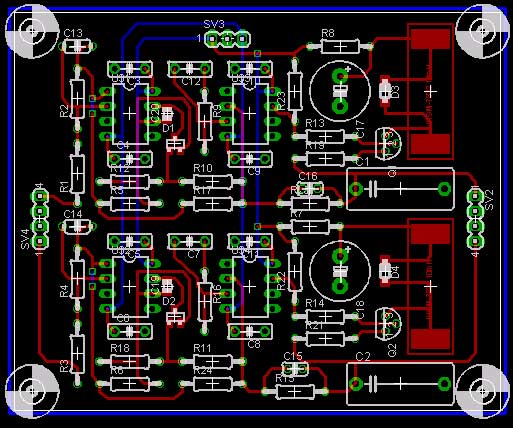

I designed my first two sided board from the schematic by Jon Munson and Jackinni at the beginning of this thread.
I was hoping that someone who is familiar with Eagle could give it a look-over for accuracy, clearances, etc., also a little help on setting up the Gerber files as well before I send it out for a prototype. I pretty much followed the components as illustrated at the beginning of this thread and created a new package/device for the IHSM-7832 SMD inductor. The MBR0520 (D3 and D4) diodes are a sod-123 package zener; I just didn’t want to design a new component for this (borrowed the correct config. from the library) and the CPMD6263S (which reads as a BAS 40-04) is correct as well. The board measures 4” X 3 1/4”.
Here is the .brd file and some pics…
