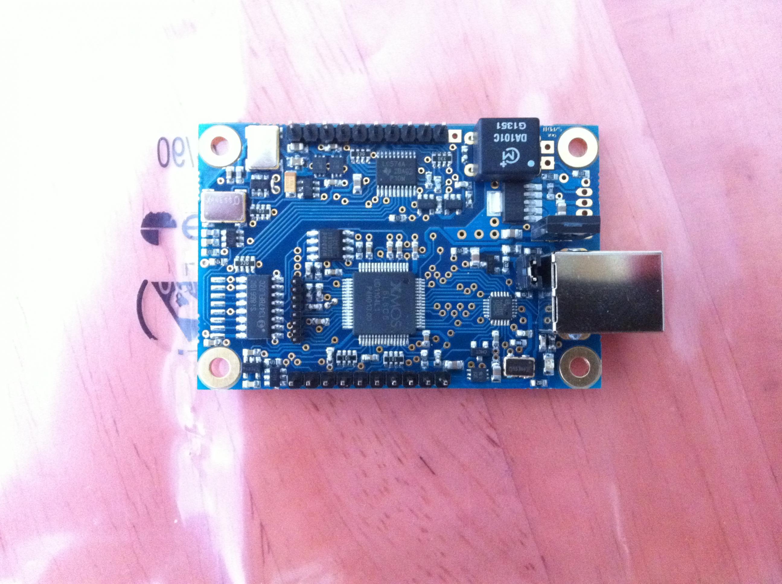

Joro,
Just wanted you to know that I received your package just yesterday, here in California. As others have noted, the package was carefully packaged and the XMOS USB board carefully sandwiched in many layers of miniture bubble wrap which insured no damage on its journey to its new owner. The board looked beautiful. I can't wait to solder it in my Buffalo IIIse and listen!
So that others can see your quality workmanship on the board AND careful packaging, I am posting two photos I took.
Many thanks!
