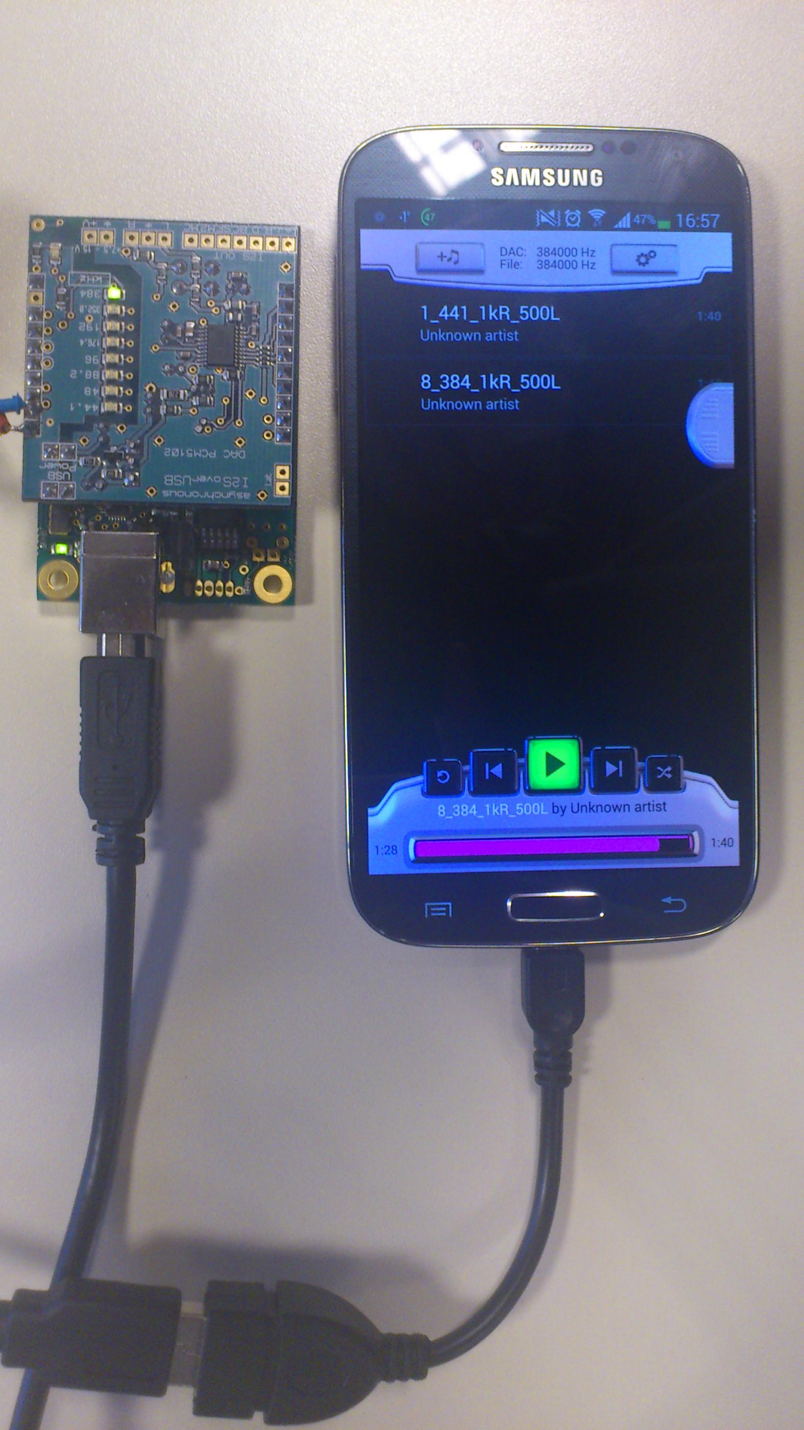

Some good news for Android users.
I've tested the device with Samsung Galaxy S4, HTC One X by using this program,
https://play.google.com/store/apps/d...audioplayerpro
I've tested it up to 384kHz and works perfect. Of course with external power supply for the USB part. If one can install this program (there is a trial) and have USB OTG, XMOS board must be working. If someone test his Android device, please share.
