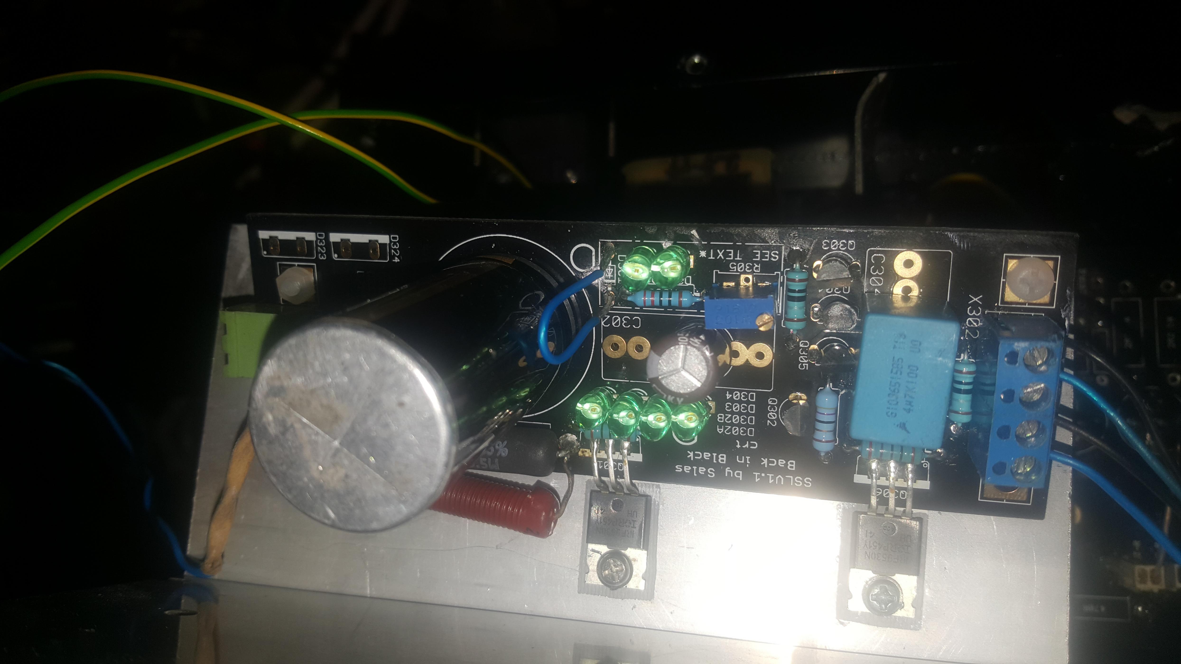

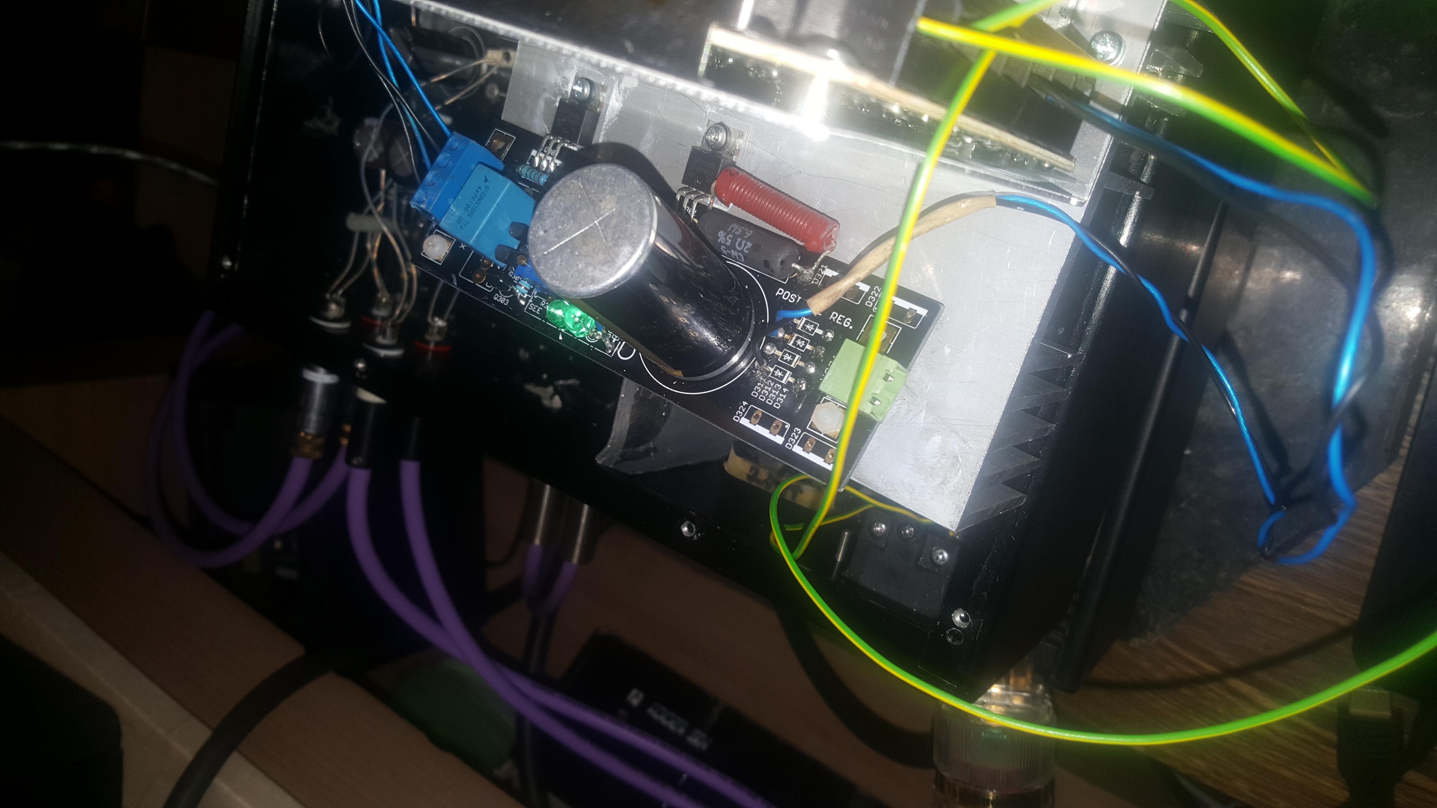

Hi Salas
I had managed to try the following with 5687 preamp series with 12.6v 900ma requirement. Feeding with a ac to dc smps 3a.
6x 1.7v led
1ohm 10w
2x irf9530
4.7 mkt zobel. 220uf 25v
2sk117 {non gr}
6800uf 63v
We tried various versions power supply.
OK it floored us.. Wow wow wow. The detail simply jump out of the speakers. Density clarity.
Just have a couple of issues. Firstly the temperature is very high. That I will use a better heat sink. But what else can you suggest. 2nd it lacks a little musicality and a little bright. Can you also suggest the ultimate mosfet for this function?

Nice to know that it proved highly successful to your goals.
First measure the voltage drop across your R301 1Ω 10W. Find what current level you actually run by I=V/R. Restrict it with higher R301 value by reverse calculation if there is too much spare current for your use so to drop some heat.
Try that Fairchild type I suggested to you earlier for the Q301 CCS position Mosfet which is faster than the IRF9530 you now use but it can hold better than the standard IRF9610 in your pushed situation, it may give you bit alternative subjective impressions to compare. Another thing that may affect tonality is bypass C301 with small 10nF-100nF film capacitor directly under with very short legs or compare with all the way C302 film cap alternative.
For extended practical discussions always use the builds thread which is the adequate one.
