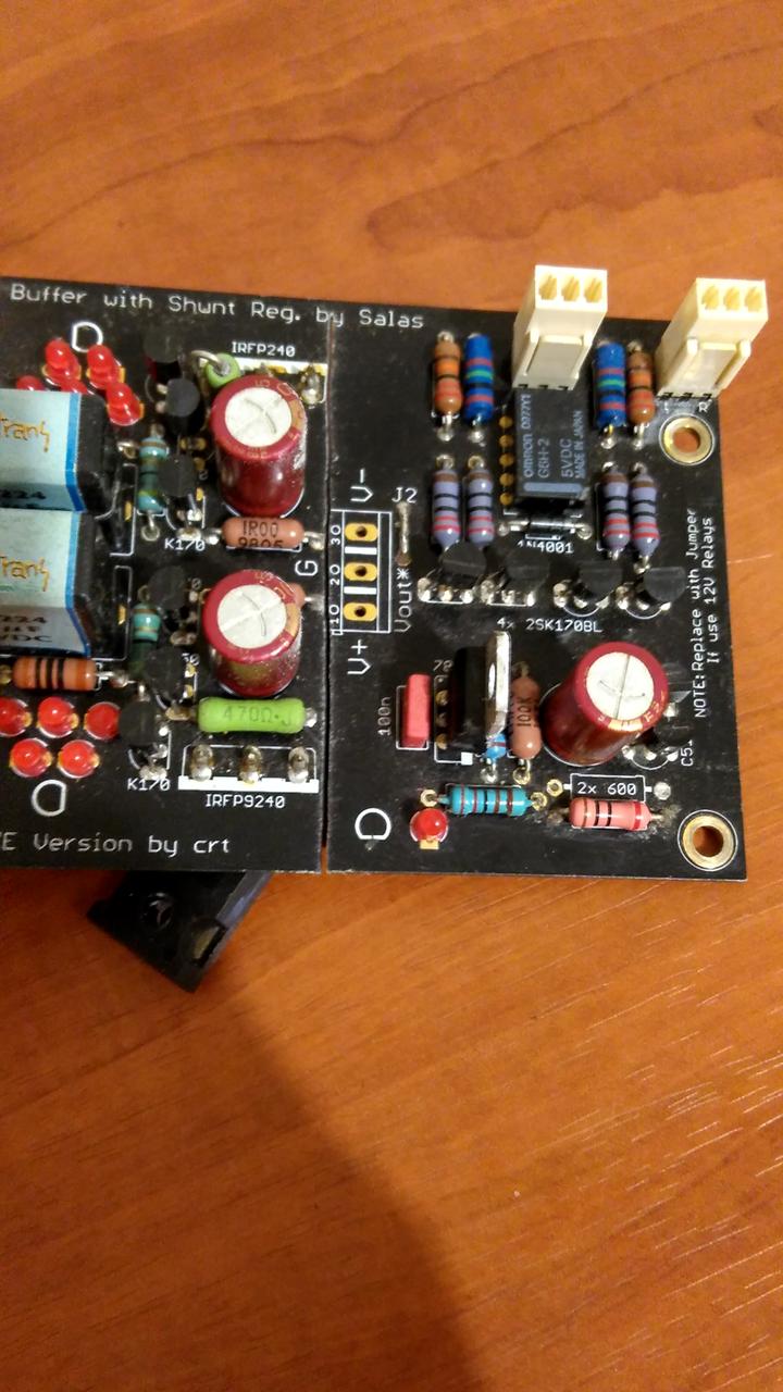

is there any extra board from GB? or anyone have any spare?
There should be a few extra. I will put you on the waiting list.

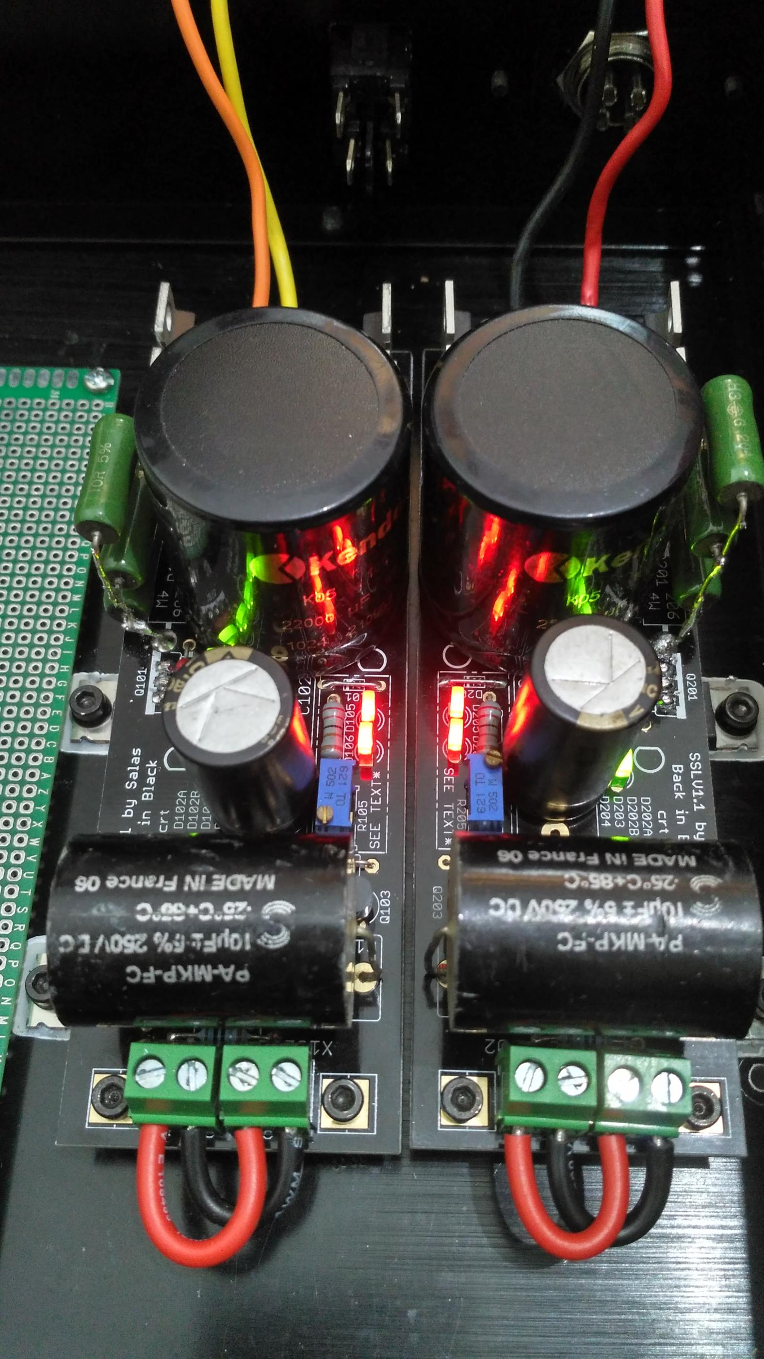

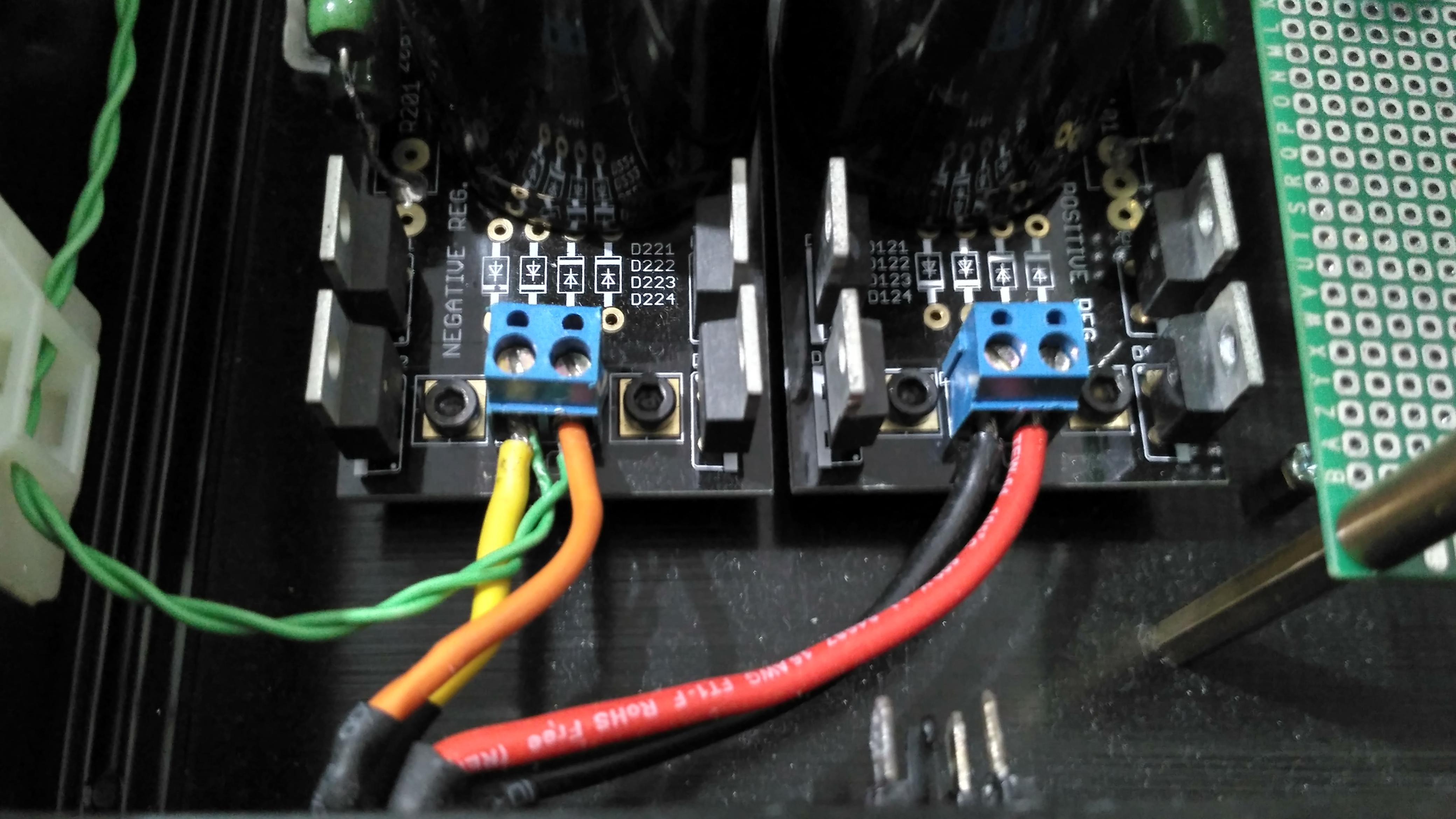

testing my bib, it's been running for 30minutes and leds are still working. this will be powering dcb1 xo.
using 2x15V toroid, my target output is 12Vdc. ccs use 2pcs 10R paralel, measured 2.3V on those resistor. chassis bottom plate only get warm, not hot.

You have been shorting the bib for half an hour with success and I also see a shortened length dcb1 pcb down at the front. What will be on those matrix boards? A Jfet active crossover maybe?
I did not have a good luck on original DCB1 board, somehow 1 rail always failed so I just cut it and use final output only and it had been powered by LT1085/1033 regulator for more than 1yr, now bib time 😀
those matrix board is 2way DCB1 active crossover for my OB speaker, will try 12dB first and add additional 12dB filter if required

I would like to power my regs with raw DC.
1- Should I populate the big PS capacitor or just a small film one for decoupling (like Reflektor D's DC-input) ?
2- For the negative regulator, where does the positive wire go ? Positive or negative capacitor pin ?

Regarding physical size cap for C105 and C205 position of SLV1.1, don't you think capacitor with 35mm diameter is too big for both positions?
C205 maximum diameter is 30mm, maybe you can use 35mm but it will sacrifice some space. I'm using kendeil 22.000uF 40V with 30mm diameter. No issue with this large cap bank
When you say sacrifice some space with cap size in 35mm diameter, what type of sacrifice do you referring to?
