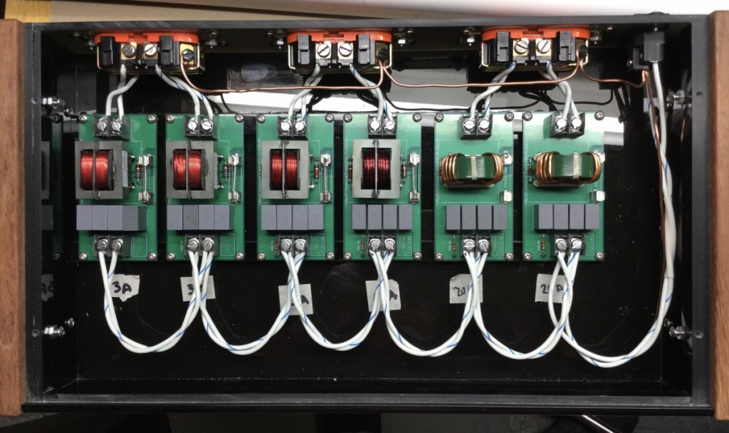

So from the IEC inlet the hot and null go to the first socket (the gold one). that socket is just a pass through
then the hot (L) and null (N) go from that socket to their own terminals and 6 wires from each terminal go to each fo felix module feeding them in parallel. the output of each board goes to one socket where the sockets bridges are broken off so that the top and bottom part of each socket are not connected.
there are 3 high current comoco Q4018, one mid current comoco Q4007, and 2 low current P3717
the empty space on the side is for a future DC blocker circuitry
now the grounding scheme: the gold colored plug's ground is the ground of the AC input coming from the wall but the 6 filtered outputs share the same ground which is not connected to the AC ground coming from the wall. right now the 6 outputs while sharing the same ground, really have a floating ground ie they are not connected to anything. i have no idea if this is recommended or not. what is the most optimal grounding scheme?
last question: the wire is very stiff 14awg . awful to work with. i have very soft 14awg speaker wire. is there any reason not to use that? I regret using this stiff wire and im worried that it will break the connectors

As for the grounding what if I connect all the output socket's ground to the chassis but not to the wall plug ground? the reason is that i have had a lot of issues with my electronics being noisy in this house so i was thinking maybe it would help to have all the electronics on an isolated ground plane
