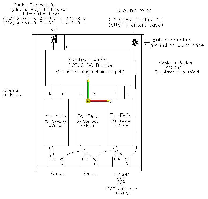

Would you guy's mind looking over my drawing since this is my first project using 120vac.
My questions are, is the ground connection okay, and is the floating shield okay after it enters the enclosure.
Also, is the breaker a good idea or overkill. I like the breaker as extra protection and as an on/off switch.
If you see any problems/mistakes please advise.
Thanks so much for any help.
What is the green and red lines?
Nothing, X/Y C/L of my cadcam software. Ignore them.
Question:
Would I want to connect the ground wire and the shield together at the bolt for case ground.
I ask because some of my power cords have the ground and shield connected together at both ends, some are just connected at the wall plug.
I've always wondered which way is best and what difference it makes.
I need to understand grounding scheme's better.

Leaving it floating is done so that whatever it attenuates will not have a path to the inside of the equipment.
In a 100% balanced stereo, the shield is better connected because then you don't have any gaps in shielding. In any stereo with SE interconnects, it is a way to potentially introduce noise.
